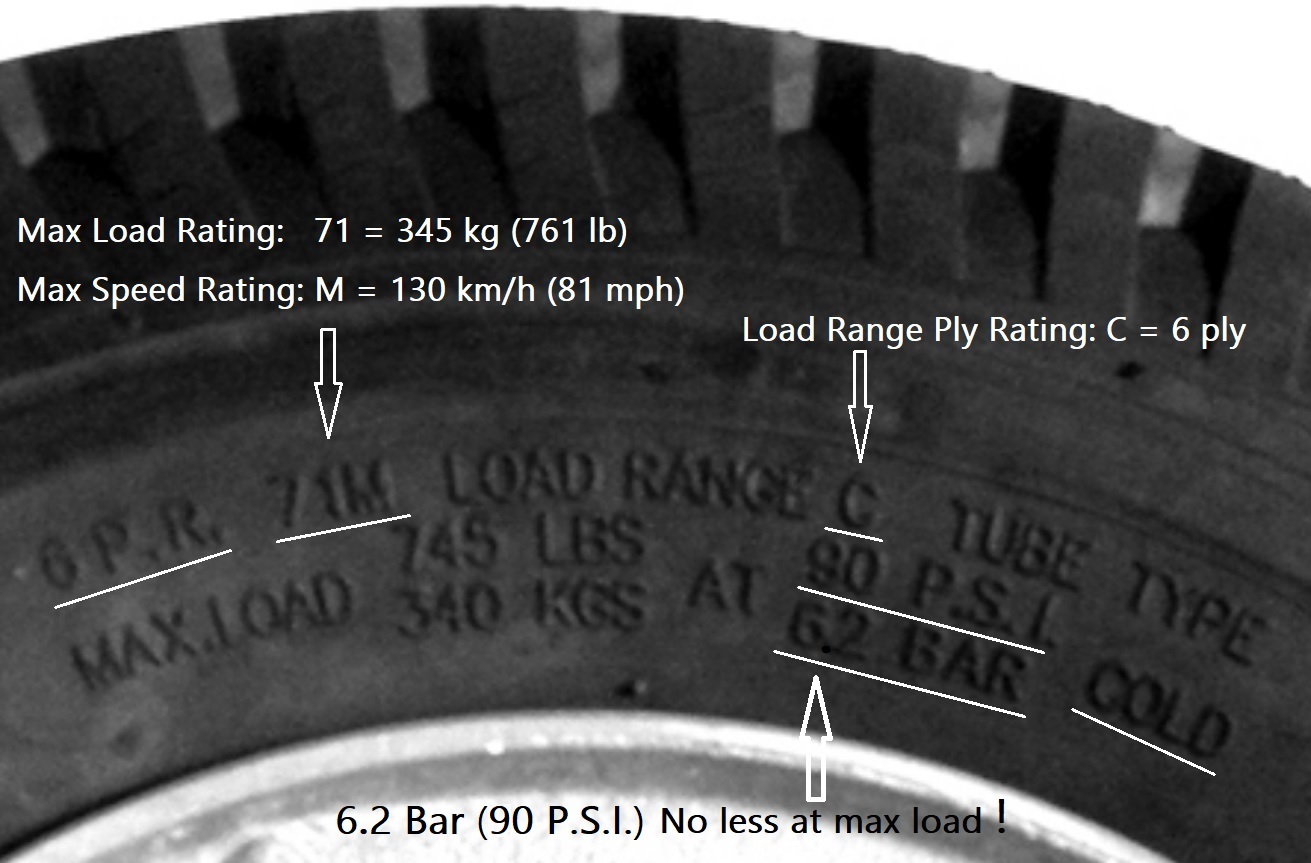

    Re post #47: Below some info put on the there shown tire. - ‘‘6 P.R.’’ - I don't know what that is, maybe someone else ? - Maybe ‘‘6 Ply Rating’’ ?

    Oh 6 PR = 6 plys making up the basis for the tyre, the lawn mower version only has 2 or 4 Plys, the heaviest duty 8 inch tyre I've seen was 8 ply.. for a bomb trolley.
    Yes always run those tiny tyres at full pressure or the casing may rotate on the wheel..

    Thanks, the 6 ply figure is also represented by the ‘‘C’’ on light truck and trailer tires.
    Wikipedia: Tire Code Load Range Ply Rating
    Load Range Code (represented Ply Rating) - A (2) - B (4) - C (6) - D (8) - E (10) - F (12) - G (14) - H (16) - J (18) - L (20) - M (22) - N (24) -
