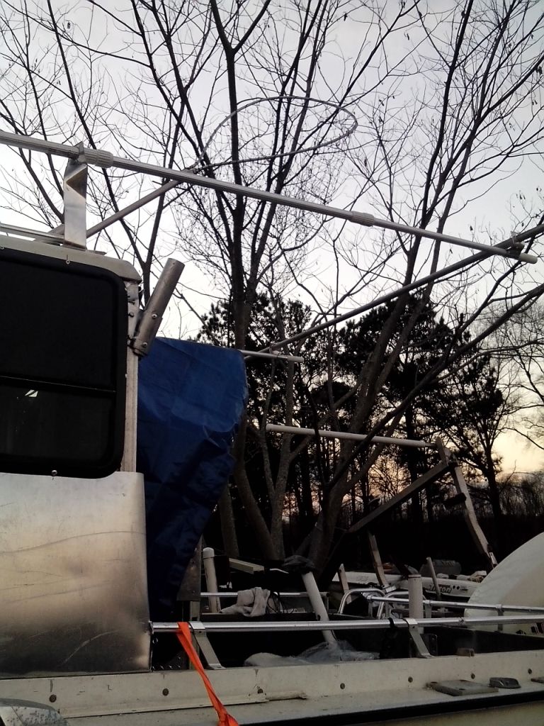

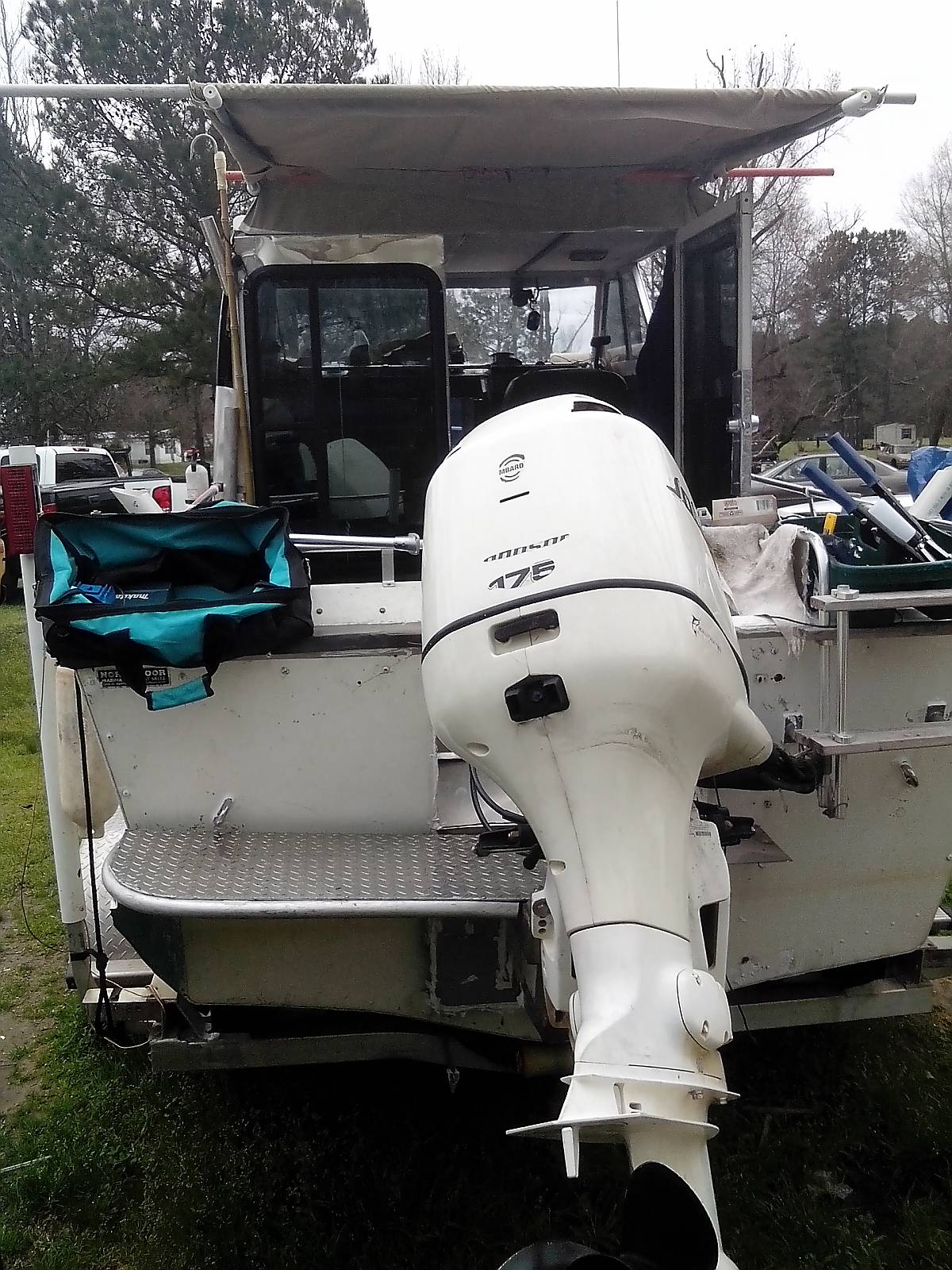

    Who likes my roof extension
    approshement diemensions are 80" width X 12" raised cection X 5' depth
    Toy’s are us pole cleaner poles
    Fabbed brackets
    Waterphroof fabric color olive green (a very lightish green)
    I'm currentely on phase 2 where I stabilize the uprights holding the telescoping pole w/ fabbed angle.
    I am very anxious to throw some marine fabric on this thing, I intend to add at minium a middle surport rod that clips in when roof is fulley extended.
    idealialley I like a crank mechanizium to extend and contract I have a old patio umbrella w/ a builtin mechanizium will have to check if it can be reused for my roof.
    edit OH BTW I slapped up a net/entey holder while I was slapping up the roof extension.
    I'm definitely slapping up a grabrail above door/wall probablley 1/2" aluimin tube.
    what do you Guys think

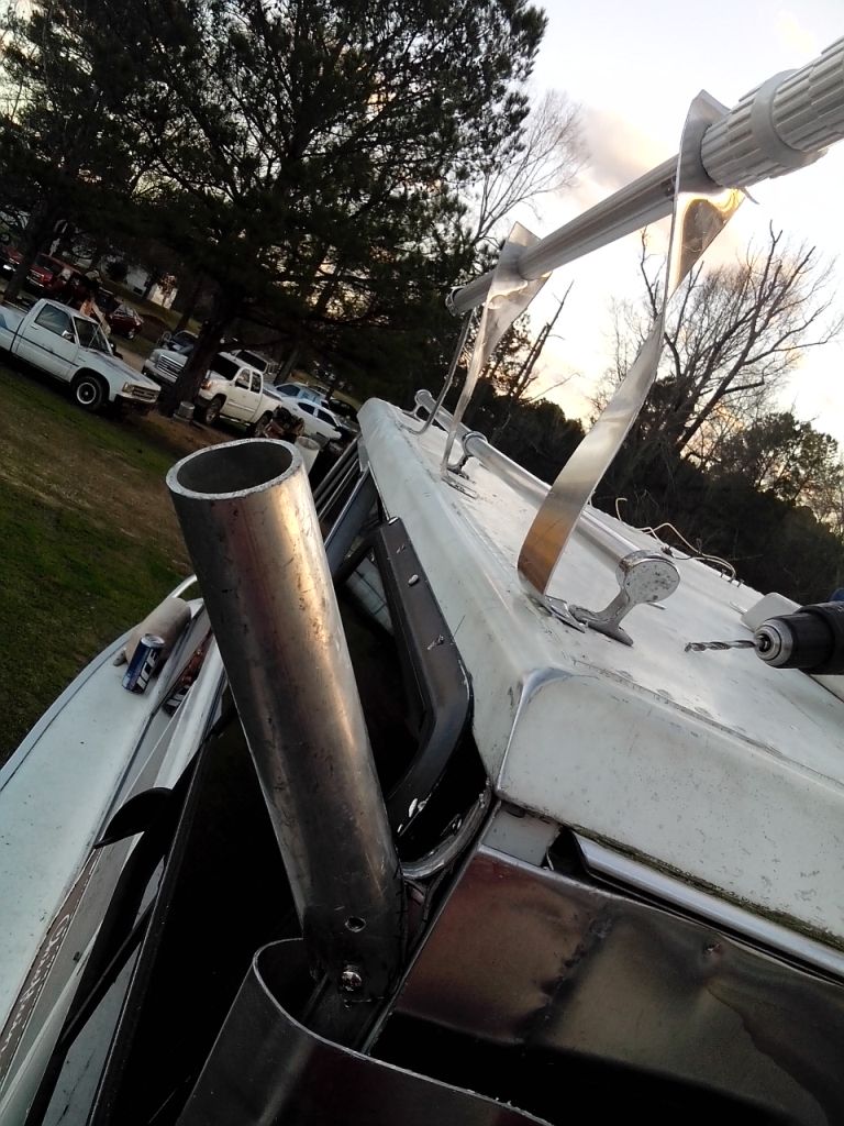

    Certainly looks functional.
    Though it appears that you've some sharp edges that could be a safty issue on a moving boat.
    [Captain Obvious] Light grinding before polishing with an emery cloth would solve that and may give them some shine too. For actual protective polish I don't know if Johnson Paste wax is suitable for use on the outside of a boat but it is great for shining/protecting the aluminum/cast iron of my powertools (like my Shopsmith, where it also helps lubricate the tubes the head slides on). [/Captain Obvious]
  4. JSL
    Joined: Nov 2012
    Posts: 810
    Likes: 61, Points: 28, Legacy Rep: 41
    Location: Delta BC
    JSL Senior Member
    - Yes, avoid sharp corners. 1" min radius
    - Watch the weight. and weight of anything (holders, mast, radar?, "stuff" etc)you add.
    - make sure there is adequate diagonal support aft. In a seaway any rolling will put torque loads on the top and can literally twist it off the windshield framework.

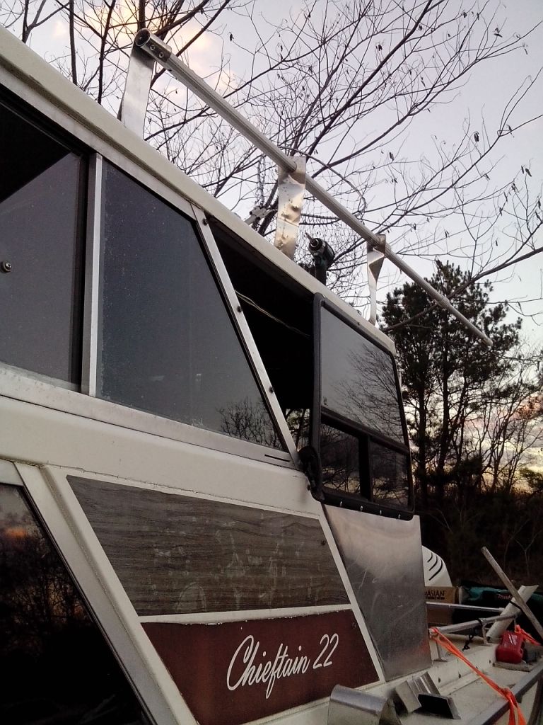

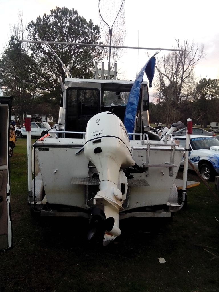

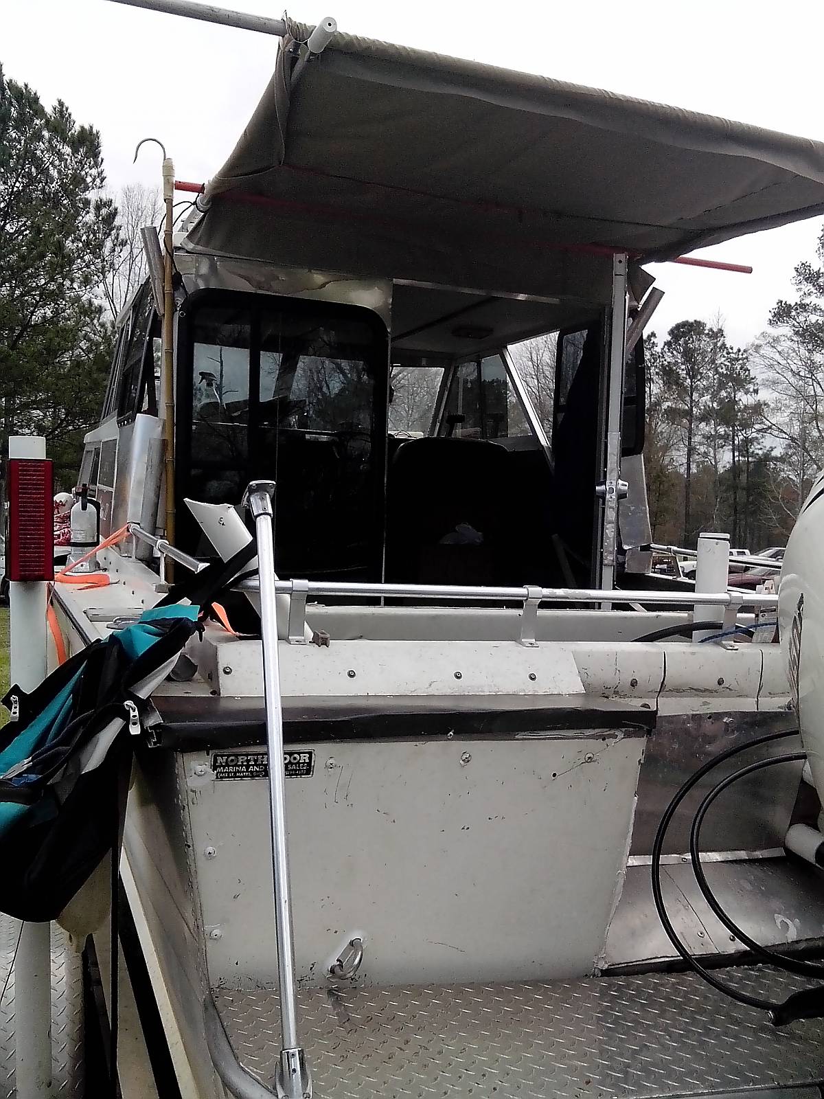

    update

    It may not be an issue but in the event you get any backdraft ["station wagon effect"]fit a CO detector. Especially if you plan to fit side curtains.
  7. the brain
    Joined: Sep 2016
    Posts: 360
    Location: AL
    the brain Senior Member
    yes I do plan to fit side curtains zippered under top, snapped to bottom, my next curtain will be the aft. w/ a 4'Wx3' H inzeiglass.
