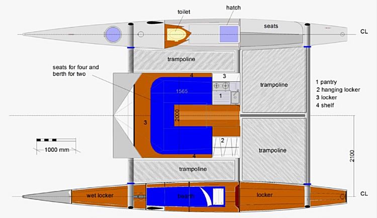

Hi all,
I thought I would give an update regarding the design selection process.
Since I began the search for a design that fits my needs, I have been corresponding with Ray, Rob, Bernd and Richard.
All have been very kind, and answered all my (multiple) questions in an informative way. I have also bought multiple study plans from them
and have been comparing those in depth. For the purpose of building the boat - I have obtained a permission to use a 9 meters long yard nearby,
which limits the length of the build to 9 meters, and unfortunately exempts the DUO1000 out of the possible build list.
Looking more in depth into the Bi-Plane extended KD860 Oryx and the "KD860 Open" designs, I thought a similar concept 9 meters long could suit my needs.

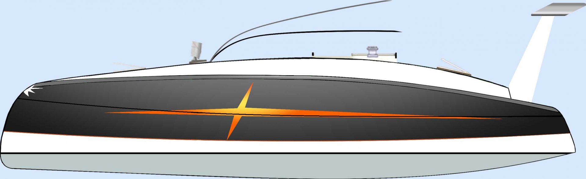

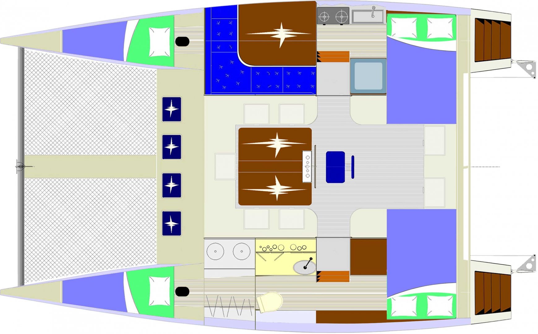

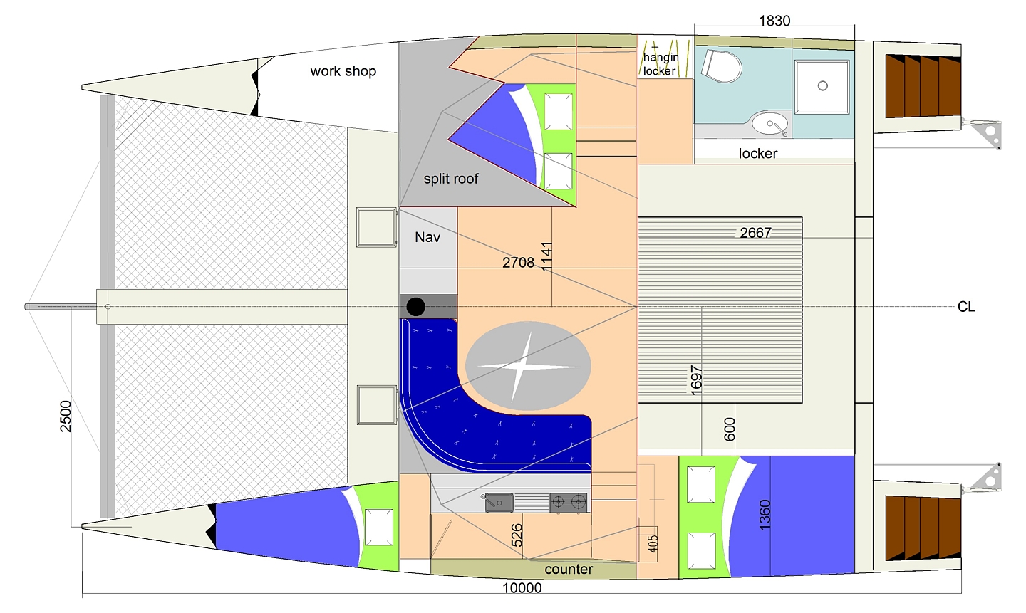

I began to make some sketches that I would like to share, together with my thoughts regarding this configuration.
The sketches are not completely to scale, and are based on a stretched to 9 meters "KD860 Open".
The helm is in the front of the saloon in a safe and protected from elements position, with good all-around visibility. All lines led to helm.
The access to the front deck is through a 60cm cockpit door making it safe and convenient to go to front, without the need to climb the hulls from outside.
The Bi-Plane rig clears the front of the boat, improves visibility and makes it a much better hanging out and working space during anchoring or docking.
Right of the helm is 2 meter "sofa", small NAV table and a table that converts to a bed.
There is enough space for a 120cm kitchen in the saloon, making cooking more sociable.
The Port side accommodates a twin bed positioned at a bridge deck level, and a full headroom shower with composting toilet.
The ship's only thru-hull and the water systems are on this side making it safe and easy to troubleshoot.
On the Starboard there is a twin bed, and storage/appliance room.
The stern has seating for 8 people and a platform for diving/dinghy. The Engine configuration is not final.
The composite lightweight Hard-Top spans all the living area and accommodates 3KW of solar panels and the mainsheets runners.
Because of the hard top, the Bi-Plane rig loses some sail area. I think I can live with the reduced performance.
I like the Bi-plane configuration, because it makes both building and sail handling easier, and lowers both the center of gravity and weight.
The hand-built carbon-fiberglass masts will be cheaper than a new aluminum mast, as well as the sails.
This picture is before the modification, to show the base design.
Any opinions or feedback are welcome.
Regards,
Eli.

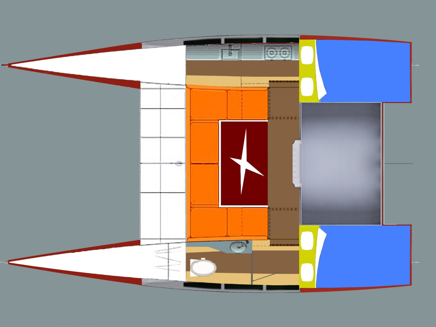

Hello everyone, this is a subject of great interest to me, as I'll be starting my 1st catamaran in September. And it will be a BK design.
The same thoughts as Eli led me to Striker/ Siren 8.4/ KD860Open.
Now that I'm living in France on the Mediterranean, I need to buy 4 or 5 catamarans that can be dismantled to start up a boating business again. The exorbitant price of berths means that catamarans have to be dismantled in September if they are to be profitable.
As the Striker and Siren are designed to be dismantled, I started by modifying the purchased plans for the Siren 8.4 into a 9m bi-plane on Freecad. In the end, I concluded that it would be wiser to modify the KD860open to a demountable version.
About the bulb shape of the Siren and the gain in volume. If you want to on the KD860, you can do that too. The KD860 Onix does it. BK's Pelican does it too. As BK explains so well, the volume gain must be done where it counts without touching the wet volume. It is possible to make it sexier (as in drawing 1) and to structure it as on the Siren with epoxy strips or on the DUO1000 in the underwater spine line with longitudinal plywood strips.
And the extra weight combined with working time will only be of interest to those who, like me, have a problem with the ratio of road transport length to habitable volume. Otherwise, it would be wiser to go for the KD1000/ DUO1000 / KD105, which will be lighter/more efficient/quicker to build/habitable.
I admire the 3 architects and study their ideas and designs carefully. But with each study I end up coming back to BK's concepts. The bi-plane is fantastic! His anti-vortex drifts are fantastic! Every time I think about improving one of his designs, I end up breaking my nose. And if I work on other designs, it's to make them look like BKs. So I'll be making modified BK boats to suit my needs, giving him all the credit and promoting his designs as much as possible.

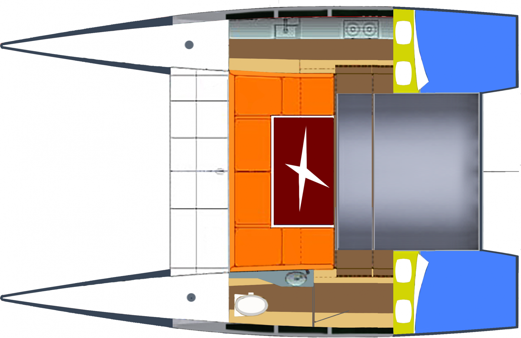

About your modifications ELI :
1st point: Passage on the front through the beam is not possible. BK designs light! VERY LIGHT! All its structures form an integral whole. Apart from the DUO800/900/KD105, since the early days with the Zeeman or P95, he seems to have remained faithful to his concept of an X-beam that cannot be touched. And even if the X structure is less obvious in his latest designs, it's still there. What makes his Open designs so resistant is the large cross-section of his central and rear beams, which he only makes lighter when he makes a roof. In these cases, the roof and floor form a complex 3-dimensional X-cell with the outer faces of the hulls. On the other hand, you can have a passage in the roof of the square adjoining the beam with a simple porthole. However, with a bi-plane you have no need to go forward in bad weather. Even a floating anchor on the bow can be dropped from the stern if you have prepared lines under the saloon beforehand.
2nd point: The integral hard top would be like making a KD860. With the disadvantage of making it heavier on an open boat and the risk of doing it badly. Possibly, consider a canvas hard top that would close the hulls and be removable. In the low position (in black on drawing 1) your sails will work as on the original plan and at anchor you will have headroom (in grey in the high position). The advantage of the shelter in bad weather and the advantage of ventilation and panoramic views in good weather. You can also create a head passage in this hard top for a central helm station, which will be more comfortable and closer to your winches, as shown in drawing 2.
Drawing 2 is a delusion of a KD860 pushed to 9.2m x 6 wide. Is it realistic to spend a weekend with 10 people on it? Absolutely not! The extra weight generated by the modifications and 10 people on board would make it unsafe to sail. That was to give me some ideas.

Hi lolo,
Thank you for your remarks and the insights. They are correct, and very in place.
It gives some place for thought.
I think, what might make the difference is the intended purpose:
You need 4-5 yachts for boating business - They have to be very safe and with a great stability margin, to accommodate
large random crews for weekends and/or chartering. The open cockpit makes a great socialization place, while fabric roof enclosure
gives a lightweight sun and rain protection. Light weight construction makes it fast and safe, provisioned lightly -
you might even manage carrying up to 10 people onboard in good weather. You have also added single bunks in front of Bi-Rig.
Overall, your pictured concept above looks very nice for the intended purpose.
My concept is slightly different - this is a family boat for weekend sailing, that is all climate/weather cruising capable with 3-4 PAX.
Solar is important for water production, propulsion, lighting, Navionics, climate control etc.., as well as a proper insulation and bridge deck pilothouse
hosting the helm and the saloon for inclement weather protection. Hence for me the roof is an essential core part of the design. Carbon and light
weight construction elements will be used in the roof and saloon to save weight. The remark regarding the center beam is correct. some issues might be remedied by adding carbon for strength,
maybe adding stairs in saloon before the beam together with an opening in the roof will preserve center beam integrity and will allow for center passage to bow - the center passage adds safety
and ease of bow access in all sea states.
The constraints of available building space that allow me to build long but only narrow hulls, unfortunately dictate much of the changes. Otherwise, I would build the DUO 1000.
The intention is not to "force" KD860 OPEN into 9M but rather pay Bernd to design a custom boat that will fit my needs.
I did the basic calculations of the expected loaded weight vs design displacement, and on paper it might work. That being said, I did not talk to Bernd yet since I was finishing the design,
and he might provide some valuable input and insights.
The transverse rear bunks is something I did not think about and is a nice way to add space inside hulls.
Thanks again for your input,
Eli.

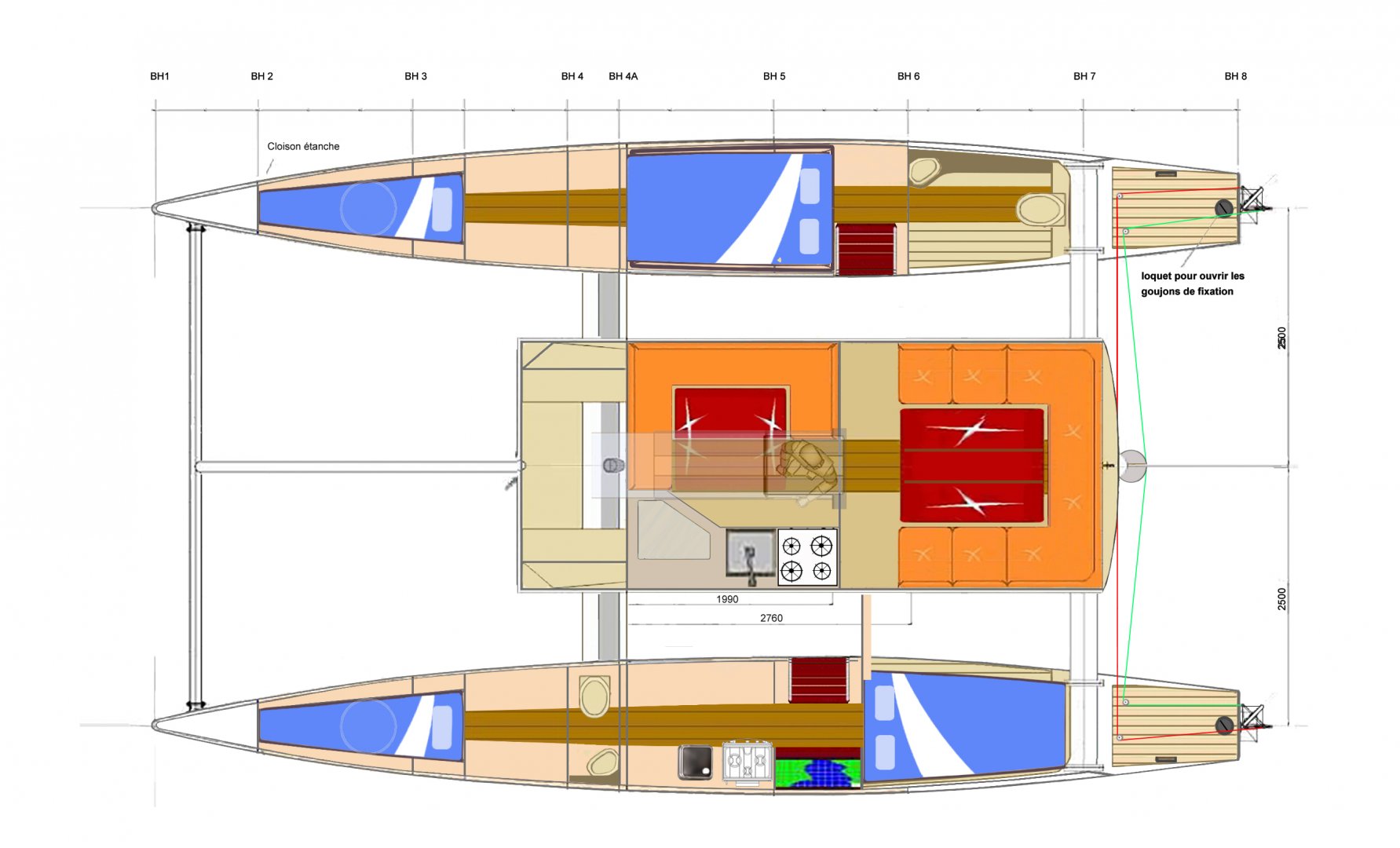

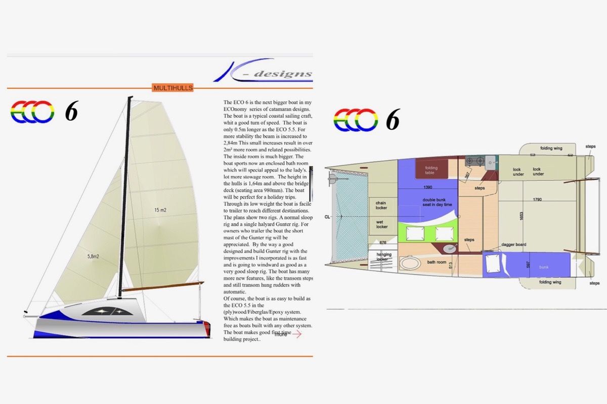

Good evening, Eli.
Sorry about my writing.
Like all bad Frenchmen, I'm going by the computer translation, which reflects my thoughts badly.
My previous plan was just to illustrate the fact that it's possible to design an 8 or 9 metre boat with 8 or 10 berths, but that it's ridiculous to think that it's usable.
On the contrary, the catamarans I'm going to make are exactly in the spirit of the tient.
In my experience, under 44'' and with a minimum of 2 WCs, it's unrealistic to plan for more than 6 berths. In the Seychelles where I worked, we had 4 couples + skipper + coock for a week's cruising on 44'' with 4xSDB. By spending the days ashore cruising in an enchanting setting, the week went well. If the rain got in the way of the cruise, it could turn into a nightmare. Same scenario on 47'' with 10 customers + 2 crews.
For the 14-day fishing trips to remote islands, we went out with 10 people on 47'', which was often very hot on a human level. For 12 people, you need a minimum of 16.5m, as BK had prescribed in a charter boat plan he had designed. Around 4 people between 7 and 8m and 6 people from 9m. So your wish of 4pax on 9m is, as I think, very realistic.
Personally, I'm going to start with an ECO750 that I'm pushing to 8.1m, ideal for 2 adults and 2 children. Same bi-plane sail as on the DUO800 and AntiVortex. BK advises against using them on multi-spine hulls, but he designed it for a customer and the performance was there, much to his surprise. It can be dismantled into two sections less than 2.5m wide for transport over a few kilometres. This will be a trial run to master amateur construction and validate the mechanical strength of my ideas for dismantling in heavy weather. The Mediterranean is generous in terms of extreme violence, so it will be very easy for me to test my ideas. Then I'll be making a KD860 open in 3 dismountable sections for 4 people and DUO1000s for 6, also in 3 sections.
The only point where we differ is the galley. On these sizes of catamaran I'm in favour of positioning them in the hulls. More space, more stable and the fridge can be integrated into the hull.
Your concept for dealing with any situation is no different from those designed for ocean cruising or circumnavigation. Especially if you're talking about solar power to manage water production.
I'm working with the same ideas, because who can do more can do less. I wanted to stay under 400kg of equipment all told.
Electricity/electronics/hot water/solar/oven/fridge/freezer/pilot/electric WC with black water tank/water heater/motors... are the items that required the most thought and work for me.
I thought it was doomed to failure but in the end it's largely possible by opting for counter-intuitive/forgotten/anti-commercial solutions.
What are your thoughts on the subject?
Laurent

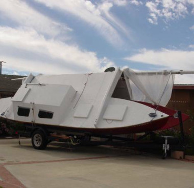

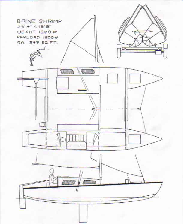

Since we've strayed into designs without the bridge deck cabin that the OP requested, I'll mention again Brine Shrimp and Dandy II (links in headers below) by the late Thomas Firth Jones. They represent affordable ocean-crossing capability with Brine Shrimp being smaller but hinged for relatively easy seasonal trailering and Dandy II offering at lot more cabin space. Despite the Spartan accomodations, I think Brine Shrimp would make an excellent affordable cruiser for a couple with small kids.
Brine Shrimp
Brine Shrimp Catamaran https://www.boatdesign.net/threads/brine-shrimp-catamaran.58948/
Proa File | Trailerable Brine Shrimp in California https://proafile.com/multihull-boats/article/trailerable-brine-shrimp-in-california

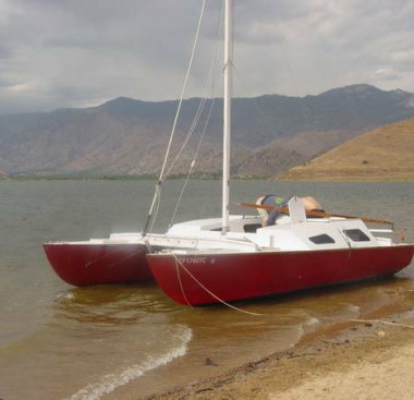

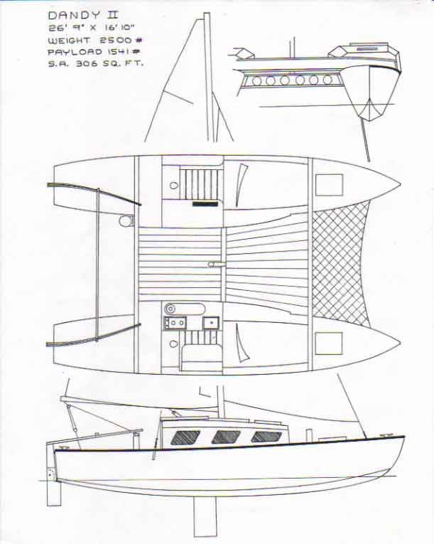

Dandy II
Note that the original Dandy was well-proven but had a biplane rig which Jones eventually soured on. Dandy II returned to a straightforward stayed sloop rig.
