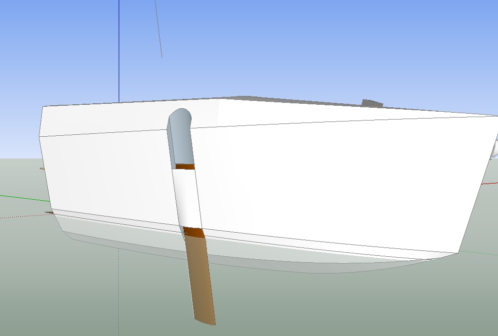

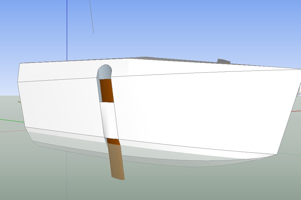

    Trying to add daggerboards to the 34 foot catamaran design.
    Can't put them on the inboard hull side as that is where the beds are.
    Can't put them vertical in the hull as the Hoyt booms run close to hull tops, takes up internal space, and the boards become too long.
    Don't want to use one central board from the bridgedeck as design loads are high.
    This partial outboard recess seems to the best but of course there is the free surface effect.
    How much additional board length is needed to offset the free surface effect? Just one width (approx 40cm), less, or more?

    If the enclosure is open to the sea, there is no effect due to free surfaces.

    Difficult to see but the opening is 12 cm above DWL.
    It could be set under but marine growth would be a problem. :confused:

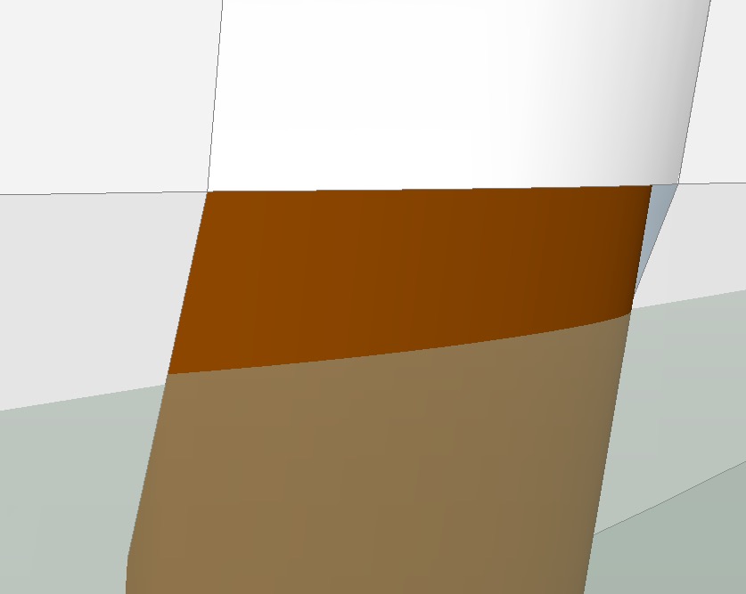

    Sorry, could be my misunderstanding. Here is close up of the water surface.
    Normally the daggerboard exits the hull under the water surface and if the case exit is a tight fit around the board there is no air entrainment (which I understand would cause some loss of foil efficiency.
    This arrangement shown would seem to permit air entrainment. If it is a minor problem that's good to hear.

    It seems to me that you are not talking about what is normally understood as the effect of free surfaces, for example on tanks, which produce a decrease in stability. It seems to me that you are talking about something other than me, I am sorry, I do not understand. Excuse my intrusion.

    No problem, thanks for the replies. I am not sure what to call the effect. Free surface effect was what came to mind.
    I have seen videos of foils suffering ventilation to some depth when the foil is surface piercing - i.e. not sealed by the hull. But the angles of attack were high as were the speeds apparently.

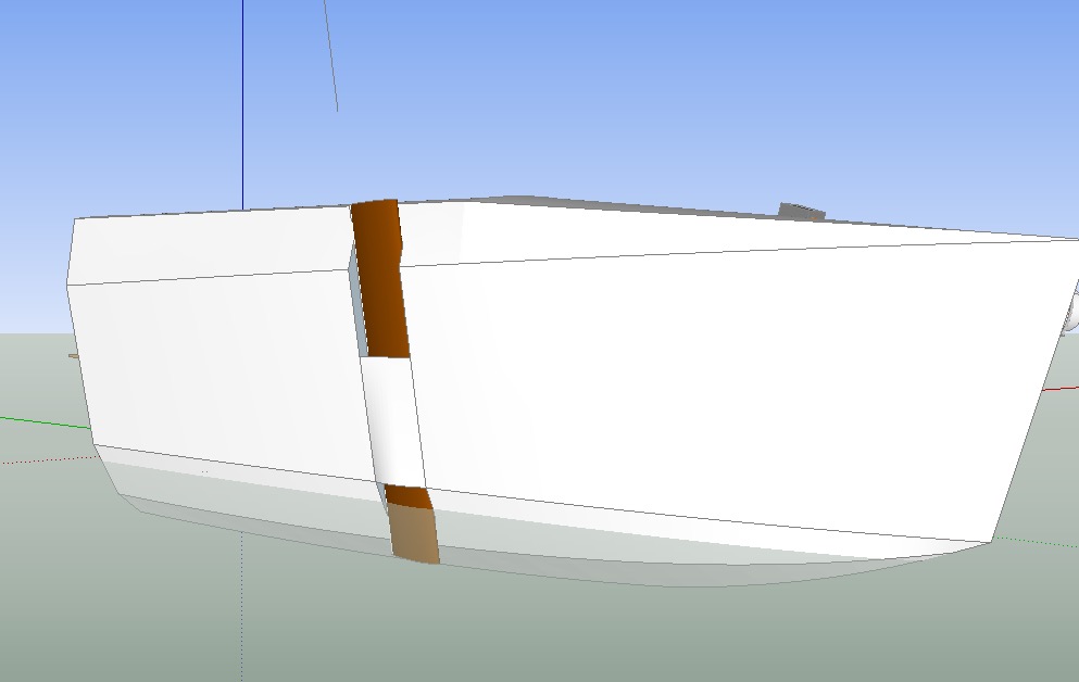

    Why can't you fully incase the board with a traditional slot (obviously angled) on the garboard or bottom panels?

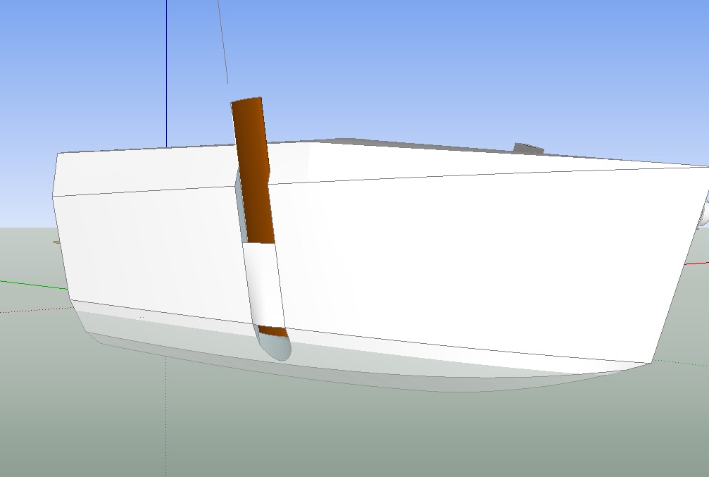

    If the board is angled sufficiently to emerge from the hull underwater then either the upper end is too far outboard for comfort when the board is lifted OR if the board is more traditional and vertical it becomes too long etc.
    I suppose the boards could be removed completely in port which would eliminate the outboard lean problem.
    Having the upper end of boards half way down the outer hulls (when in use) is not exactly service friendly however :confused:

    Maybe look at putting a constant radius curve in the board to allow a snugger fit against the hull side, also, you are looking at the hull in a static unhealed mode, when underway it may be heeled enough to cover your slot.
