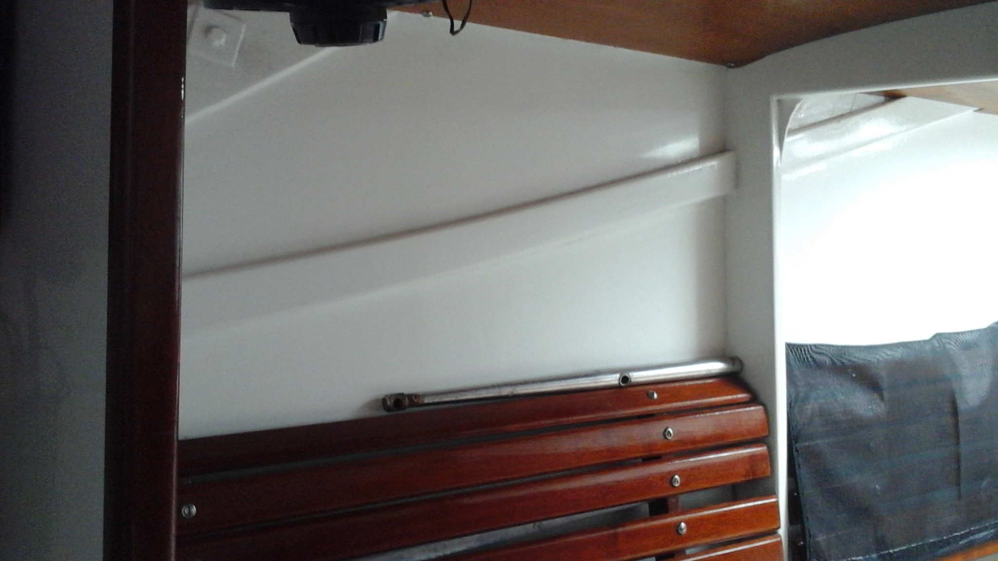

    Okay here we go.
    I think you are fine with the connective strength and basic beam structure. My only question is the 1" wide fore and aft vertical members, are they solid or 2 ply skins with some internal framing/truss? Looking for nail patterns might give a clue. In any case keep an eye on things, wood lets you know.
    Some of the beam elements remind me of Norm Cross' R series racers, it is possible the builder/hot rodder borrowed a page from that book.
    The ama ring frames connected to the beams are the right size. If you want to be extra careful lay glass biaxial strips set in epoxy connecting the frame to the skin between the stringers. If you don't watch for signs of the glue joint failing from hull panting etc....
    I would reinforce the 1/4" ring frames at least on the outboard side. I prefer timber over glass for a number of old school reason. As Phil pointed our if you glue in pieces the same size as the stringers you won't have to mess with notches. For a cedar use 3/4" to 1/2" for a mahogany/ fir 1/2" to 3/8". These just have to be 3-4" wide to the edge of the ring frame cut out.
    How well is the cabin tied on? The stock ones have posts running down to the underwing level connected to beams on the outboard side and into those timbers connecting the mainhull to the beams. This keeps them from getting knocked off by a breaking wave. Do those windows allow a corner post? Things to ponder.
    I'm attaching one of your pictures of the inside forward. It shows the underwing gunnel (inwale) curving up. These are put in before planking, this is the style you'd find on a Cavalier so I'm sticking to that. The Wanderers I've seen are done differently with a angled flat forward edge.
    From the other photos it looks like the forward beam may be set back from this and there appears to be a added underwing curve behind it in the photo? Take a look and let us know. This is one of the elements along with the bunk and storage structure and cut down cabin posts that makes me think the open or vent wing was a later conversion. The amas also have the stock underwing lower gunnel.
    A picture of the tops of the 1/4" ama ring frames would be helpful here as on one side or the other there would most likely be remains of the conventional Nicol wing beams which ran across the tops of them all the way to the outboard ama side.
    Some of the beam elements seem newer to me, what I think is dark preservative gives everything a uniform look so it is harder to tell.
    Can you take a picture of the chainplate timbers inside the ama? The aft one reminds me of the ketch set up though I suppose you are using it for a running backstay. Another conversion thought...
    As mentioned a pulpit on the pointy end would be nice.
