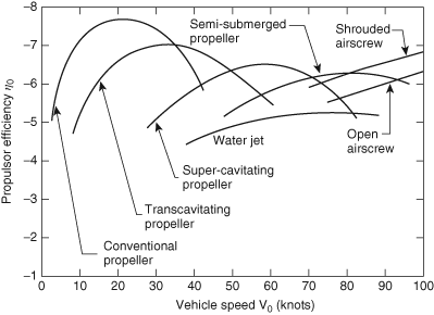

    In one way yes, in one way no. The truth is buried in this chart from High Speed Craft by Keuning & Ligtelijn; note that this is etaO (i.e. EHP/SHP) for installed systems which becomes important.
    Destriero and US5080032A notwithstanding, the conventional propeller is most efficient up the mid 30 knots. Additionally, if you need less that 5,000-6,000 SHP, etaO can be significantly higher, so while that single screw 100,000 SHP LSD may have a etaO of 0.73 turning a huge B 5-95, a small launch could achieve 0.90 with a B 2-30, and specialist HPV's propellers even better. So why don't LSDs use B 2-30's? What limits propellers is bending moment to material strength and cavitation losses, so while that CVN is going significantly faster than the 100,000 SHP LSD, it's 250,000 SHP is spread over 4 props. This is necessary to prevent the props from failing. As we move through the props and speed, cavitation losses and the methods to handle cavitation change. From transcavitating to super-cavitating to surface piercing, the EHP, installed SHP, and propellers keep getting smaller and smaller until we get to ~120 knot Unlimited Hydroplanes mostly flying with a 3000 SHP GT and an 11 inch 2-bladed chopper prop. While I think the water jet curve above represents real, but un-optimized installs, jets suffer the same effects as propellers as specific speed increases. Only by good manipulation of the pressure throughout the unit can a water jet hope to approach an open water propeller etaO. However, the water jet impeller has two advantages over an open water prop, first by manipulation of the inlet it can increase the pressure at the disk to prevent cavitation onset, and second the tube can support the blade tips reducing the blade bending. The first means I can have faster flow into the impeller before the onset of cavitation drags down efficiency, the second means I can add more power and/or have a larger disk. In all this means that while etaO may be slightly lower at speeds above ~40 knots I can throw more SHP at it and therefore have a large EHP and therefore a larger vessel.

    Sic! Two additional observations regarding the KaMeWa diagram:
    A/ The hull is stepped (?), which should make for less BL flow in the jet inlet region. The jet suffers but the hull resistance is reduced; "what you loose on the swings, you gain on the carousel".
    B/ The remarkably good performance in the 30 to 40 -knot region indicates that the jet layout is optimized for a slightly lower speed range than pure top speed. Again it is important to see to the full operating range, even in a "racer".
