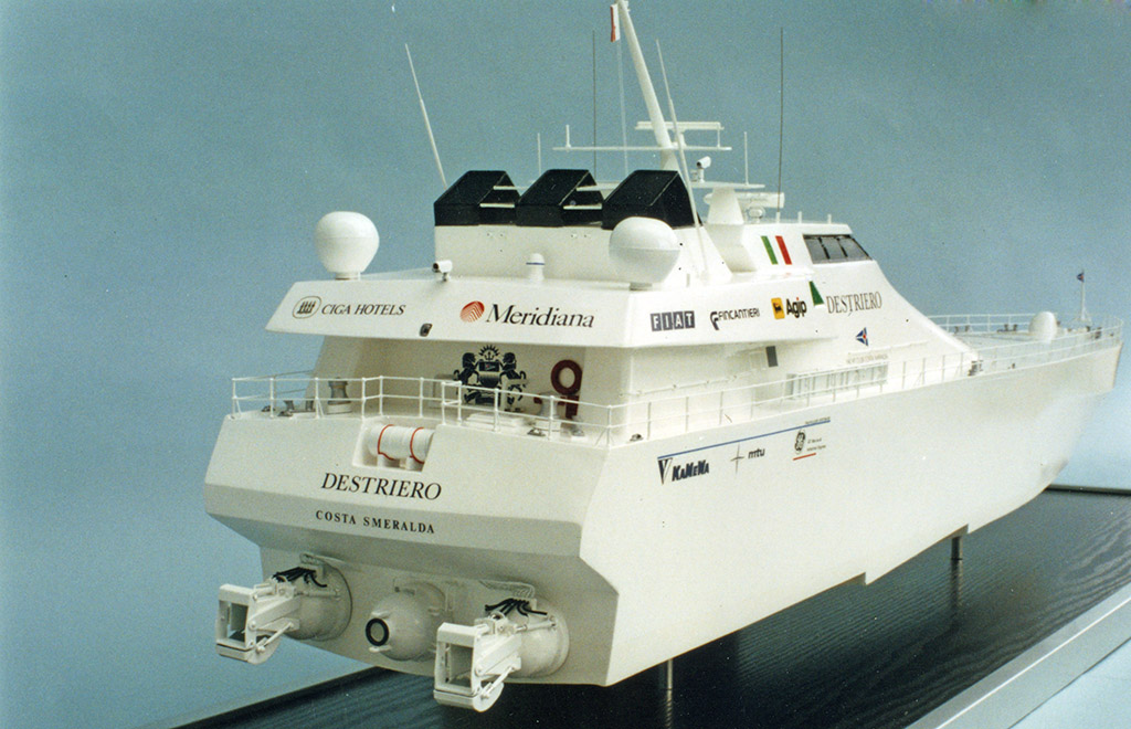

    I don’t think she has a stepped hull!
  2. DogCavalry
    Joined: Sep 2019
    Posts: 1,299
    Likes: 711, Points: 113
    Location: Vancouver bc
    DogCavalry I aim to misbehave.
    Looks like it in this image. Don't know for sure.

    Olav, any guesses why waterjets?
  5. KeithO
    Joined: Jul 2019
    Posts: 307
    Likes: 58, Points: 28
    Location: Michigan
    KeithO Senior Member
    Guessing:
    1) Elimination of the transmissions weight
    2) Elimination of the appendage drag at high speed which is a big factor at the top end
    3) At higher speed its possible that the impeller may be more efficient than a prop since impeller to housing clearance can be tightly controlled.
    Steering when coasting would be "interesting", given all the momentum...
  6. BlueBell
    Joined: May 2017
    Posts: 1,613
    Likes: 420, Points: 83
    Location: Victoria BC Canada
    BlueBell "Whatever..."
    I've captained a 3000HP 47 passenger jet boat. Hamilton 42 jets.
    I see your point.
    Differential thrust for steering in the "momentum" phase?
  7. DogCavalry
    Joined: Sep 2019
    Posts: 1,299
    The only apples to apples comparison I've managed to find had identical hulls of the same power, one with i/o, the othrr with jets. The i/o was 15% faster, with proportionally better mileage.
  8. DCockey
    Joined: Oct 2009
    Posts: 4,936
    Location: Midcoast Maine
    DCockey Senior Member
    Waterjets are commonly used on large, high speed vessels. For example both the US Navy Freedom class and Independence class litoral combat craft have waterjet propulsion.
    From Performance by Design, Donald L. Blount (design manager for Destriero), p 153:
    Flush-inlet waterjets have made significant inroads at the preferred propulsors for craft requiring operational speeds of greater than 25 knots. Considering overall propulsive efficiency, they offer a distinct advantage at higher speeds.
    In addition, requirements for reduced vibration and navigational draft often support the decision to select waterjets in favor of other propulsors. The combination of gas turbines driving waterjets is particularly well matched for large vessels requiring high power levels. Both are free-turbine fluid machines with power characteristics proportional to rpm cubed. Thus overload/offload boat conditions are readily accomodated by this combination of propulsion machinery.

    Be careful here what you call a "stepped hull" and a 'stepped hydroplane". The hull form is very different and, while both are to increase speed, they are done by different methods for different reasons. Multiple stepped hulls make their appearance in the early 1910's Gold Cup racers and are used to reduce drag by aerating the flow next to the hull (and realistically you could say sea sled functions in a similar way). 3 point stepped hydroplanes, which appear just pre-WWII as small outboard boats and bloom post-WWII with high power to weight aircraft engines, are fully supported on small patches of solid water. Multi-stepped hulls begin to disappear in the mid 1930s because of prop aeration issues and as the need for sustained speed in a seaway moves most small military patrol craft to polyconic and V-hulls, however there has be a slight resurgence in the concept married to a V-hull in recent years. Handling of both types in a seaway can be an issue.
    There is very little to chose from between the weight of trans-shaft-prop and the weight of a waterjet at those DHP levels. And a well designed impellers are always less efficient than a well designed propeller...except when the prop comes out of the water or cavitates by being to close to the surface for its diameter/power. Modern small all-weather combatants usually select jets because of reduced draft and better functioning in rough water/short steep seaways at speed.
