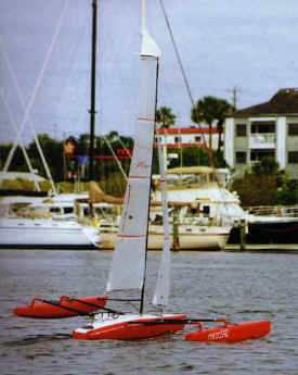

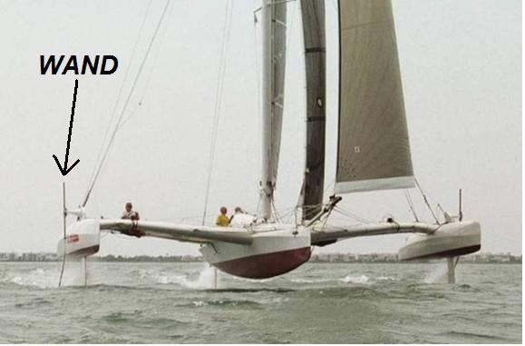

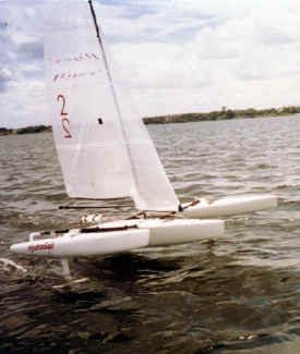

    Dr. Sam, the Flyer Cubed and the foils for SKAT
    Dr. Sam Bradfield and I were friends and he was quite an inspiration to me. No more so than when he ordered one of my large Flyer Cubed trimarans to use to test the foil system for the 40' SKAT. Amazingly, the foils used on the model scaled up directly with no mods made due to "scale effect" or any other effect. The foil sections were a bit different.
    I designed,built the tooling and built two Flyers and took them over to demonstrate for Dr. Sam. He bought one that day!
    Pictures, L to R: 1) 40' SKAT, 2) Flyers one and two sitting at Sams place. You can see him in the upper left corner and get an idea how big these RC boats were, 3) Flyer Cubed #2 flying with Dr. Sams SKAT foil system,3) #1 sailing in his little basin at Melbourne, Florida.

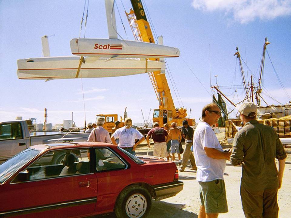

    We nee such folks, pre-thinkers, risk takers, pioneers indeed. But not these crazy ones. Sam's boat worked very well. There is no doubt about. It doesnt look "too old fashion" as these two pics show the under water ship during the launch and taking off for the Miami to Nassau Race.
    I'd prefer to sail this Scat 37ft instead of any other Trimaran in that size. It is just the way as it has to go into the future. A logically consequence.
    I have organized yesterday a profiler in USA to research about where the boat is now. The US Navy bought only the hull without mast/sails. They wanted design a motorized "drone". - Lets see what happened with... I am waiting to get more details and will report.
