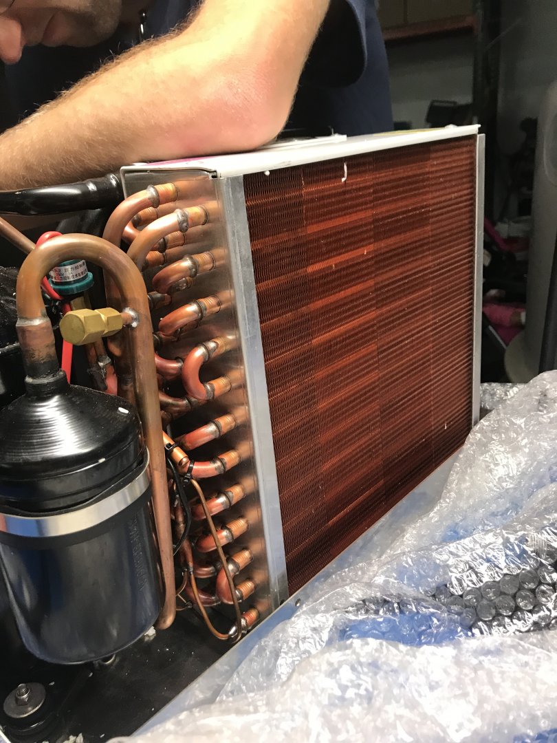

    Efficiency: to create an efficient unit long lasting anti-mold/ bacteria Copper Fins and copper tubes, size of the tubes, compressor, size of the condenser to minimize the water flow and avoid calcium buildup, control digital time delay, auto mode fan, high static blower pressure.

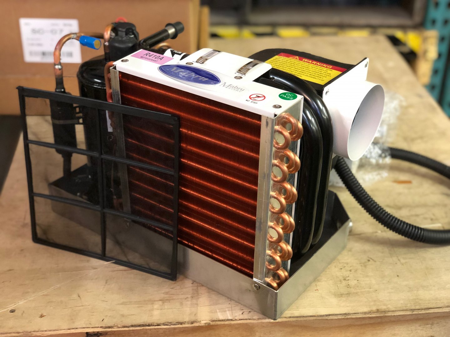

  4. Mabruteam
    Joined: Feb 2011
    Posts: 11
    Likes: 0, Points: 1, Legacy Rep: -8
    Location: Florida
    Mabruteam Mabru power system

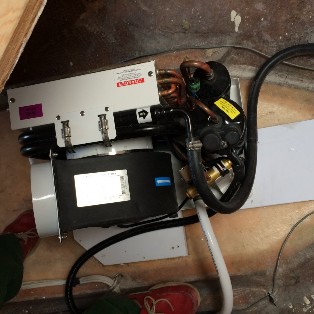

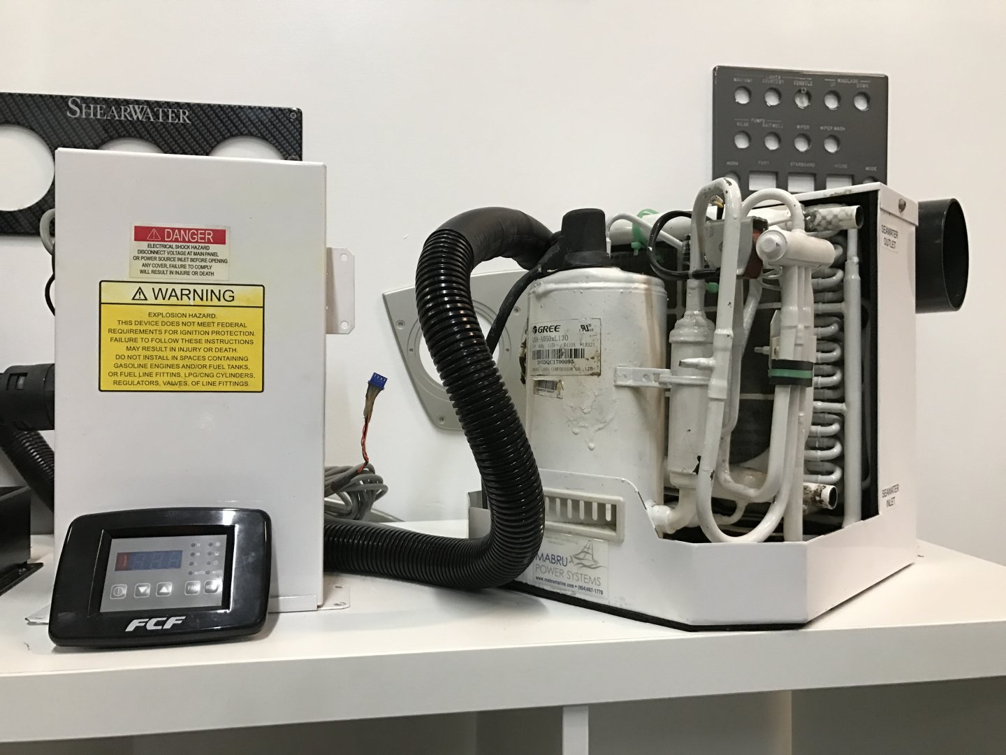

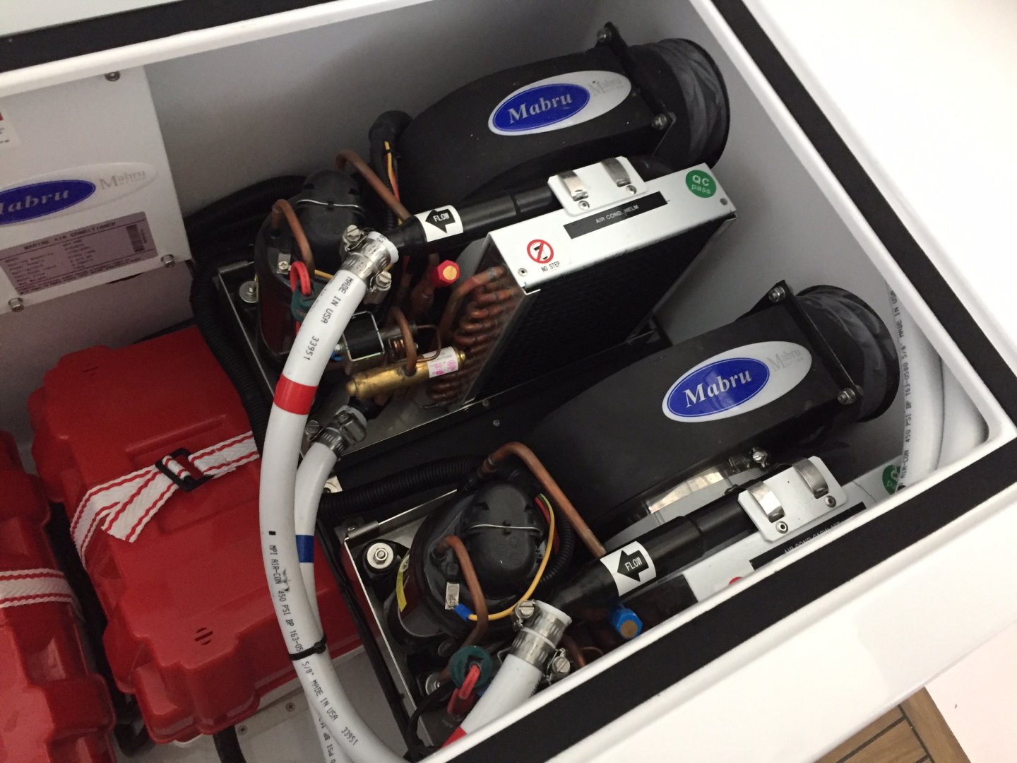

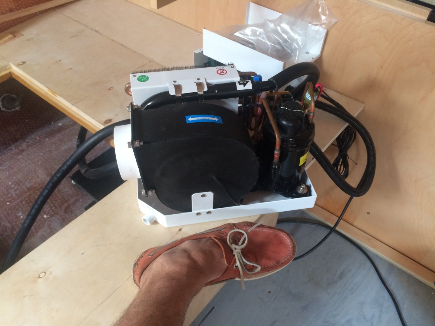

    Few Images of Self contained units.. most are efficient, quiet, but not all are equipped with anti-micrbial copper coils, nor B30 CuNi raw water cool coils.

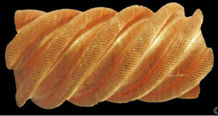

    Very few carry copper coils with antimicrobial copper fins, this advantage also brings a better efficiency, no electrolysis between dissimilar metals, last longer. the water cool coil made out of Titanium, CuNi B10, CuNi B30.. after testing all of them for over 40 years the best that was proven over the years with Cruisair made in Richmond VA was the B30 70:30 CuNi, we see Hatteras form the 70s with turbo tech coils still doing going, the B10 is just plain garbage, and titanium welding in my opinion is not compatible with the rest of the unit, leaks are often reported after few years.
