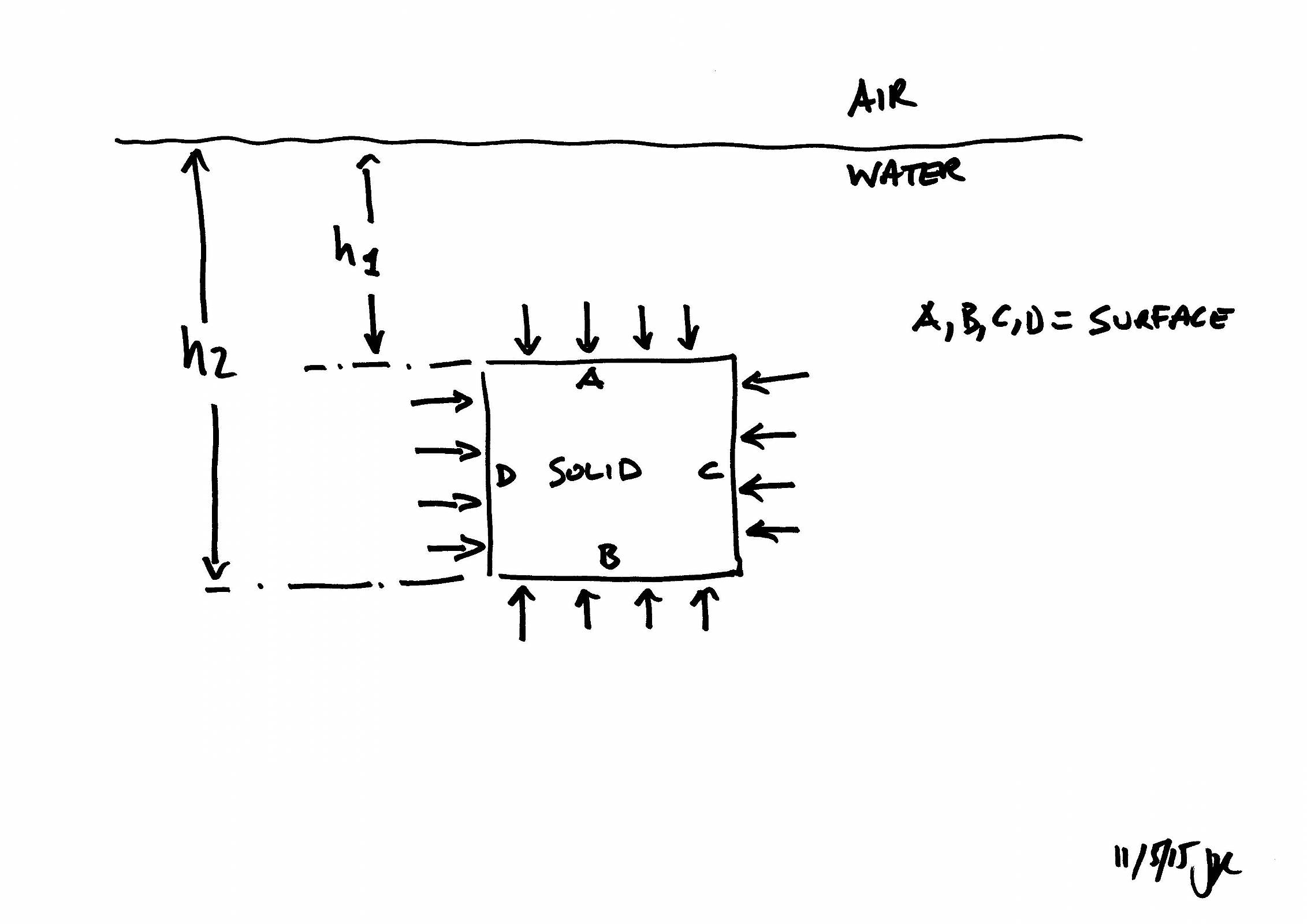

    Hmm..i loath to wade in, but.....The reason why you “don’t get it”, is because that fig.1 in that website is omitting the most important aspect of the “lecture”. Below is a modified but fully correct version of what should be posted.
    Take your solid block of wood, let’s call is anything except wood (to avoid confusion with materials), just call it a solid that is now fully immersed in water as shown.
    The pressure on the lower surface, B, at a depth of h2 is greater than the pressure on the upper surface A at h1.
    The pressure on surface D and C also act as shown, perpendicular to the surface.
    Simple physics tells you Force = pressure x area.
    So, for surface C the force = pressure x area, and since both these surfaces are same size same depth the area and pressure is the same, ergo so is the force.
    Now, not forgetting the vector of the forces on surfaces A, B C and D must be added together. But by inspection the force on surface D = force on surface C, but opposite direction, therefore these cancel out.
    So the upward force on surface B = press x area. And we all know pressure is simply (rho)gh.
    Rho is water density, g = 9.81m/s^2 and h = the water depth or head. So h is h1 and h2 for surface A and B respectively. And let’s call the area of each surface A.
    So this can now be rewritten as resultant force vertically = Force on surface B – force on surface A.
    = (h2 – h1).(rho)gA
    But we know that (h2-h1)A = volume of the solid, let’s call it V.
    (since the upthrust is equal to the weight of the fluid displaced by the object).
    Therefore upthrust = V(rho)g = mg.
    Where m = V.(rho).
    QED Upthrust = weight of liquid displaced.

    Thank`s for that information it will take me a while to follow that through.
    I do not think I am game to tell my customer that he can not have his v bottom and still have a shallow water boat. He will probably tell me there would only be a very insignificant difference anyway in draft and to go ahead with the improved design he asked for so he can have the advantages of a shallow v bottom.
    Archimedes`s empirical observation is interesting, but as an explanation for how something floats it is very limited. It tells us that something has to happen,but it doesn`t
    give us a mechanism that explains why that happens.In order to really understand what is going on with buoyancy, It is necessary to understand the idea of water pressure.

    And what Ad Hoc has shown above can be generalized to an object of any shape. Buoyancy, aka upthrust, of a floating object = weight of the fluid displaced by the object, independent of the shape of the object.
