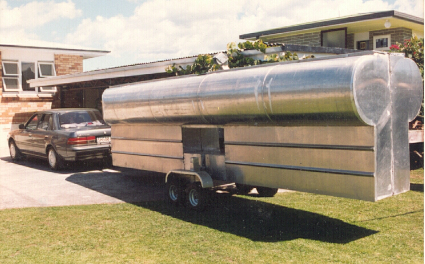

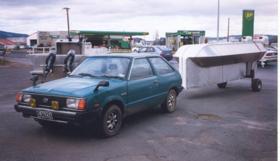

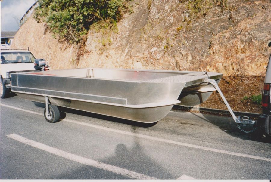

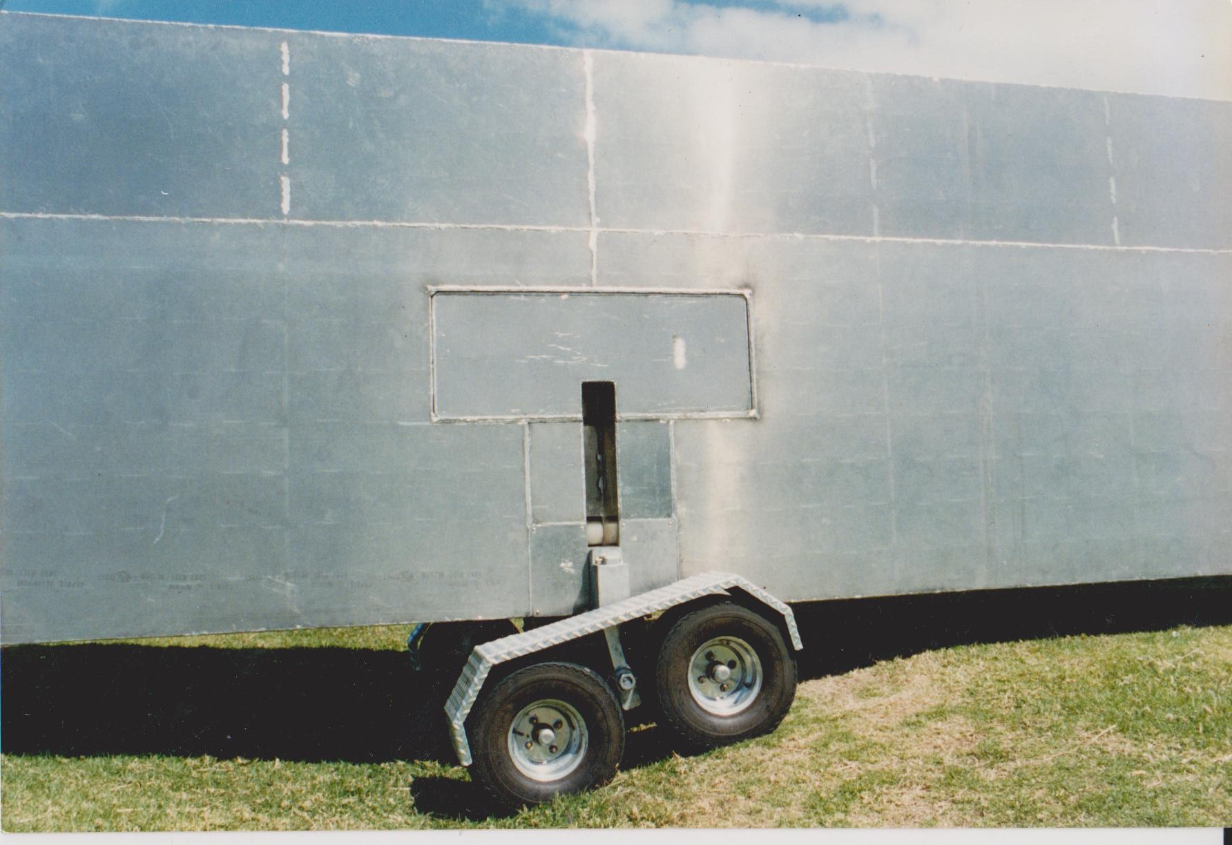

    Here are some examples of smaller wheels I used for the Myark trailer barges.

    My customers trailer will not require brakes for the smaller version of the World boat unless asked for, but will for bigger models. As all suspension systems have a bottoming out when striking heavy bumps rubber stops will be needed and some cushioning effect in such an event.
    This could be achieved by having these stops fixed to the trailer chassis and coming into contact with the axle.

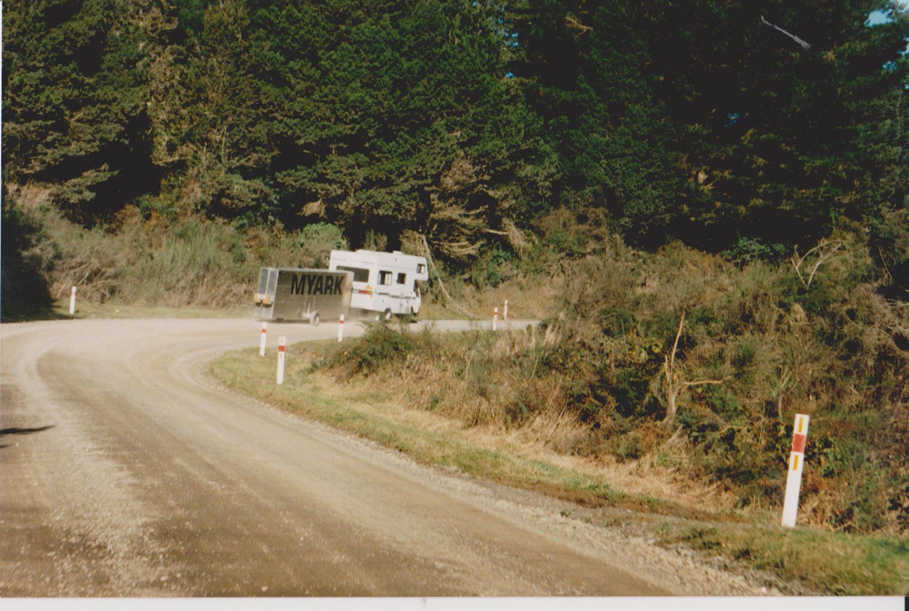

    20 odd years ago NZ was considering lowering the weight for brakes, but thousands of un braked trailers for boats it would of been complicated and never happened so I see.

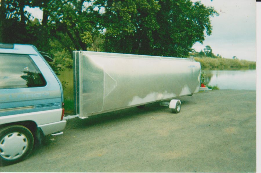

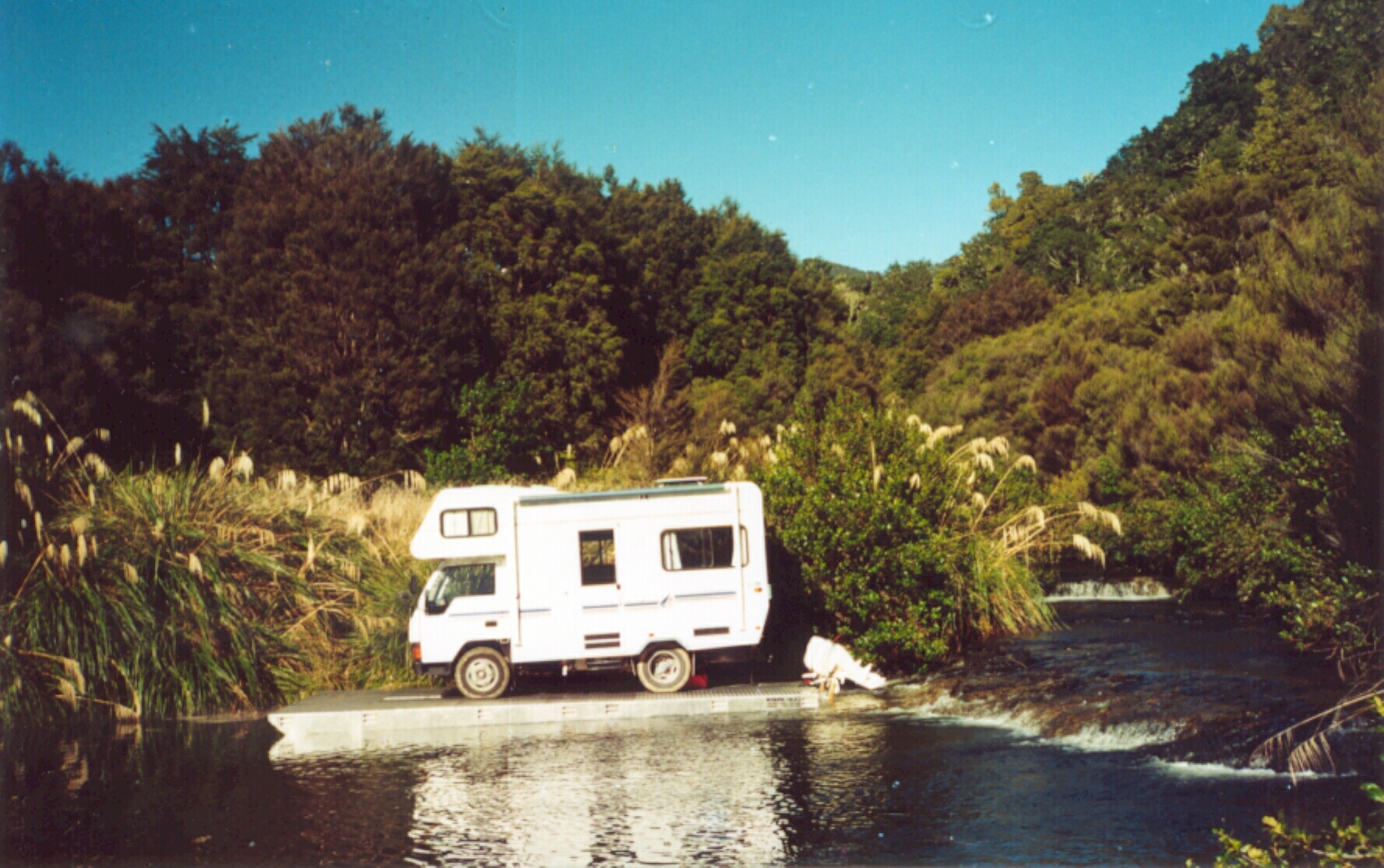

    An example what brought this unnecessary discussion about the Myark folding trailer barge that weighs 800kg including built in self trailer did not have brakes that could not stop from 90 kmh within a 4.m distance cars crashing in front of me, I decided to take another option that saved my life by not braking at all, in fact I sped up.
    You can also see with the towing RV camper which is over four times the Myark folding trailer barges weight, its obvious a mole hill that has been turned into a mountain.
    When I was towing this Myark trailer barge in the picture to Lake Waikaremoana on a narrow remote road in the most wilderness part of the north island NZ, it was like no load at all, especially such a narrow structure allowing full view behind because the width of only .800 mm wide, yet it unfolds to 3.6 wide and floats the 4000 kg RV in paradise.

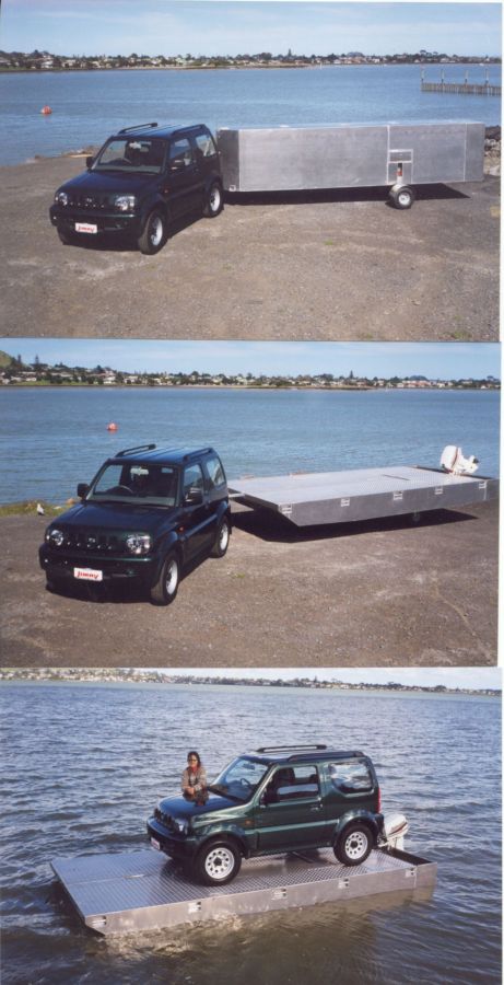

    I also mentioned that the future Myark designs are very light and abide to the vehicle manufactures strict towing conditions which are much more stricter than what you have mentioned, but not against the law.
    Future Myark folding self trailer barges for example that float a 2000kg vehicle or load, weighs under 400 kg which is the towing allowance for the smallest of cars for trailers braked or un braked by the vehicle manufacturer.
