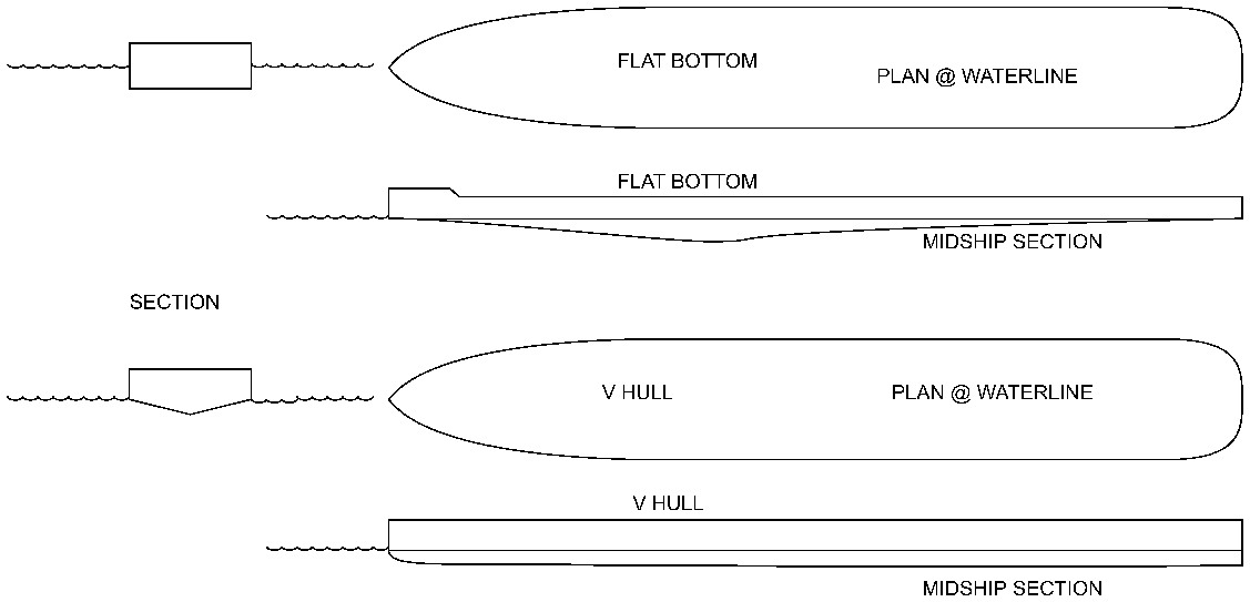

    "On the contrary, assuming constant mass, max beam, LWL, etc it isn't possible for a V bottom to not have a deeper draft"
    Yes, you are adding constraints, then making a conclusion WITH the added constraints in place. That is the point of the last paragragh of my post. HOWEVER, the constraints you mention indeed do not necessarily result in the v type hull having the deeper draft!
    Think about that while I make a couple of drawings illustrating this.

  9. fredrosse
    Joined: Jan 2005
    Posts: 399
    Likes: 55, Points: 38, Legacy Rep: 56
    Location: Philadelphia PA
    fredrosse USACE Steam
    Same Displacement, Same LWL, Same BWL
    Adding the constraints of same Displacement, Same Length on Waterline, and Same Beam on Waterline, one can imagine a hull with a flat bottom having greater draft than the Vee type hull.
    Add some more constraints?

  15. fredrosse
    Joined: Jan 2005
    Posts: 399
    Fundamentals
    OK, my posts here were only intended to illustrate that the fundamental equations are perfectly valid.
    In this thread many were making conclusions without actually considering the unwritten constraints that they were including into their mind's thinking, but not the written words of their posts.
    My sketches show exagerated features to illustrate that these additional constraints must be included if one is making statements as if they are absolute truth.
    Yes, with two vessels generally the same, then the Vee bottom will generally draw more water, but that word "generally" is needed for the statement to be correct. I read all the posts here, that is what prompted me to respond, being a teacher of engineering courses, although usually where the liquids are inside pipes.
