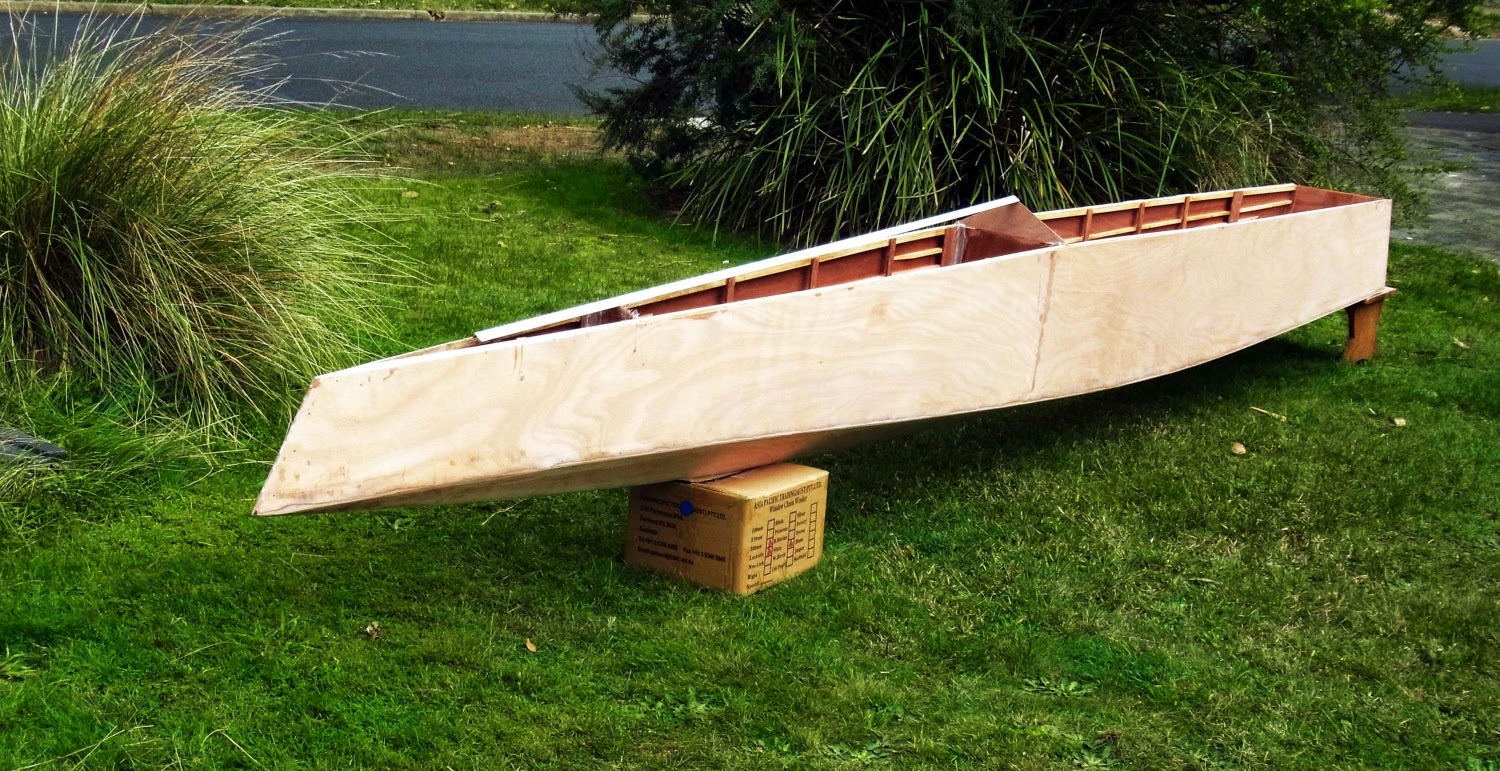

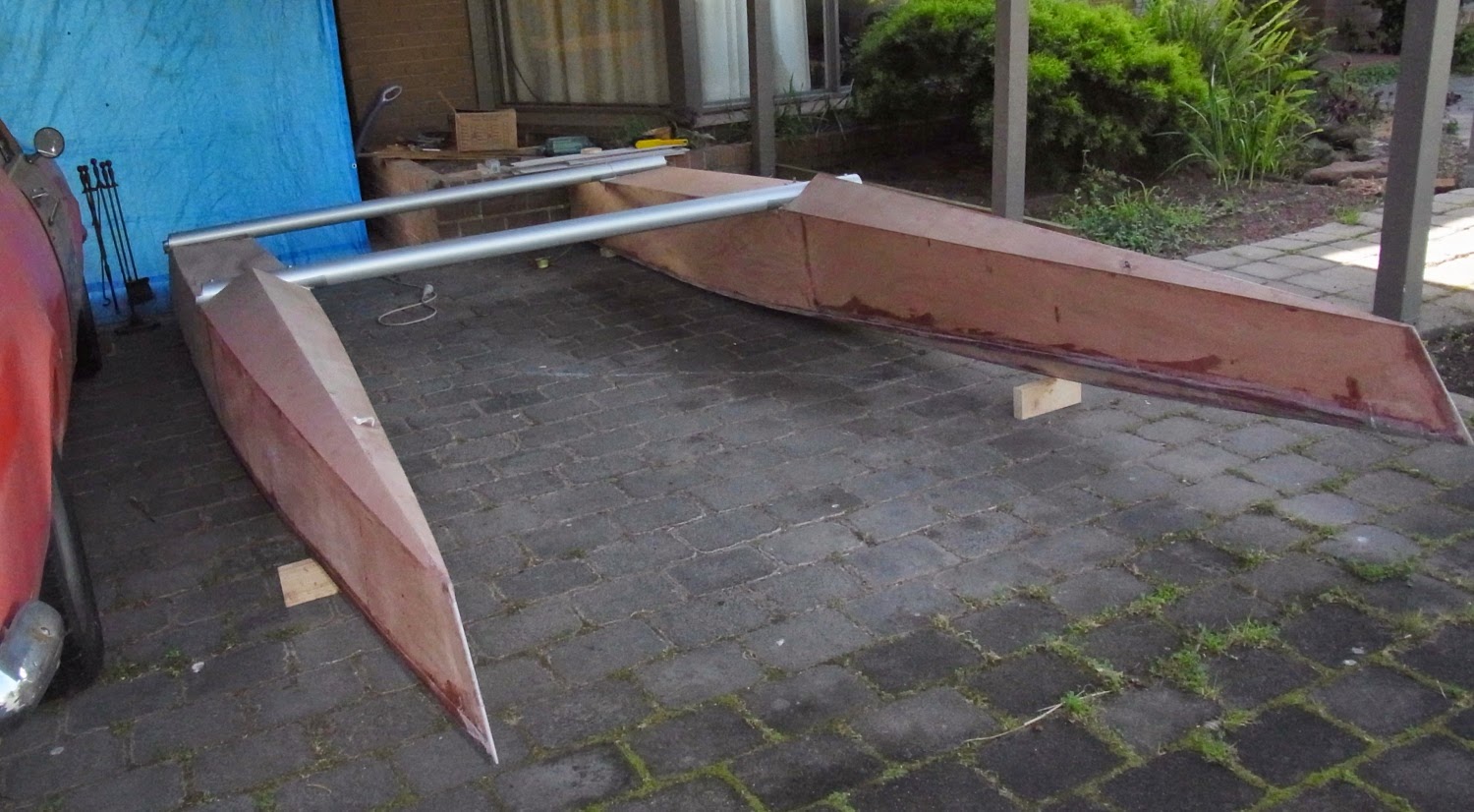

  3. Doug Lord
    Posts: 16,678
    Location: Cocoa, Florida
    Doug Lord Flight Ready
    This is the "homemade" Stealth foiler built out of plywood for the hulls:
    From my post in the "New Catamaran Foilers" thread under multihulls here: http://www.boatdesign.net/forums/multihulls/new-catamaran-foilers-51898.html

    Thanks Doug - that does make plywood look a lot more attractive than I'd thought, but they don't state the weight of the boat, and it wouldn't be easy to make the shape I want either because my hulls are all curves.

    Hi Doug - it's certainly interesting to see the insides of those plywood hulls. Are you now thinking of building Fire Arrow out of plywood instead of carbon fibre?
