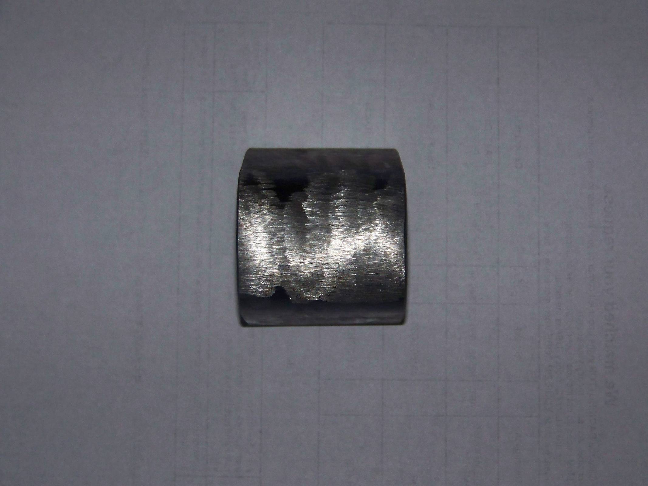

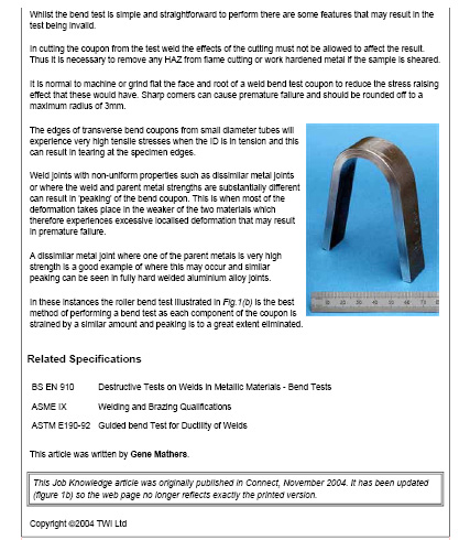

    Concur with Welder/Fitter....your coupon is a fail, sorry.
    As noted, looks like LOP/LOF and lamellar tearing.
    X-ray's need to be shot at very close proximity with the right amount of energy too. Do you know the spec's of the x-ray it produces?
    These might be of use too:

    Andyman,
    Pay close attention to "Ad Hoc's" attachments. Though it would not address the issues with your coupons, you should be polishing the corners & edges of your coupons. More than a few welders have had their coupons fail guided bend tests because they did not address the non-welding issues, such as mill scale removal on the test plates(root edges & joint faces) and grinding/polishing of coupons.

    when I took the coupon to the inspector I know he said it was fine. That usually if it doesn't break it's good. Also mentioned that i could use liquid dye penetrate to test my welds for surface imperfections. So what makes you guys say it fails? He is a certified weld inspector at the space center. what qualifications do you guys have in this area?

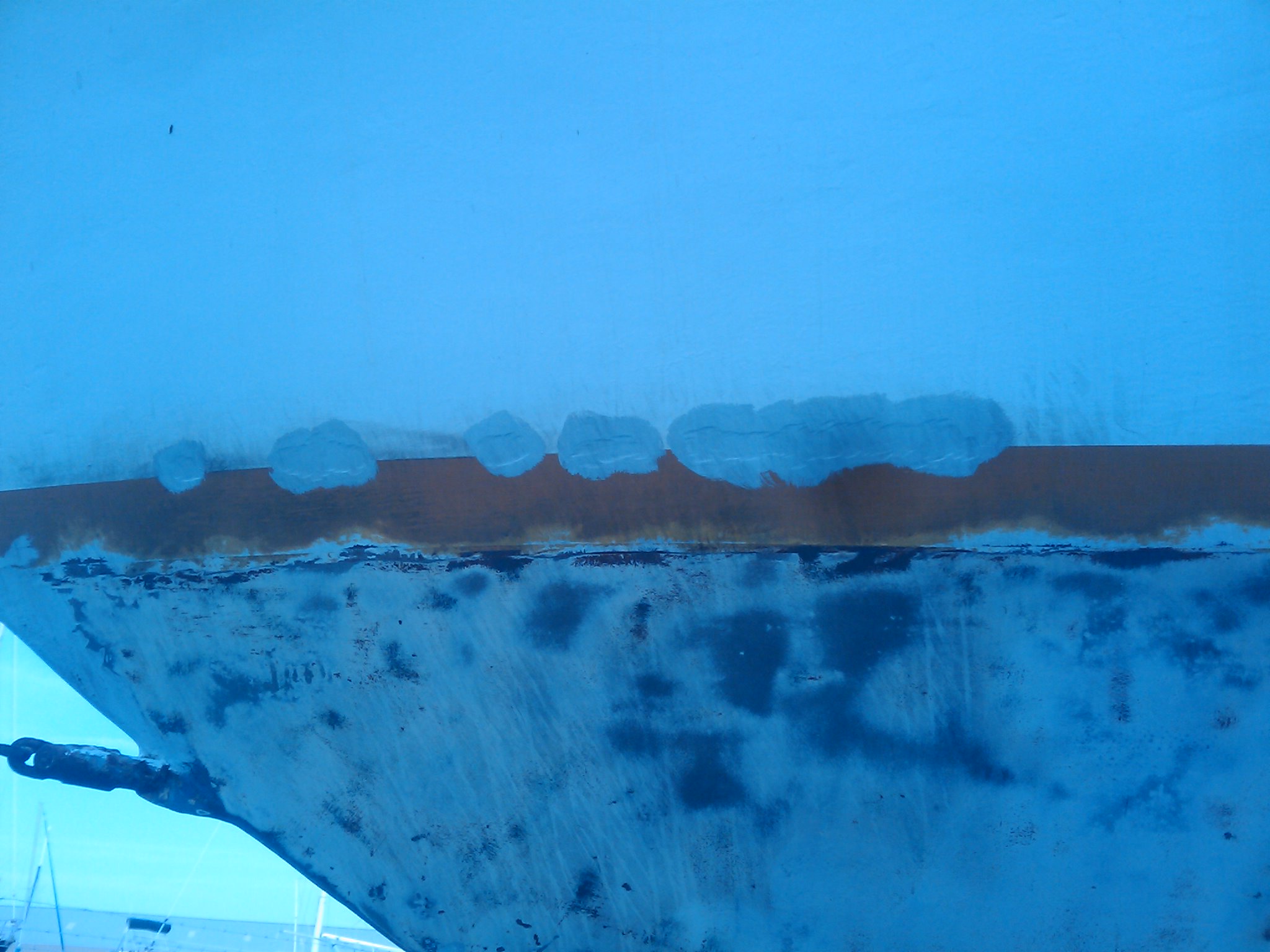

    I don't know the actual size of the boat so i went and found a picture of it.
    Also had the chance to do some more bend tests and i think i got a keeper. The bend in the picture is of a root bend, I TIGed(for the hell of it) the back of the root then MIGed the front, cut into the back of the weld and MIGed over that. Also got to thinking and I'm wondering if I'm using the correct former and correct guides. I used the equation with the smallest results outta my book since they weren't really labeled. Figured that would be my safest bet. Anyways my former is 1-1/4"dia and the spacing between my guides is 1-3/4" let me know what you think.

    Can you use "paint" or a similar program & mark the areas in the photo you want to replace/repair?
    When I enlarged your coupon photo, all I could see was blurred, but in the non-enlarged version it looks like a major improvement.
    As PDW says, you don't want to be working on an area that is backed with insulation, fixtures, etc., because the whole thing could go up in flames. Assuming that you take this into account, you can use fairly thin material or material of a similar thickness to your insert(replacement) material. depending on room, your backing strip should be about an inch to an inch & a half wide(1" to 1 1/2"). you lap the strip to the inside surface of the hull cut-out (after you've cleaned up the existing edge, of course & pre-fit the backing ring), clamp it in, and tack it in(small tacks). The insert should be of a size that there is about a 1/4" to 5/16" gap between the existing edge and the insert's edge on all sides. Don't forget that the corners must be radiused. Then you weld up the seam, making sure that you get into the edges on each side of the seam. The only problem with this repair is that we have to go back to PDW's comments because you will still need enough access from the interior of the boat to be able to paint the completed job. I'd recommend having the owner of the boat read this thread, as it will give him a greater appreciation for why you need to access the inside of the hull. Sure, he could simply have you weld doubler-plates(patches) onto the exterior surface of the hull & overlap the edges enough to not worry about doing more than pre-priming the plate then painting the outside, but it would be a pretty shabby looking repair, imho.

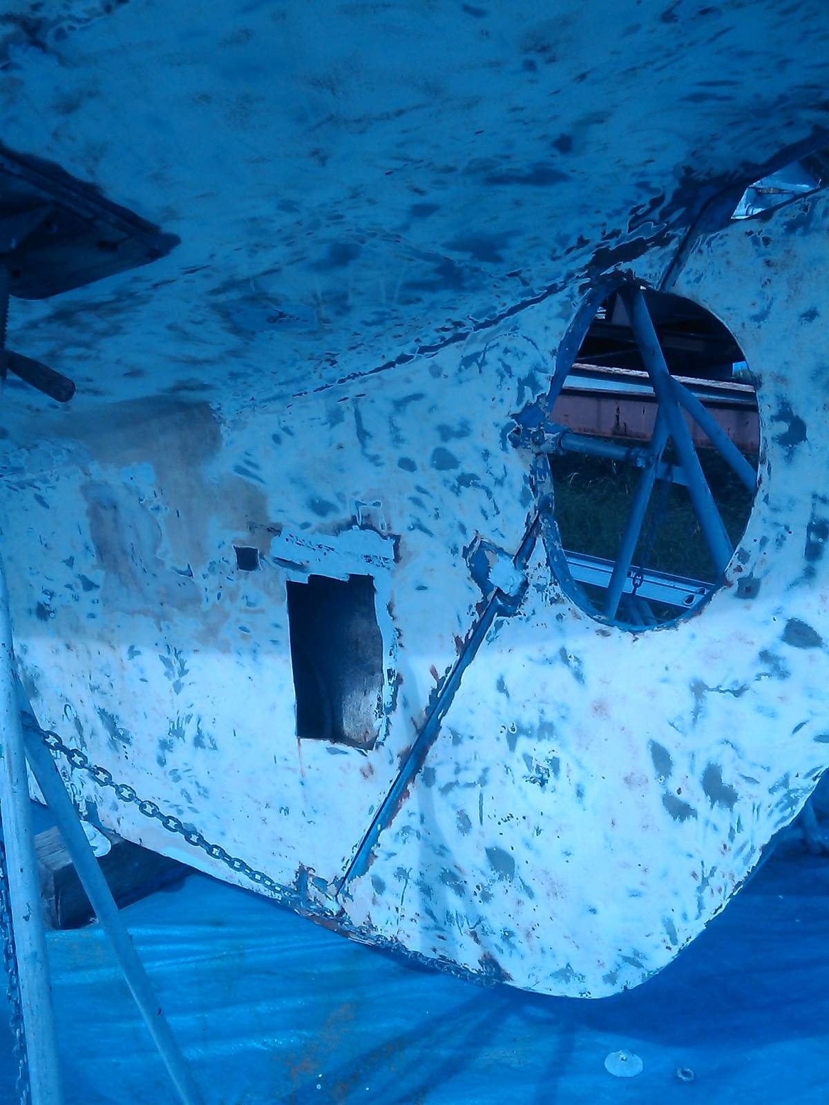

  11. Andyman
    Joined: Sep 2010
    Posts: 13
    Location: florida
    Andyman Junior Member
    Mike
    i was referring more to how to hold the backing up since i can't exactly use clamps unless i tack something to the haul to clamp to or tack a clamp on the haul.
    Do i really need a 1/4 - 5/16 gap? all my tests have been with a 1/16 gap.

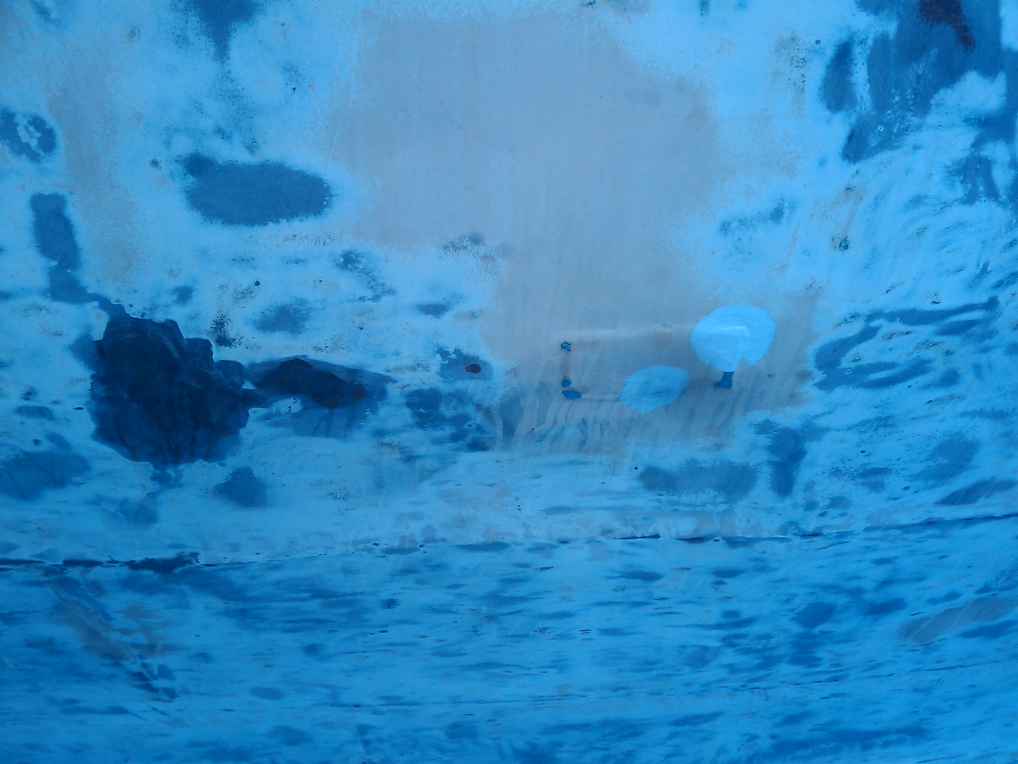

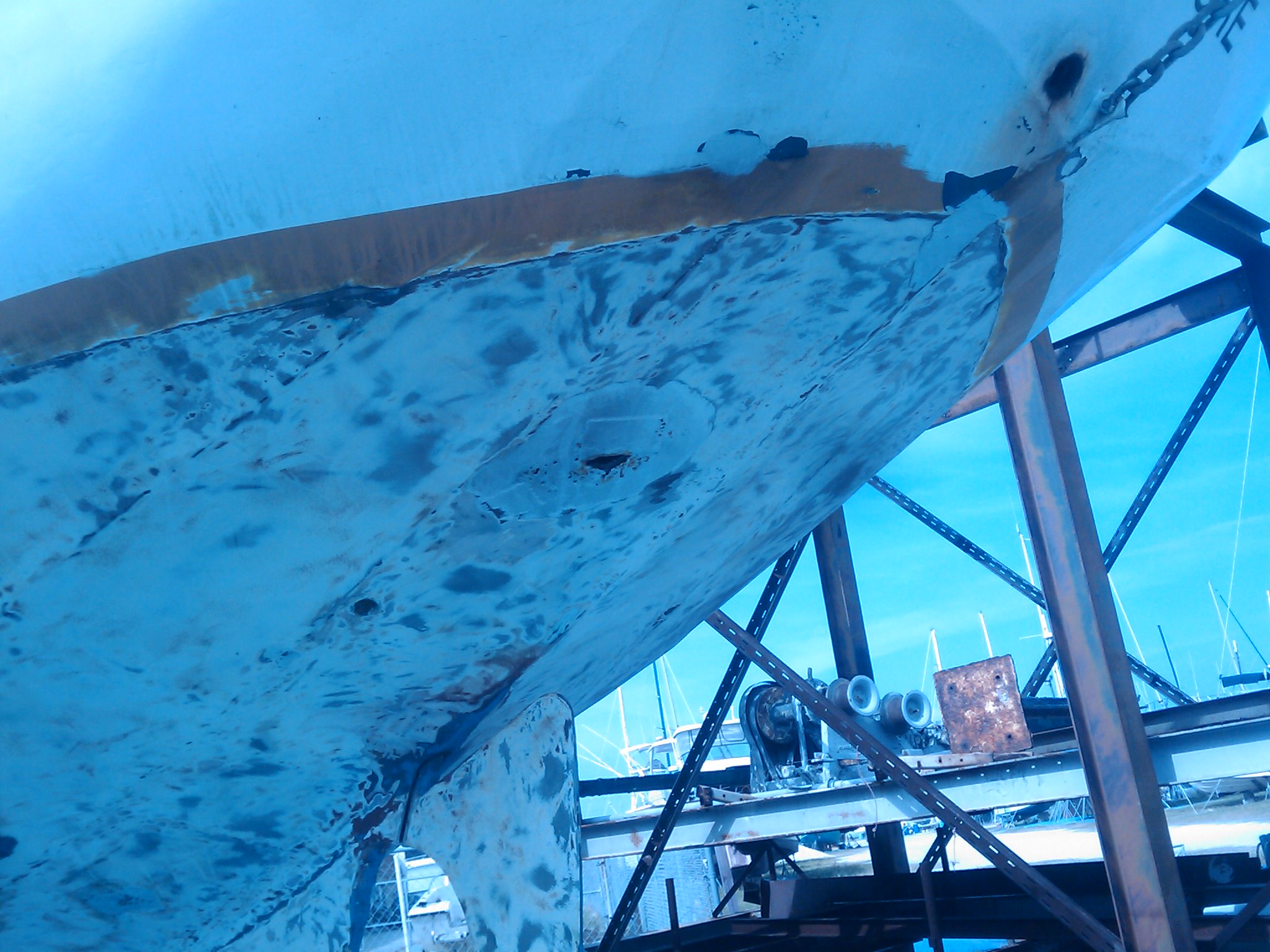

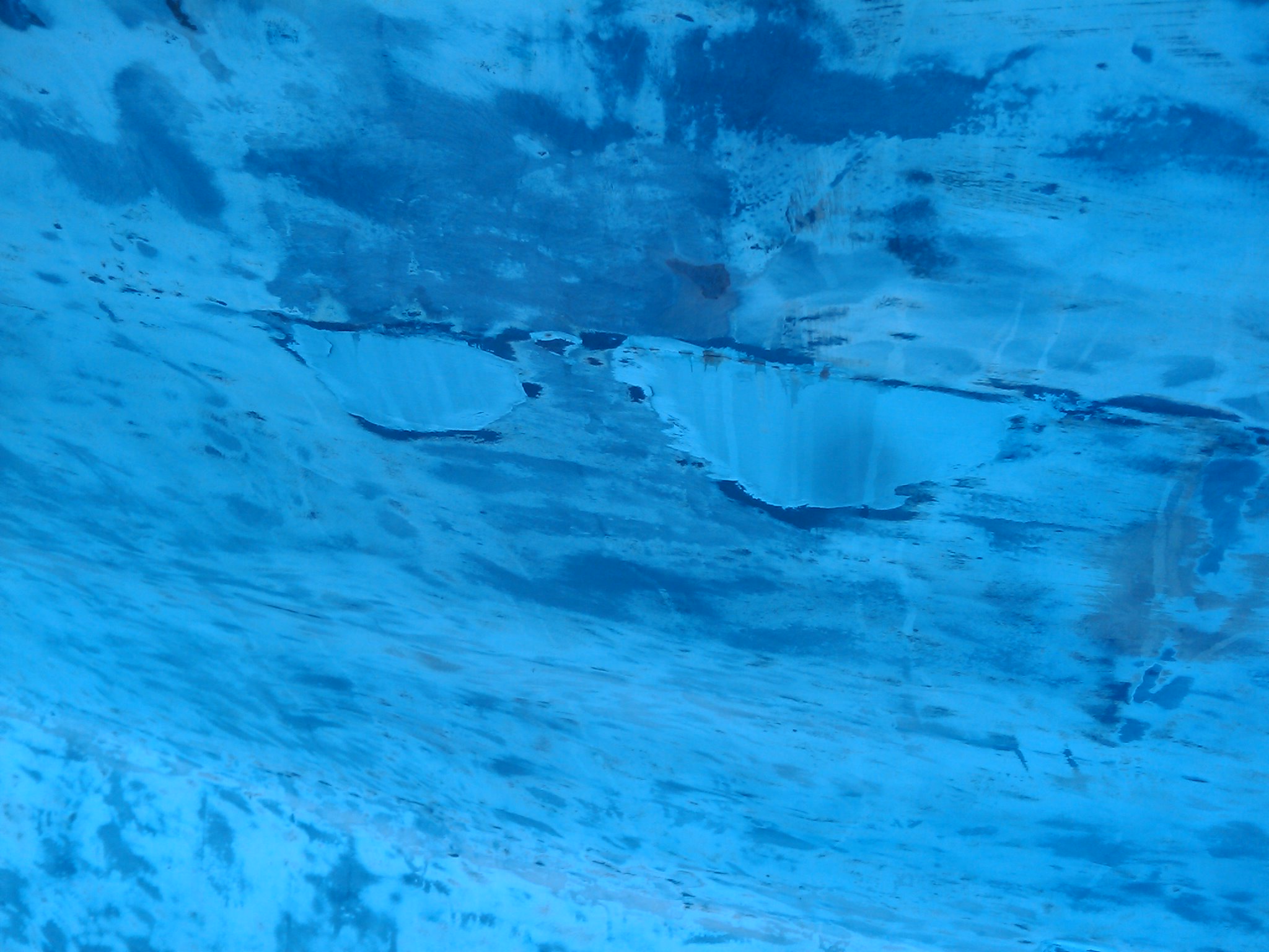

    Took another picture on the bend and went out and got some pics of the boat. I believe he said he wanted to replace all the spot that have white paint on them.

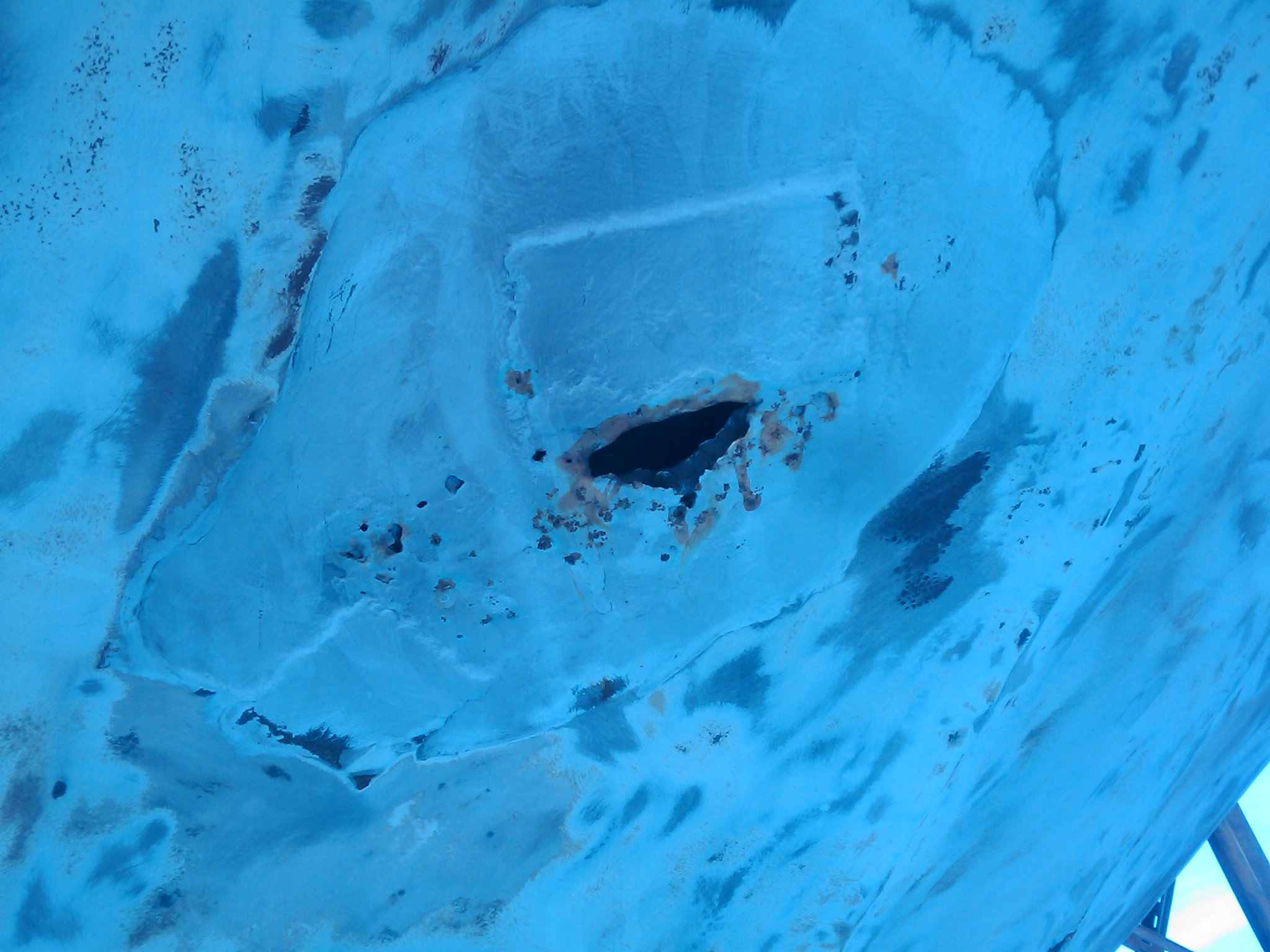

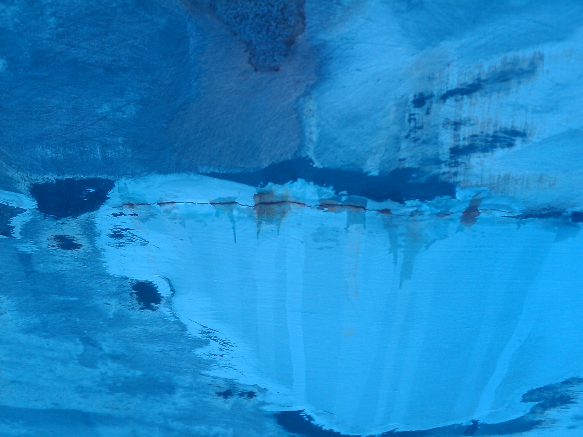

  12. Andyman
    Joined: Sep 2010
    Posts: 13
    Location: florida
    forgot pics
    #1: I think he said he was gonna open this whole up more

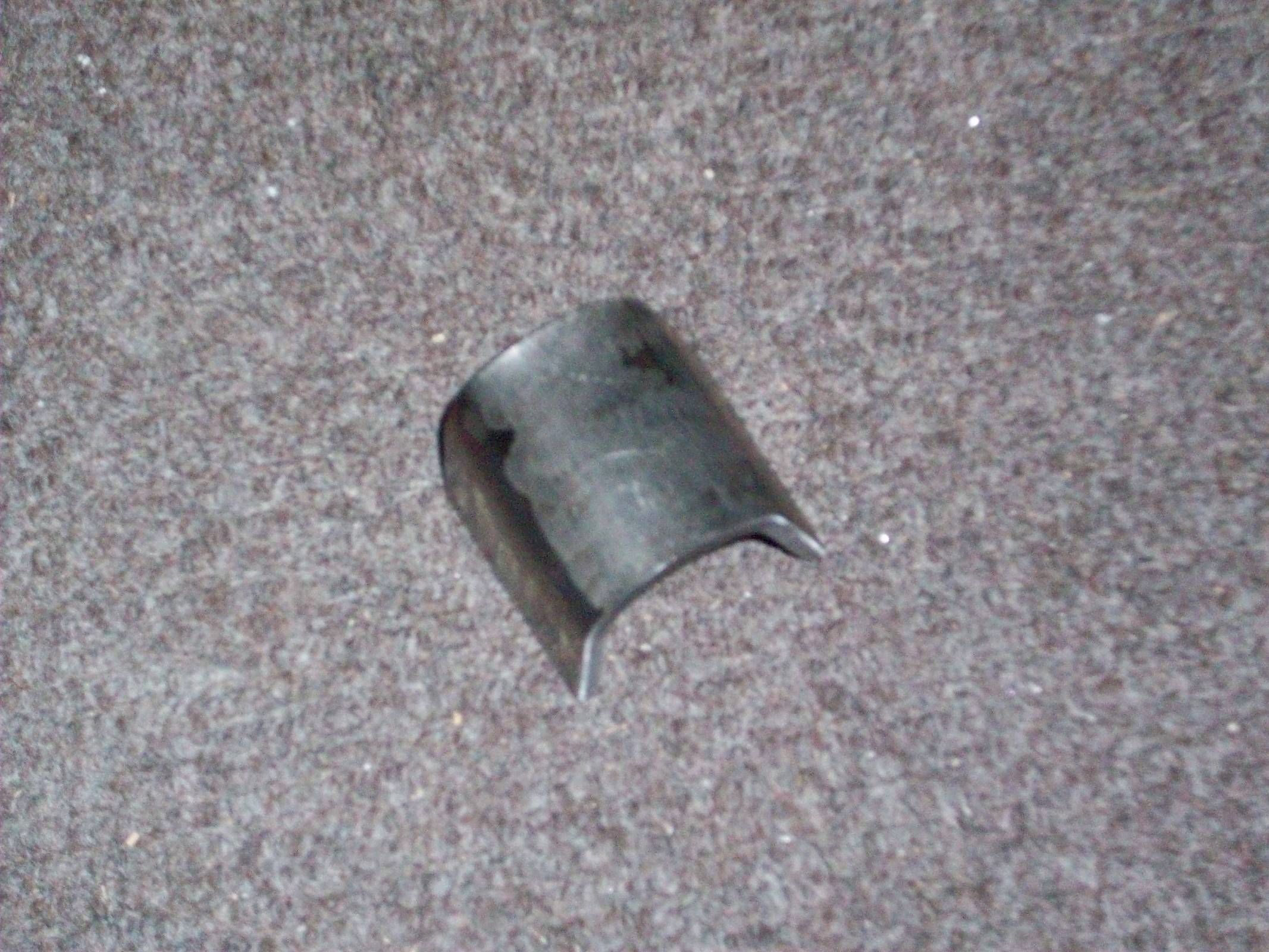

    #2&3: I think I'd be replacing this hole area that is shown in #3

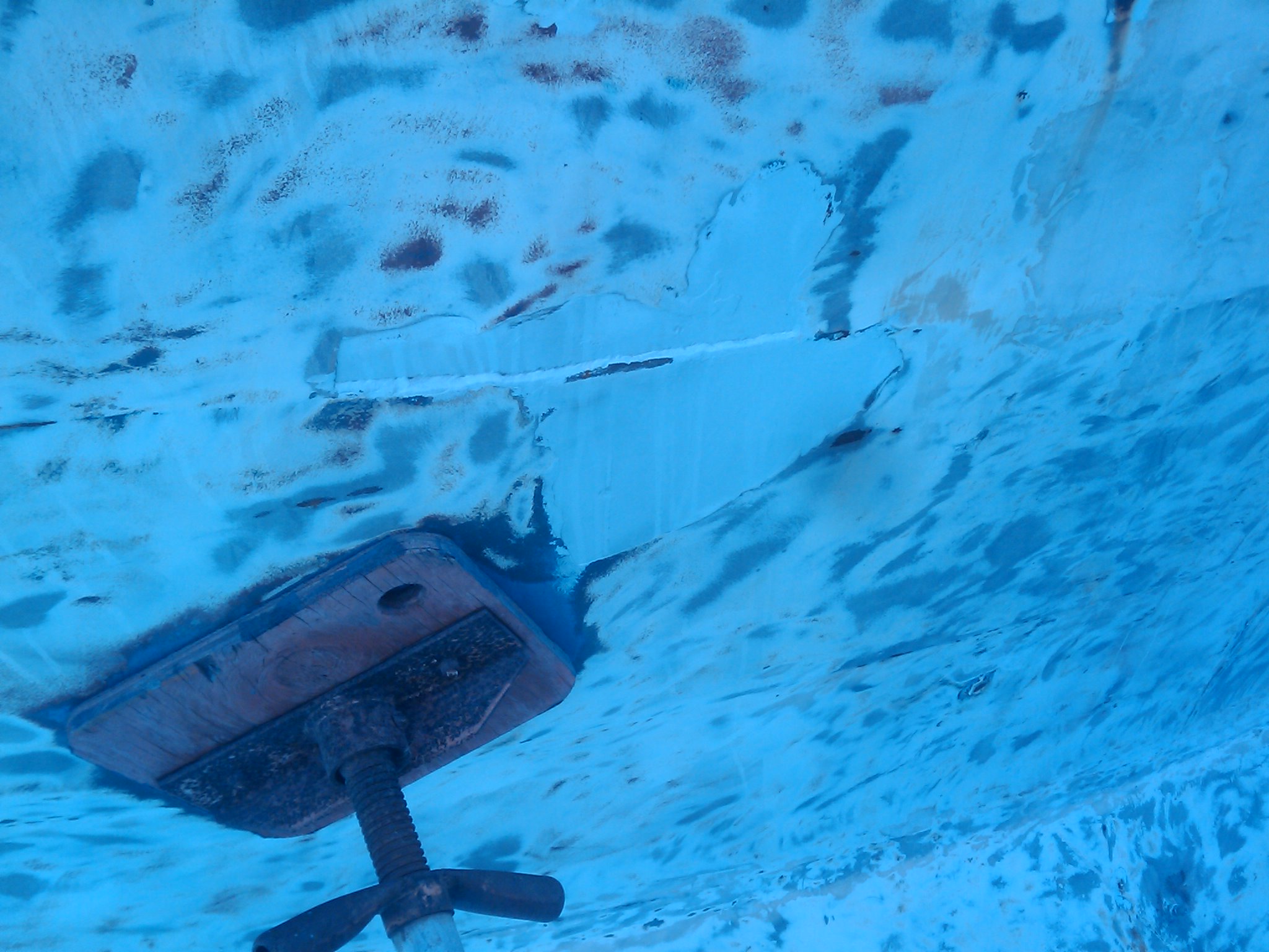

    #4: cutting a hole out much like in #1

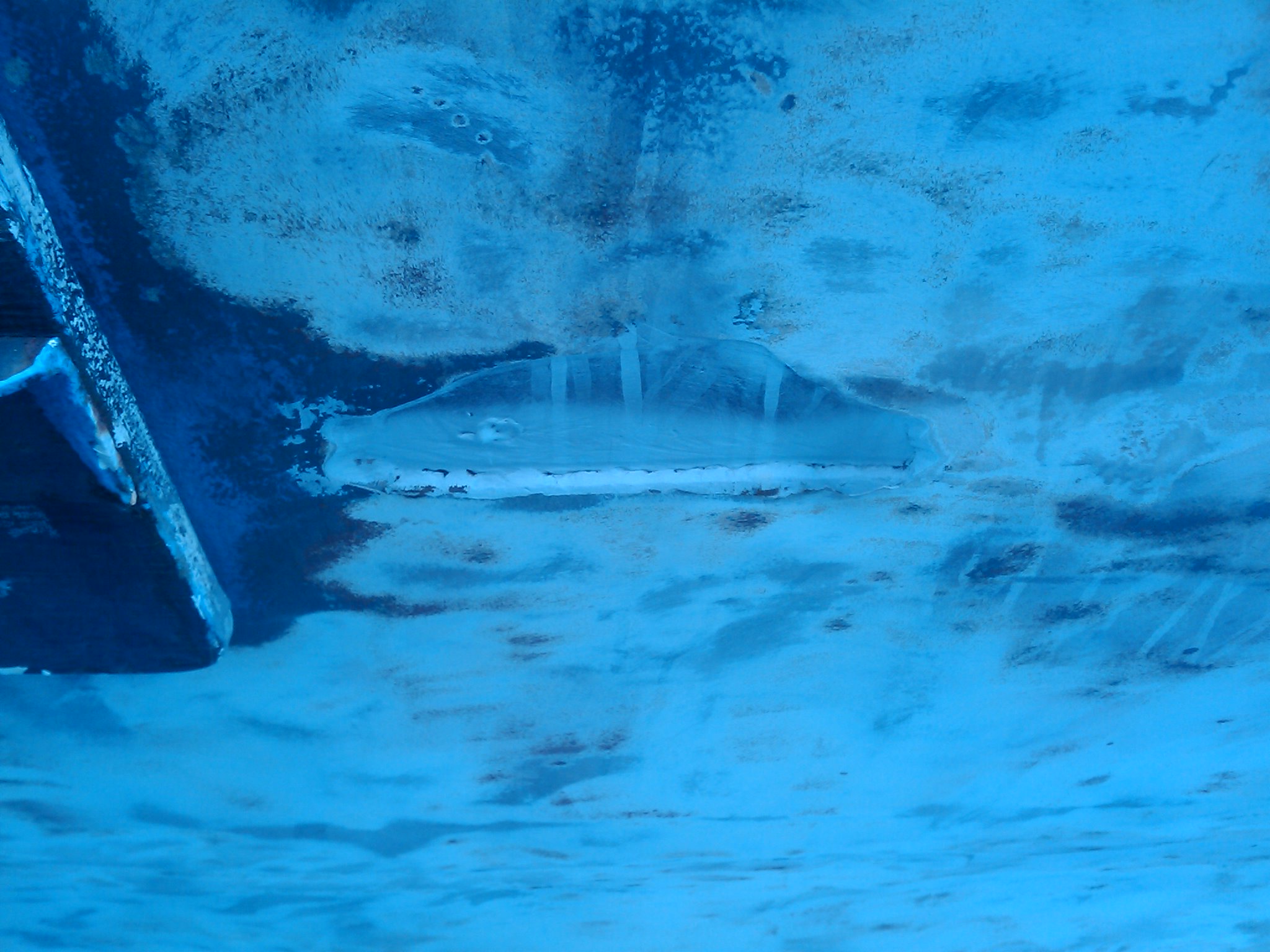

    #5: small whole almost above the water line.

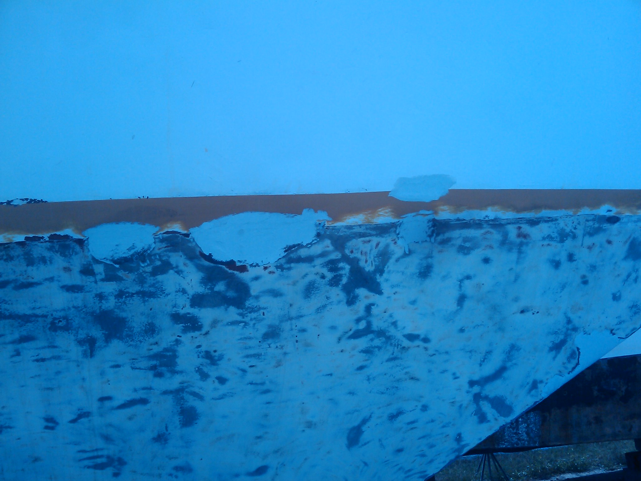

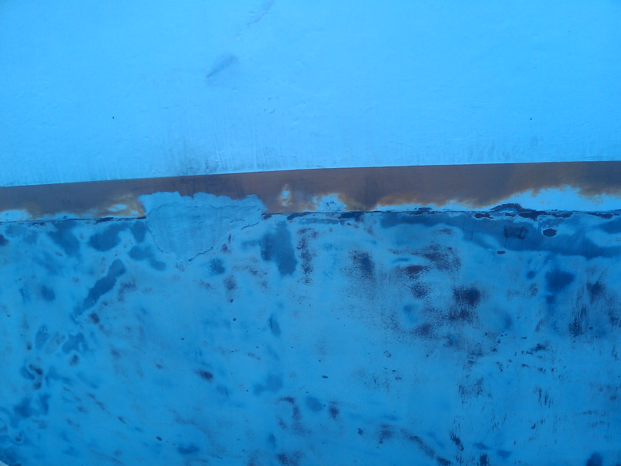

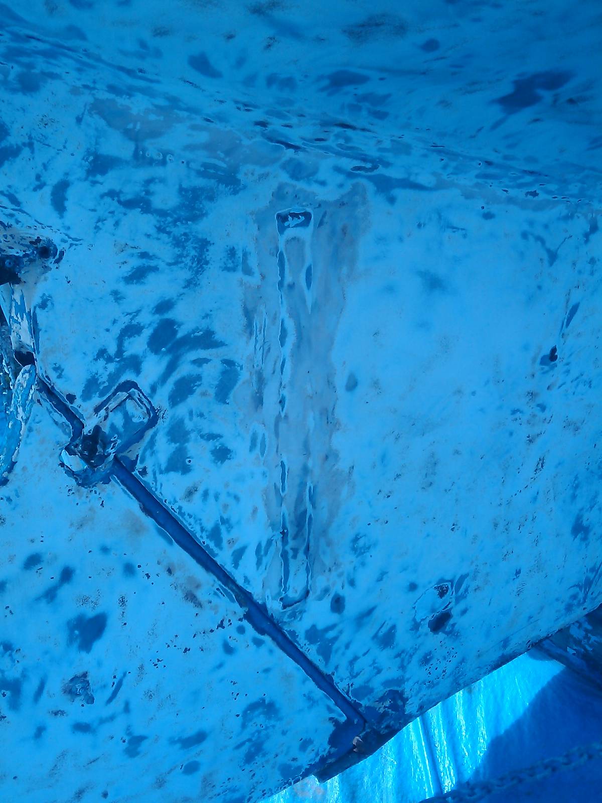

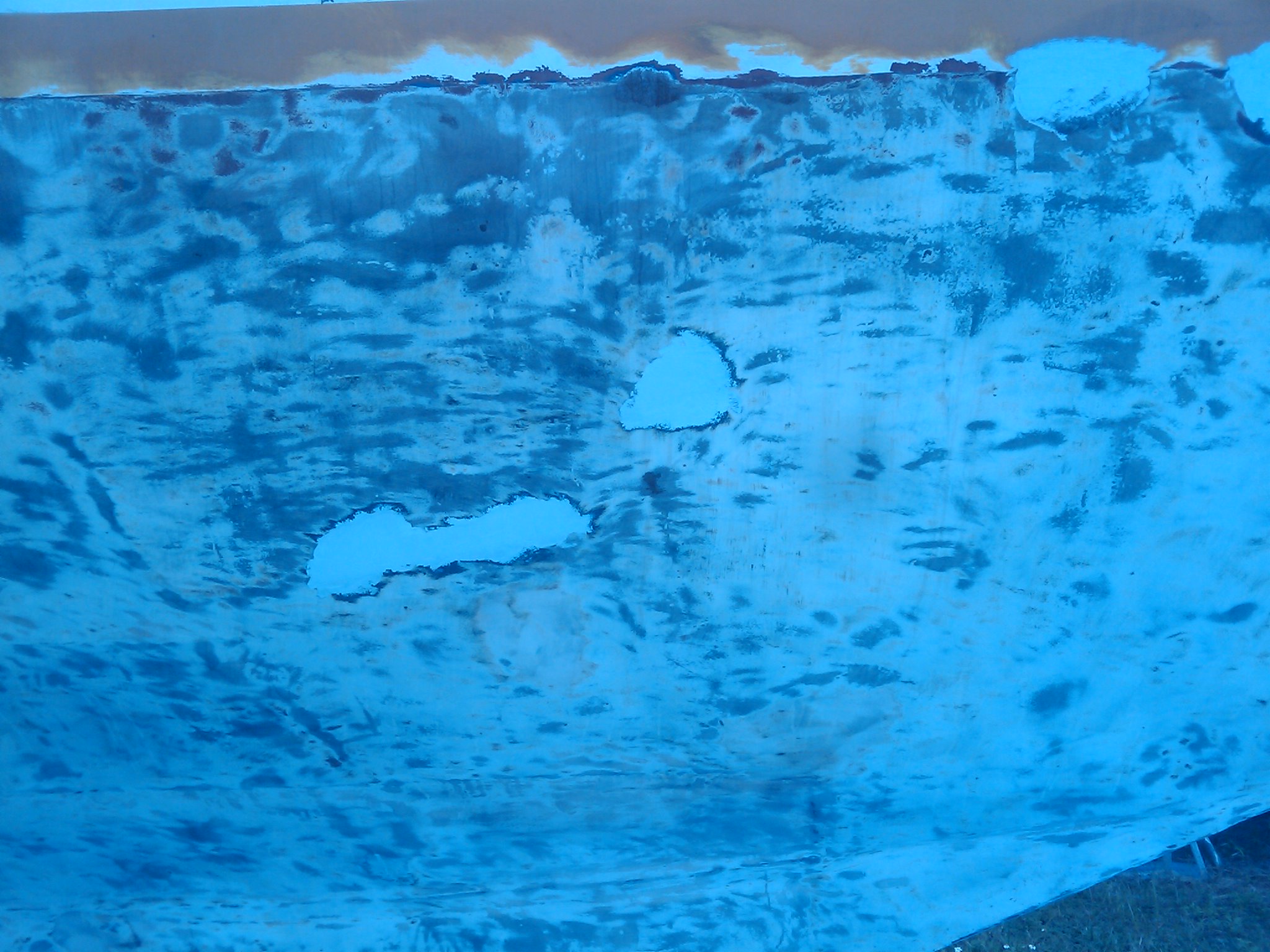

  13. Andyman
    Joined: Sep 2010
    Posts: 13
    Location: florida
    more pics
    1: i think I'm replacing the rusty area to the left and maybe the patch that's on the right.
    2 & 3: I think i'm replacing both areas in #2. in #2 you can kinda see the the crack in the area on the right #3 is a close up of that.
    the rest: might be replacing these areas
    and another pic of the bend

    what is the actual plate thickness where you plan to weld?
    cann you cut back to full thickness?
  15. Andyman
    Joined: Sep 2010
    Posts: 13
    Location: florida
    3/16 is the thickness
