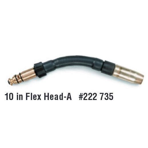

Not sure what welding head that you have on the Mig, but if it is a Spoolamatic or equivalent, you can purchase for about $100 a flexible transition piece between the gun and the nozzle to permit confine space welding
a Spoolamatic , a flexible transition piece between the gun and the nozzle to permit confine space welding
This sounds like the go I feel. something on a 90degree angle perhaps to get into confined spaces. I'll also have to push clean air through the space yes ? I'll take more pix tomorrow and post them here once I get back to the vessel. ( I just purchased her so have do a proper handover from the previous owner ) He might be able to show me the best interanl entry point as well.
A flex nozzle permits just about any angle or a cobra (or equivalent push pull) gun

As a normal push pull gun is very long, it mainly offers a smaller head/nozzle. This unit is installed 6 feet away from the head and uses a small mig head assembly and appears to be smallest for limited access welding. The advantages then are a lighter head assembly and in a large production shop, the economy of buying 5 or 10 pound rools/spools or wire that can be mounted on the main welder.
