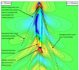

    During a study on increasing payload capacity of a navy destroyer using retrofitted side-hull expansions, we discovered a nice wave cancellation mechanism akin to the bulbous bow. The side hull expansions modified the wave profile along the hull such that the wave-energy was reduced with a better pressure recovery at the stern. This effect applies to displacement vessels operating at length Froude number range of 0.1 to 0.3. Has anyone seen/used this effect in a boat?
    Link to paper:
    http://www.flowcfd.com/uploads/5/3/4/0/53401797/_fast-2015-hybrid-ship-updated2.pdf

    You would need to validate the CFD first.
    Many small/minor appendages or changes to hull shape locally can each have their own influences, but as you note, usually at a given narrowly defined Fn range. And, as you note in the paper, you may gain in one location but lose in another, this case roll period! Nothing in life is for free...thus the best boat is a good compromise of all the conflicting requirements. There is no such thing as "the best" or "the most optimal" hull. Just "the best" for THAT design requirement, no more no less.

    PhilSweet, Many thanks for the link! The boats in fig 29,30 look very similar to what we got. Chi-Chao's book looks very interesting indeed. That too from 1972! wonder why we don't see too many of those funny looking boats around yet.
    DMac, no deflation worries :) I am happy to learn. Looks like the old news is older than you thought.
    Ad Hoc, There is some chatter from the powers that be about model testing for validation; keeping my fingers crossed. In the meantime, I am thinking of modifying my kayak with styrofoam and paddling around in the summer.
    Messa, yes, the blistering eye sore would also require force to generate the second wave, but the resulting destructive interference modifies the overall pressure distribution around the hull that the wave resistance is reduced with a better pressure recovery at the aft. A simplistic analogy would be a bunch of surfer dudes carrying some of the payload surfing the bow waves and the rooster tail, thereby recovering some of the wave energy.

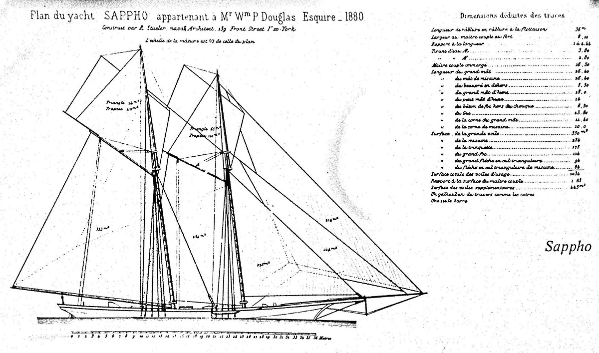

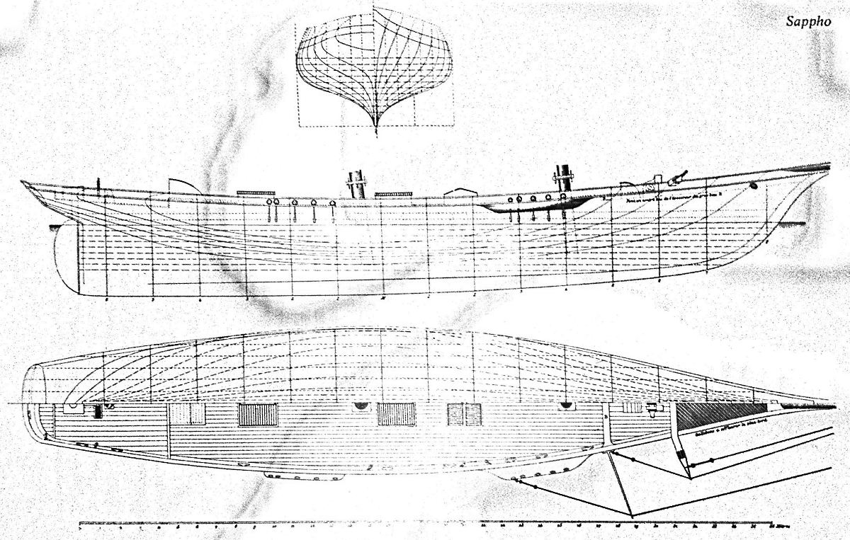

  12. daiquiri
    Joined: May 2004
    Posts: 5,373
    When I first approached the boat design 20 yrs ago, CFD was used almost exclusively by the aeronautical industry. The theory, the turbulence models the numerical techniques were in a quite advanced stage of development, but the required hardware was still slow and costly. It was absolutely out of reach of an average boat designer, let alone a poor student like I was.
    So I had to learn from books. :D
    Many of them were about the history of yacht design, dealing with designs from big caliber names like Robert Stevens, Colin Archer, Dixon Kemp, Uffa Fox and others.
    And as soon as I read the subject of this thread, I have recalled the story about the schooner yacht Sappho, designed by William Townsen. After she was built, she had started attending the regattas. There was a considerable money circulating in the betting industry, hence so many regattas were held for big yachts at that time. But she had lost all the races she attended, so the owner took her to England with intention too try making her compete for the America's Cup. It was supposed to be an easy task, because American boats were routinely winning against the British fleet in AC of the time. Sappho raced the Isle of Wight race but she lost even that one, ending up last. The first place was won by the schooner Cambria.
    After getting back to the US, she was sold and the new owner ordered a rebuild of the hull. The central part of the hull was stripped of the planks, new wood was added to the outer edge of her ribs in order to increase the waterline beam of the hull, and was re-planked again. In other words, she has been "hipped" - that's the term used by Dixon Kemp to describe this kind of refit (the on-line version of Kemp's dictionary can be found here: http://www.thecheappages.com/kemp/).
    After the refit was over, she was taken back to racing fields. The first race of the "hipped" Sappho was again Cambria, previous year's winner. Three races, three large victories by Sappho. And she kept winning after that.
    What's the point of this story? Well, I guess there are two of them:
    1) The technique of "hipping" of the hull as a way for increasing the speed of the boat was well-known by experienced yacht designers and builders back in 19 century.
    2) Studying the history of ship and yacht design, even the anecdotal one, can be as important as studying the modern ship technology. It gives a good insight into what has been done in the past and which direction can one go in search for new solutions. :)
    Cheers
