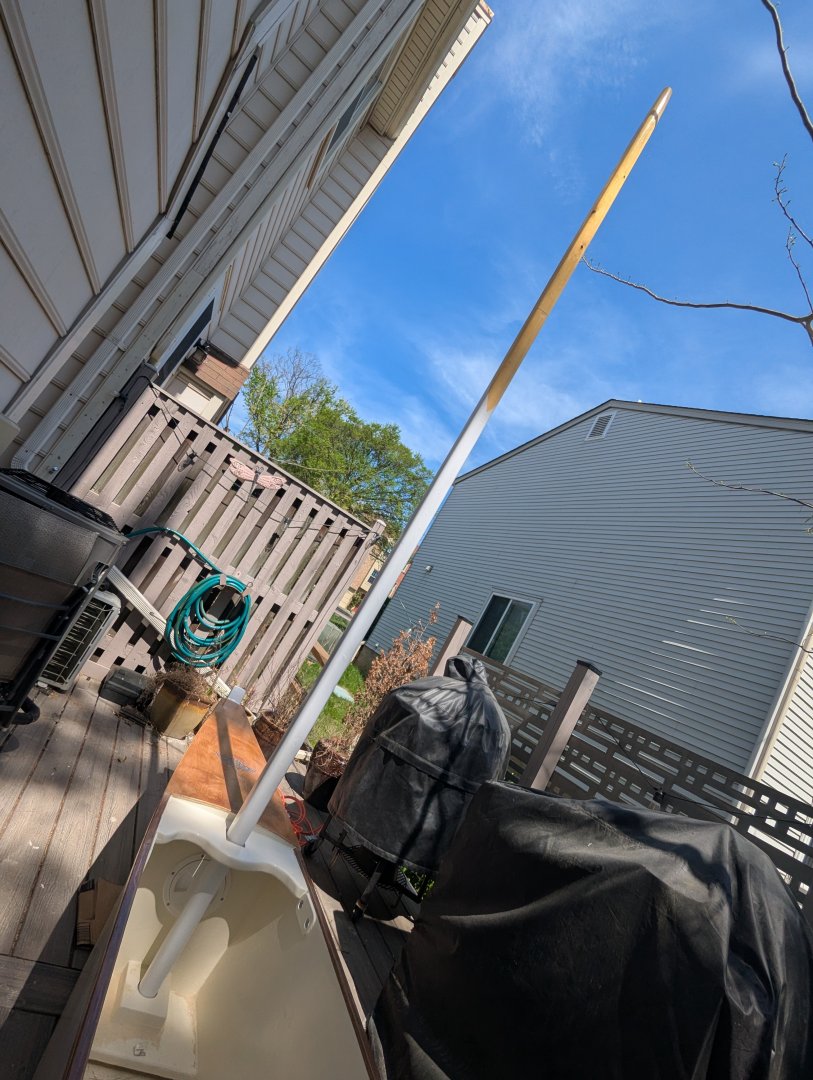

Today I recut the hole for the mast since it is square. Starting to look like a real sailboat! PXL_20260412_165959400.jpg
I'm going to line the mast step with seat belt webbing so it does not scratch the finish of the mast.
Now I'm trying to think of how to handle the halyard at the top of the mast. Since the gaff will be sitting right at where the halyard attachment is, it may rub a lot and so if it is a pulley it may damage the gaff over time.
So I'm thinking either drill a big hole with some bushings through the mast, or install Michael S halyard ring assembly. Thoughts?
A low friction ring would be slightly more expensive than a ss ring but well suited for this situation.
You would loose a little 'headroom' using a thimble but it's what I'd probably use.
Thanks for the recommendation. A thimble is designed just for that purpose.
