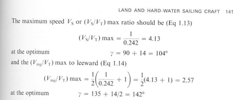

    Since you're referencing Marchaj, here's what he says about VMG:
    Doesn't any VMG > Vt disprove your argument?
    This analysis of ideal iceboats doesn't require any discussion of energy. Just forces & angles. And the only thing that's infinite is the "hydrodynamic" L/D, but that's because D=0, not L=infinity.
