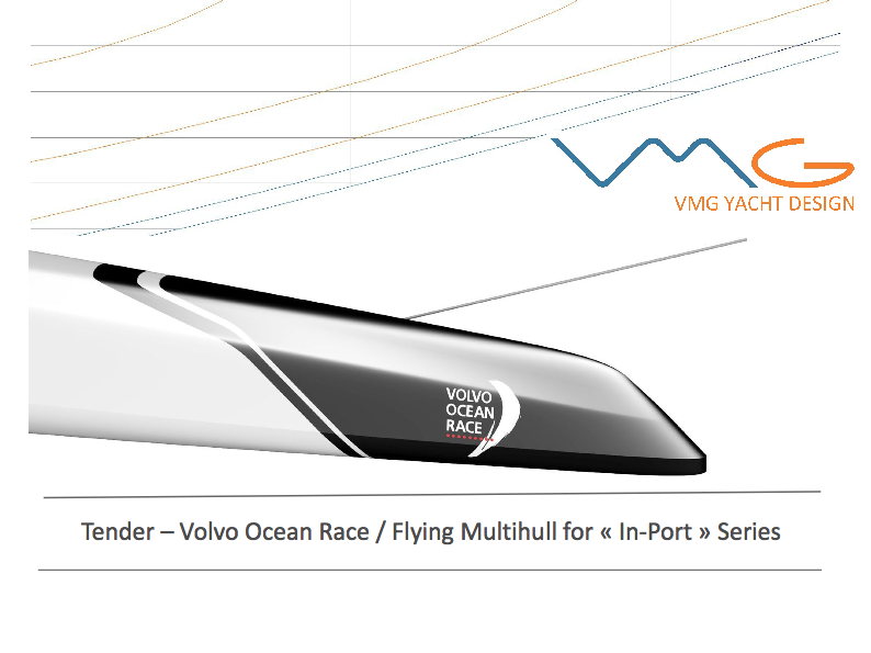

    Info from Doug Schickler from a thread of mine on SA :
    Part 1--
    So, the first thing to understand about the project as you see it, is that it was a concept that was developed for a very specific type of event. Inshore, short course, 99-100% foiling fleet racing. ST does not for a moment think that this kind of craft is there to erase all other forms of sailing. Those who say that if this is the future of sailing, why sail? Well, sail what you like. I like small skiffs / dinghies and large cats. I am infatuated with minis. Davide loves the moth. Davide and I have not done as much foiling as maybe half of the readers of this forum, but that does not negate what we bring to the table as designers and engineers very much in the thick of foiling design work e.g. dna G4, Luna Rossa, Team France and many other projects in between.
    Does anyone dispute that the development from AC45, GC32, AC72, AC50 and others that the current layout, with crew crossing the boat and a foil layout that, when things go very wrong, too often ends in a nosedive, does not provide a platform where VIP sailors and/or non-sailors can be safety foiled around the race course by a professional team? That is the goal of the design, at its heart. If not going from side to side, Frank Cammas does not nearly lose his leg falling overboard. If not positioned in the hull cockpit, Team Softbank Japan sailors do not get narrowly saved by the shroud of their boat in a pre-start. Foiling racing with just 2 boats is a fair bit more dangerous than most sailors have experienced. Just as racing an ultimate tri trans ocean is more dangerous than foiling an A class.
    The canopy was a very difficult choice for me personally. We debated a lot about the problem of blocking out the environment. But, it is the decision we made for this boat. I had discussed the same with Paul Larsen at the little cup in Falmouth. It was a close call for SR2 IIRC. You may hate it and think it is ridiculous. It is a reality on this boat for reasons of safety of the crew and the VIP. Not just for crashes, but also for ease of communication between the crew, and the guest. Additionally there is windage to consider, which is a huge portion of the total drag at these speeds.
    The sail trim position has been criticized in other forums (fora?) and I have been perhaps too cavalier in answering the comments. Yes it is a rotating mast, yes the main twist will be crucial in the sail trim of the boat. But there is a really substantial difference in this craft that essentially only a handful of boats have utilized. The co-pilot, the second person in the cockpit, has a primary job of controlling flight height and RM, through the use of differential lift of the port and starboard main foil flaps. All of the boats foiling RM is developed through hydrodynamics, and it has to ultimately be capped by monitoring rig tension. We had a simulator made to test this craft, just as they have done in the Cup teams. The outcome is that RM will be directly adjusted before most sail trim changes are made. Foils will be actively trimmed even more frequently than sails, because weight is not moving and its more responsive than changing the sails.
    Looking at it another way, on e.g. a moth or an A-class, your position on the boat is crucial for the stability and limited in range. You cannot move more outboard (or aft or fwd) than you are able to do with rack or trapeze. You put your weight there for stability, not to get the best view of the sail trim. You go to max stability when you can because it is fast. To stay there you trim a lot. On this foiler, the crew needs to be forward. Putting them in the hulls was rejected for safety and weight reasons. Again, they are positioned not for sail trim, but because the force balance dictates where they need to be. So, they have to adapt to the sail trim view they have. In a high tech boat such as this, expect there to be electronic means of seeing/feeling/sensing the sail trim many times a second.
    I will go ahead and post this much, expecting some replies. I hope a few positives and not only what can happen here on Anarchy. Future topics to elaborate on are the decision to use flapped T foils, the canard configuration including forward rudder (which I am pleased to see Steve shares) and the decision not to use a wing (or a boom). (edit - don't expect much comment on the packing in a container or non beach launching the boat, please read the tender doc before you throw stones)
    In the mean time, if you think this project merits your vote for innovation, please link through to the foiling week and do just that.
    FW AWARDS 2017 Vote http://www.foilingweek.com/pages/season-2017/foiling-week-awards-2017/fw-awards-2017-vote/
    Part 2-
    I wanted to continue on my earlier post, and will speak to points made by Steve, GBR, etc at another time.
    The decision to use flapped T foils is based on a couple of factors. The project brief asked for the ability to have a lake version, capable of sailing and possibly even foiling in pretty light winds. At the same time, it had to be used far up the wind range too. So, different sets of foils with different area were more or less imposed. At the same time, there is a reliability and build budget aspect that cannot be ignored. Trust me, I know that it seems ridiculous to complain about budget when the idea is to build a 40 foot racer for 700k, with the benefits of the economy of scale. That said, it can take up to 3 months of work to build a daggerboard for the AC50. Based on experience of the G4, a forty footer, could we really commit 100k Euro to a pair of foils, have two sets, prepare to build a few spares for the fleet AND still have a budget for the systems, spars, sails etc? In addition, positioning foils that would weigh up to 70 or 75 kg in an accurate quick raking system to get the kind of reaction times necessary is expensive. Raising and lowering foils as in the AC really takes up a ton of energy apart from the rake and yaw. Hydraulics and control systems require a budget and juice. The accumulator needs to be topped up to have ample pressure and flow of oil.
    The answer is to unload the maneuvering system, so that it requires the minimum amount of energy for the maximum benefit. Lessen the build cost of the foils, and chose a means to swap out parts or entire foils that is simple and robust. Letterbox insertion of struts, that remain lowered, with the possibility given a couple of screws to swap lift foils. Flaps are chosen specifically because the weight of the boat is carried by the fixed strut, flow across the leading edge remains attached despite changes in lift force, and the energy required to articulate the flap is a lot less than raking rams.
    The canard configuration serves a couple of purposes. It requires the crew to be forward. So the sail and the crew no longer have to be in the same position longitudinally. That may be more of a happy outcome, and extra benefit, than a goal, but it is there nonetheless. The first reason was the direct action of the changes in pitch. If you want to create upward angle to the main foil you use the canard foil to lift the bow, not push down the stern and wait for the lift force of the main foil in front to lift the bow. This is a fundamentally more direct way to alter pitch and of course comes from aircraft design, it cannot be denied. The canard layout has another meaning too. The main lift foils carry the majority of the mass. As speed increases and the need for RM goes up, the leeward foil lifts more and more, while the windward pulls down. They will therefore be much more loaded in terms of pressure distribution as well. If the main foil ventilates or cavitates due to this pressure field, flow is lost and lift is lost. The weight of the boat is aft of the remaining lifting foil at the bow, so the stern drops. The current AC45/50 layout does the opposite, and if downforce is used for stability (which it is on the windward rudder) it become even more critical. Loss of the flow and lift of the leeward L foil leads to a nose dive. As does ventilation of the windward rudder stabilizer which up to then was adding RM, if it does not lead to capsize first. So the canard layout is seen to have a more acceptable crash mode.
    Part 3-
    last installment of design considerations. Above I was describing the choice of a canard configuration.
    This led of course to discussions of using the forward rudder. In this situation, there is a bit of break from aircraft technology. Even most canard type airplanes have tail rudders. But not all. The B2 bomber is a notable exception. It has no forward rudder either, for that matter. Stealth dictated that it have none and steer with other means (thrust/drag). We discussed internally the risks and benefits of a forward rudder. It was the SailRocket 2 that was the most convincing case for a forward rudder, although it is not a foiler but a skimmer. It did however prove that course holding at high speeds could be done effectively with a forward rudder, even in the absence of fly-by-wire. By that I mean an electronic means to control dynamic instability using a control system that can monitor the need for very small and frequent corrections while at the same time executing user chosen maneuvers. We really wanted to stay with a high performing 3 point layout of foils, just for drag reasons. And we wanted to have the rudder/elevator setup right at the helm position, where the skipper or pilot is making the maneuvers, in part for feedback and in part for cost containment. For these reasons we opted for a forward rudder and only one on CL. The straight line VPP and dynamic simulation performed have not given a good reason to change that. A nice bonus from our point of view is that when things are going their worst, and the bow is heading down toward the water, the helms ability to alter course is getting better not worse. And it should be the same amount of rudder available in cases of heel angle given the foil type.
    I will be honest with you all, we do think there may be some steep operational learning curve steps when this boat is built. The bear away from a standstill in the starting arena is a move that I have thought a long time about. Could the boat trip? Maybe but doubtful, still more drag aft of the CG and CE. How easily will it transition from 0.2 knots with 100% stability based on beam to 20 knots a few moments later with 100% stability based on differential forces up and down? We have a feature at the bow of each hull, a spring loaded and over compensated foil on the inboard side. The spring keeps this foil at its horizontal lower limit for windage reasons. But the axis of rotation is well aft of the foil center of effort, so that a nose down entry into the water can create a good angle of attack, maybe 15-20 degrees from horizontal. At even moderate speed, and when more so when accelerating, this should produce a strong bow up moment. This lessens the need for really huge hull volumes, which in turn add windage. What hull volume we do have in the hulls is more forward (where the weight is) so it floats normally at the dock. The hydrostatic effect of the larger bows is a nice consequence to add to the foil lift for ... imperfect maneuvers.
    Lastly, the deck sweeper. For economic, container deployment, reefing, and just plain familiarity reasons we opted for a soft sail on a rotating rig. It is well proven, and the use of such a rig has not stopped the GC32 from foiling well. We wanted to get away from a headsail, and felt we could except for very low winds. So far, that seems to be viable in the VPP, in no small part because of using a deck sweeping main. Really and truly deck sweeping. We have no reason to pass from side to side, so it became clear that no boom should be used. This has been utilized on the most recent A-class worlds (and very likely is something that has been tried repeatedly in the history of the class). Instead we developed a two ram system led to an arced track that allows the trimmer to control foot and leach pretty much independently from each other and from the LE-TE angle (not boom angle you see). Add to this a cunningham and a zipper reefs (as seen in mini headsails) and the sail profile and plan will be adaptable. More drag than wing, yes, but more pragmatic and light weight. We can take a lot of lessons out of very high performance wheeled and ice borne sailing craft when it comes to rig and sail setup. The only caveat is that we need to get up on the foils in order to change our drag situation. Therefore we kept a larger furling headsail, only to be fit when conditions are 9 knots or less, so as not to have it dragging when we have 10 plus.
    OK, I think that covers most of the design points for the VOR foiler project, if you have questions I will be checking back.
