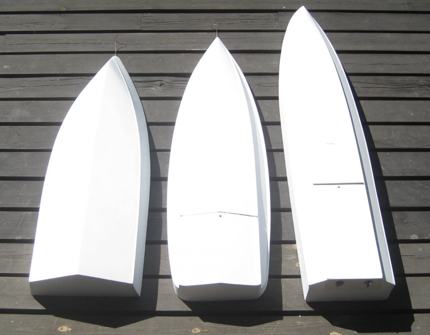

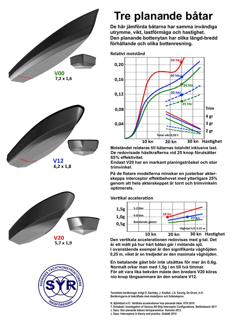

    Three planing boats
    The boats compared here have the same interior space, load capacity and speed.
    The planing bottom surface has different length-width ratios and different deadrises.
    The drag is related to the boats' total weight including payload. The reported horsepower at 25 knots assumes 65% efficiency.
    Only the V20 has a marked hump and a large trim angle.
    On the flatter models, the adjustable aftship interceptor reduces the power requirement by an additional 25% by keeping the entire aftship bottom dry and optimizing the trim angle.
    The vertical acceleration is reported with g-numbers. It is a measure of how hard the boat goes in the oncoming waves.
    In the above example, the significant wave height, h/3, is 0.25 m, which is one third of the maximum wave height.
    A paying guest should not be exposed to more than 0.6g.
    Normally you can handle 1.5g for one to two hours.
    To be just as comfortable, the V20 has to run nine knots slower than the narrower V12.
    Theoretical calculations according to D. Savitsky, J. Koelbel, J.A. De Groot and others.
    The calculations are confirmed with model tests and full-scale tests.
