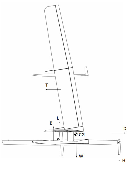

    Aren't they only going half way with the concept? (I don't mean this facetiously at all...) Wouldn't you be able to get both wings up in the air, control them separately and get twice the drive area? Looks like there are four separate control areas. It appears like each wing has an upper and lower section. Run three of them for drive and the fourth for balance. A kind of fixed wing biplane Moth on steroids.

    No, the lift on the other panels would have to go the opposite direction to produce drive. The way they've arranged it, the horizontal wing to leeward produces upward lift and opposes the heeling moment of the vertical wing. It also helps cancel the trailing vortex at the foot of the wing for reduced induced drag.
    The ideal case might be identical lift distributions on the two wings. Then there would be no net heeling moment and the net force would be along the bisector of the two wings. Of course, the wind conditions on the two wings will be quite different, and the spanwise lift distributions will be different.

    Tom, have you looked at the pitch stability information they posted? I'm struggling with how that is going to work. It looks more like a pitch instabilty system me?

    Randy, what do you see that leads to pitch instability? Maybe its staring me in the face and I don't see it?
    They say:
    " When the hulls are flying, the V-39 achieves longitudinal stability from a nose up pitching moment gained by a relatively forward centre of lift from the wing in ground effect and a relatively aft centre of gravity.
    A degree of water ballast will be present in the stern of the main hull to maintain an aft CG.
    Finally, the small hydrofoil at the base of the active rudder maintains the balance"

    First consider what would upset the vessel in pitch.
    The nose down pitch from thrust is balanced (literally) by the nose down pitch from the aft CG lever.
    What happens as the wind speed changes in gusts?
    Gust = greater trust = pitch down
    pitch down = CG forward as wing rotates forward on pitch axis reducing (over powering?) the stabilizing effect of the aft CG lever = more pitch down
    Pitch down = hull/fuselage frontal area increases forward of the CG = more pitch down
    As the vessel pitches down the stabilizing force of aft CG is reduced and each degree of down pitch increases the pitch down force. The pitch down forces are not linear, whist the stabilizing forces are. This requires active input.
    Now look at the CG placement and the location of the T foil. Both the trim weight water ballast and the T foil are off center. Any stability moment in pitch also produces a roll moment and a yaw moment.
    Now we have:
    Pitch down = need for pitch up correction
    Pitch up correction (down force from T foil) also adds windward roll and weather yaw (from greater drag induced from down force)
    Is the vessel sable in roll?
    The total lift is somewhere to leeward of the CG, if the vertical height of the thrust vector as shown in the side view is extended to the combined lift vector shown on the front view the thrust acts at a point to leeward of the CG.
    Gust = greater lift = windward roll + pitch down
    Windward roll = increase AoA on T foil = up force from T foil
    Upward force from T foil adds to pitch down.
    How about yaw?
    Gusts increase lift = pitch down + windward roll + weather yaw
    Weather yaw = greater speed at WIG tip as it rotates = increased windward roll ...
    I could spend more time trying to figure out if the vessel is stable on any axis but you get the idea.
