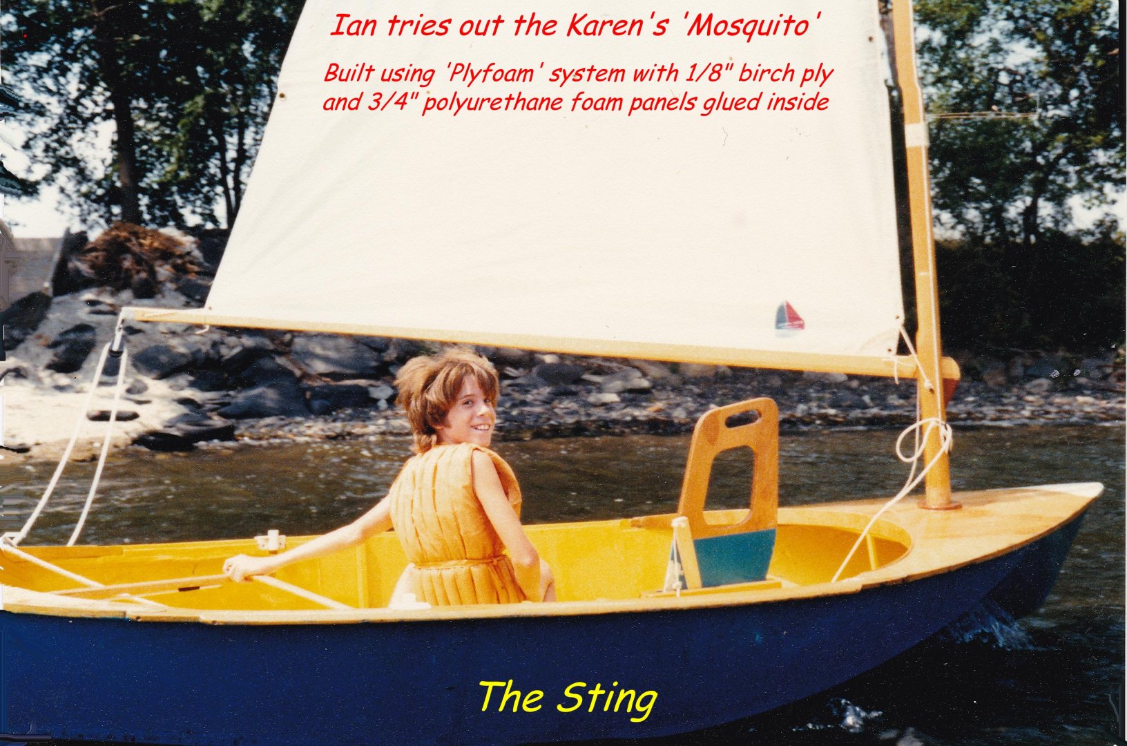

    First, from Tchamo "can foam and plywood be used together on a boat bottom?" Certainly.
    Back in 1970, as my daughter approached 12, she heard about my first boat at 12 and said she was up for trying to build one herself too. I already had some 9" x 40" offcuts of some dense polyurethane foam panels that had paper bonded to both sides and were 3/4" thick, so decided to try something that I nicknamed "Plifoam". The challenge was to create a nice little sailboat that was light and also simple enough to make that my daughter would be able to build most of it. The whole hull was first shaped (hydroconic) out of 1/8" birch plywood (sold for door panelling) using copper wire stitching with the joints (pre-epoxy) of polyester car filler and 3"wide matt tape just over the joints. With only two frames and a transom, it was very easy to twist everything. But we then bonded in strips of the PU foam using contact cement just to stiffen the interior, leaving the brown Kraft paper bonded to the inside. We then simply painted the whole thing, paper and all, and it came out pretty well.
    I did make the mast and boom for the boat and bought her a small gunter-rig sail to reward her effort.
    I called the design 'Mosquito' and she christened her boat 'The Sting' after the Paul Newman film.
    She learned to sail in that boat and had hours of fun, but just capsized it far too many times for it to last long (3 seasons) as water found its way between the foam blocks and could not dry out ...and as I said, there was no epoxy readily available then. The foam inside put the 3mm skin in tension when moving around the boat, and for 2 kids of 100lbs, it was fine. Even the thwarts were made of 3mm ply with foam bonded on top and they were strong enough, warm and comfortable as they soon shaped 'to suit'. See pic - yellow inside.
    7 years later my son also wanted to build a boat at 12. So I designed him a double chine MicMac canoe and he used the same construction, except that this time, we laid in one layer of glass cloth over the inside bottom foam, to seal it better. The upper sides stayed with only the 3mm ply but with an interior pine gunwale. The 15'6"canoe initially weighed barely 40 lbs and it lasted an astonishing 26 years with careful treatment. Even when I finally cut it up with a chainsaw, the joints of polyester and glass matt were still perfect. (Random glass-matt bonds to wood better than 90/90 boat cloth does but is heavier and requires more finishing).

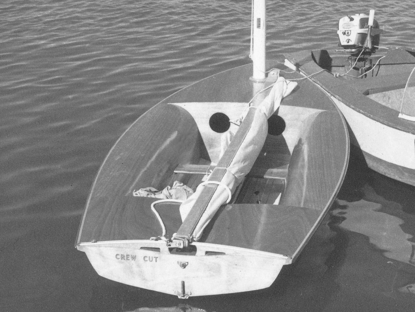

    So now to the Moth. In 1953, I participated in a once-in-a-lifetime dinghy race (200 boats) around the Isle of Wight (about 70 miles) to celebrate the Coronation of the Queen ..a high risk affair for the organizers as 1/2 of it was effectively in the Channel - Atlantic Ocean ! One of the top boats to finish was Coronet designed by John Westell .. a design that eventually spawned the 5-0-5. But I was very taken by the extended gunwale and decided to create a hard-chine Moth-boat with such an extension - one of the first in fact.
    As I was concerned about the strength, I kept this extension to about 5" each side, though later boats added more. The boat was called Flying Moth and eventually 26 Mk ll's and 2 Mk lll's were built. I managed a 2nd & 4th in a 1957 British Moth Championship and later heard that one finished 4th in the European Moth Championship around 1960, with this comment from the skipper "I was too slow on the downwind leg as compared to the newer 65lb boats, the boat was just too heavy at 100 lbs, but no one could touch me upwind. I was always 1st to the upwind mark, but sadly the races all finished downwind".
    So here are some pics of the Flying Moth .... the early one that was rediscovered and refinished recently .. ... plus a deck photo of the last one #28 that I called "Crew Cut"and rigged like a Finn.

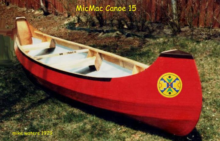

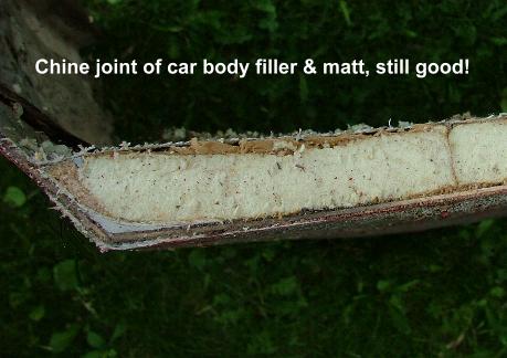

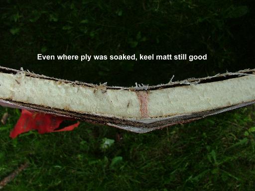

    And for those intrigued by the MicMac Canoe .. here's a pic ... and a section through the keel and the chine, when I cut the boat up due to rotten topsides, but after 26 years !
    The midship cross brace was just bolted-in for handling on to a car roof (it was once my sons favorite hockey stick;). The raised ends were original 'MicMac' style .... used for the canoe to rest on when tipped over on a beach for sleeping under. But they added too much windage for an open lake, so we lowered them after 2 seasons.
    I got a kick out of using birch ply for this boat, as the originals were of birch bark - all local wood in both cases ;)
    mike/
