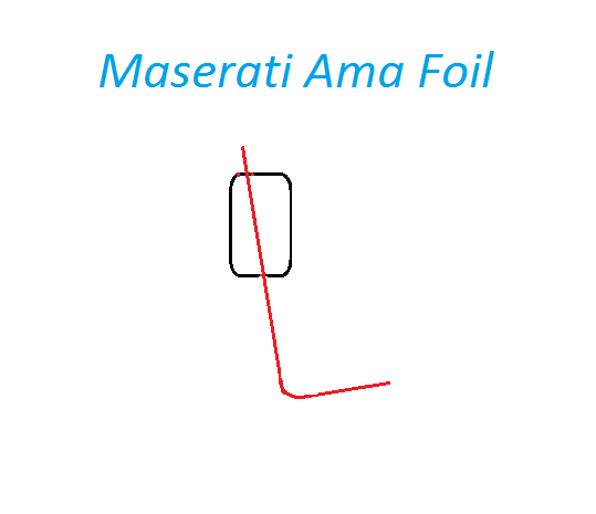

    Maserati's "uptip" foil
    The stb ama foil on Maserati's new foil configuration which is strikingly similar to the Fire Arrow Foil System is very interesting. They needed an uptip foil in the ama to take advantage of the intrinsic altitude control that foil can provide.
    But the ama trunk was angled quite a bit for the MOD 70 "C" foil normally used. So they built a foil that physically resembles a straight "L" foil. The cool thing is when the foil is installed in the angled trunk and deployed it functions like an uptip foil! A "normal" straight "L" foil would require very frequent rake adjustment to maintain altitude.
