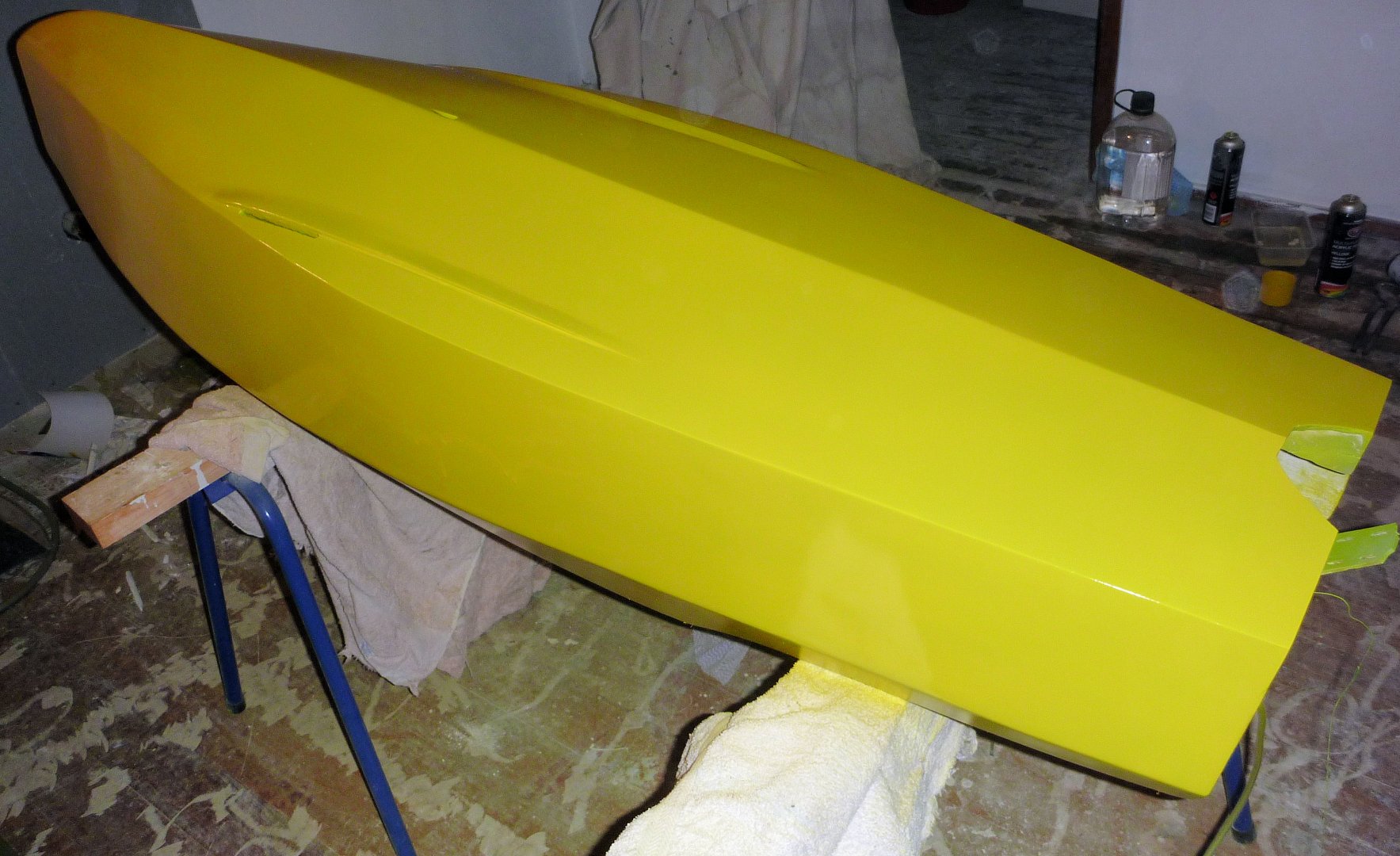

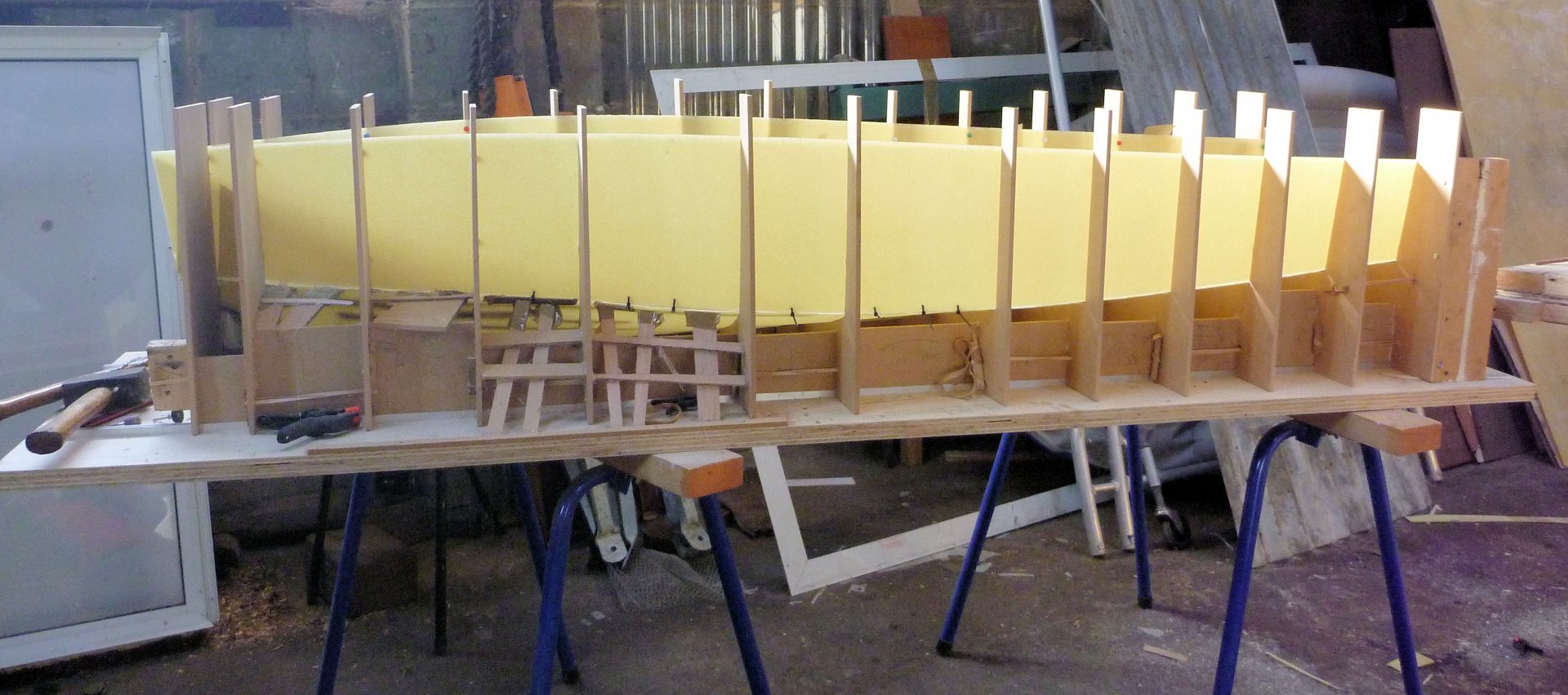

    Keeping the hull light to save batteries would be a helpful thing, but also a trick I eventually found to make the hull easily. Contact you local fiberglass shop, and buy a sheet of 4mm high density foam to build the hull from, before you glass it on the outside.
    Carbon fibre and other exotic material are a complete waste of time and money. All you need is some light glass material. If you put a layer on the inside and outside of the foam, you will end up with a hull you can almost stand on, and be the lightest possible.
    You can use quality automotive touch up paints and fillers to make the outside finish.
    Just for possible interest, I have attached a couple of photos of the build process, and a link to a Youtube Video showing remote control of a camera inside the boat that might give you some ideas.
    Have fun with the project, and good luck.

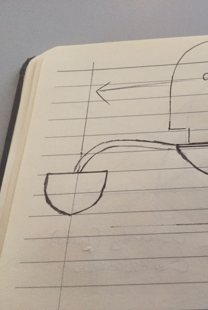

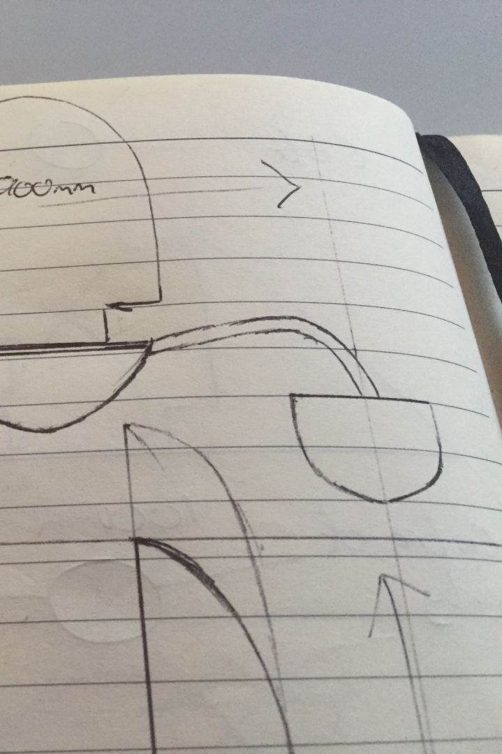

    Interesting, I'll look into that truss. It at least gives me a few ideas. I have been thinking lately how best to make the crossbeams, I've added a picture of one of my initial sketches. Obviously I could just bolt some carbon fibre rods across to attach the hulls, but I'd like it to have some sort of designed element in there. I mean the crossbeams will have a camera plate attached in the middle and thats where most of the weight will be, up to around 25kg, so it needs to be something fairly substantial.
    upload_2017-10-31_20-49-41.png [​IMG]

    You already have a 1m boat so some experience. What type of hull movement is best handled by this new bigger camera? Short jerky moves or long slow rolling motion?
    If the hulls are flat and full width at the DWL the draft is shallow but the boat is likely to bob strongly with small waves.
    If the hulls are narrow at the DWL the draft increases but is less susceptible to waves.
    With the CF truss you could easily create a modular camera mount.
