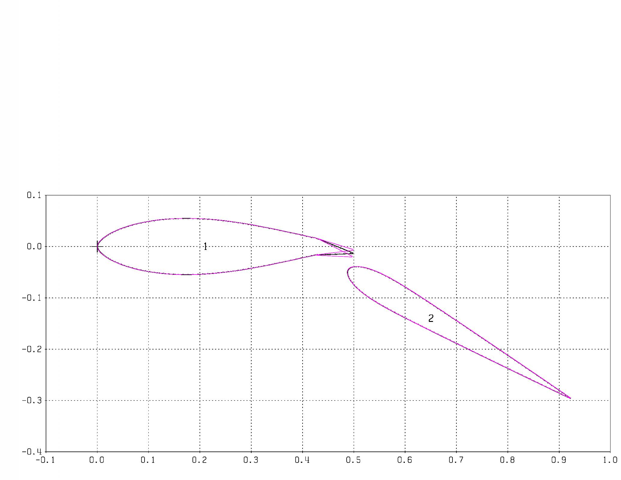

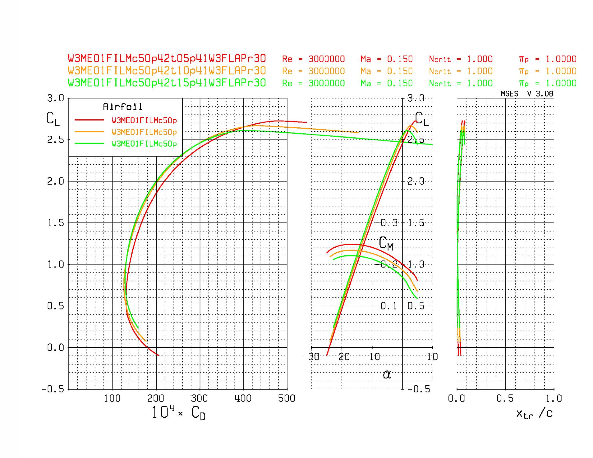

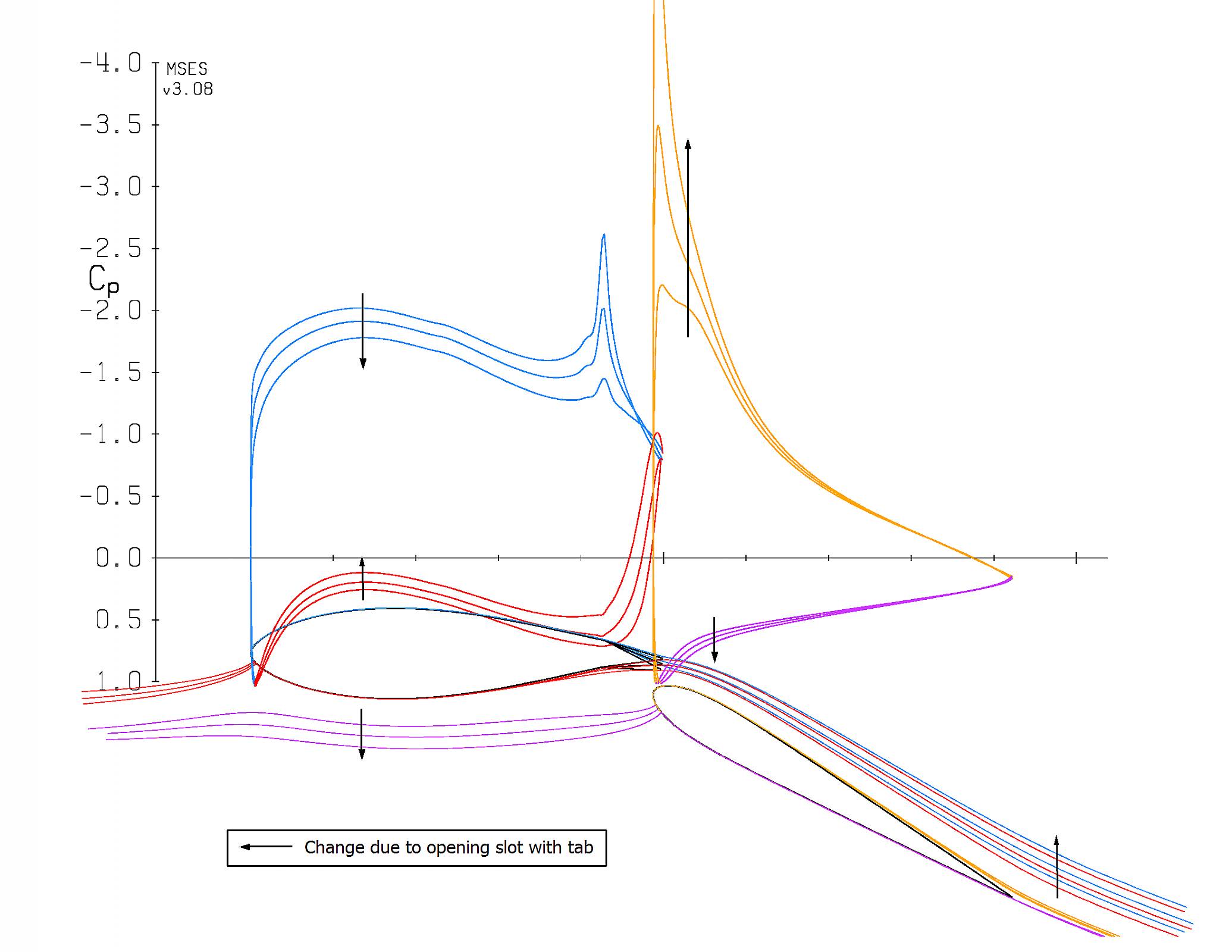

  3. tspeer
    Joined: Feb 2002
    Posts: 2,317
    tspeer Senior Member
    The tab does add camber to the main element. However, the flap is affected, too, and the net effect is not necessarily to increase the maximum lift.
    In the attached files, the first plot shows a section from an AC72 wing with 30 deg of flap deflection and tab deflections of 15, 10 (black), and 5 deg. The second plot shows what happens to the pressure distributions at -10 deg angle of attack (measured relative to the main element chord) as the tab deflection is varied. (The arrows show the direction of the trends with decreasing tab deflection.) The change in lift of the main element is offset by the change in lift on the leading edge of the flap, and there is only a very small net change in lift for most angles of attack.
    The lowering of the flap stagnation streamline as the slot is opened shows the increase in mass flow through the slot. There's very little change in the velocity at the main element trailing edge, and most of the effect on the flap takes place behind the main element trailing edge. So, other than the change in mass flow, the conditions in the slot itself are not affected very much by the change in tab deflection. However, the changes on the rest of the section are profound. The lift is changed almost uniformly over the main element. The main element stagnation point varies little, and the mass flow going to the lee of the main element is almost unchanged. There's a big change in the lift on the upper side of the flap where the flow is turned the most. This is due to the change in mass flow through the slot as opposed to flowing by the windward side of the flap. The net effect is the same turning of the flow for this flap deflection and angle of attack, but the details of where the flow is turned, and the development of the main element and flap boundary layers, are strongly affected by the tab.
    The corresponding polars in the third file show the variation with angle of attack for 5 (red), 10 (yellow), and 15 deg (green) tab deflection. The maximum lift is highest for the 5 deg tab deflection. However, the profile drag is higher for most of the angles of attack, making the 5 deg tab deflection less attractive. A tab deflection in the 10 - 15 deg range is probably the best compromise for overall performance for this wing.
    The trends in these results depend a great deal on the boundary layer development for this particular configuration. It's probably fair to say that increasing tab deflection will generally have the effect of increasing the lift on the main element and decreasing the lift on the flap. However, I don't think one can generalize the effects on maximum lift or profile drag. These will depend on how much the characteristics of the main element and flap change in opposite directions as the tab deflection is varied, and at what point flow separation begins.

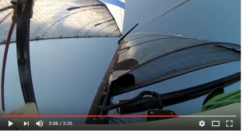

  4. schakel
    Joined: Jul 2008
    Posts: 366
    Likes: 12, Points: 18, Legacy Rep: 48
    Location: the netherlands
    schakel environmental project Msc
    Soft wing sails has the advantage of better handling in the harbor and the prevention of loss in case of capsizing with a hardwing sail. Not sure if these soft wing sails are as powerfull, but for cost reduction a soft wing sail might be an alternative.
    https://youtu.be/oNKajpNXb7g
