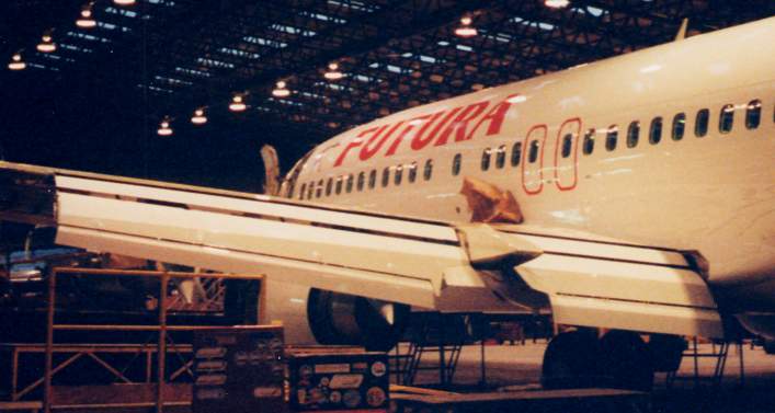

  13. petereng
    Joined: Jan 2008
    Posts: 581
    Likes: 22, Points: 28, Legacy Rep: 252
    Location: Gold Coast Australia
    petereng Senior Member
    The "fellow" explains how the trim tab works on the first element of the wing. A trim tab is used to either control the downstream airflow onto element two or to allow the teo elements to be closer together ie the tab allows the elements to cross in the tack. If you have rigid elements they can only be close enough to allow then to pass in the tack. If they overlap they produce more power. Look up cascading foils.
    The moth type control is not allowed in the AC class as the foils have to be manually controlled. cheers peter

  15. petereng
    Joined: Jan 2008
    Posts: 581
    No the idea is not to fill the gap. The two elements have independent airflows. The idea is to bend the air more. A single element can only bend air so far, before the element stalls or its flow unattaches. Look up cascade foils. Yes the tab can be slightly overlapped in this case as its soft. This gives the elements more overlap. The tab is used to control the airflow from element one to element two. The more you bend the air the more power you get. Look at F1 rear cascade foils they bend the air 90degs. Peter
    If you look at the take off on aircraft you will see they overlap quite a bit.
