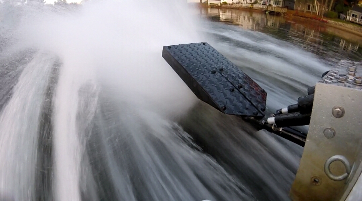

    I did a 10 HP electric outboard conversion. It worked well enough but didnt utilize all the motors potential because of the gear reduction. It did get the boat up to 8mph, but I was disappointed with it leaving so much unused potential.
    So, I built a steerable, trimable, sub/surface drive from scrap aluminum I had. Still a work in progress, but you may find it helpful to your project.
    Lots of Minn-kotas on my little lake but I have yet to see one do this.....
    Its a 48v system, me1004 pmdc motor 12hp continuous, 25 HP peak, alltrax spm 48-400 controller, and (2) 48v Chevy volt modules in parallel , 10.5x12 pin drive prop. It does 25 mph burning 13.7 kW. I've got a thread about it here. I do agree with everyone that you should invest in a prop. An 8" aluminum Long tail prop can be found for under $20, might work well in your application.

    Holy SxxT! And I thought -MY- little toy was cool!
    Is that a tach sensor on that coupling? Good for tuning the system, all I got is seat of the pants feel for RPM and an LED bargraph display on the inverter to judge the general range of current draw.
    I, am, impressed. Guess I'm not the only one fond of nailing kilowatts onto small boats, but mine is as rudimentary as it gets, that whole setup is very well developed. Nevermind shaft support, I went full-on primitive by just nailing the shaft onto the motor itself and betting the heavy oversize industrial bearings can take it. Lack of a thrust bearing would eventually show, but not for a long long time.
    I liked using the high voltage setup because it minimizes current handling at all stages except battery to inverter. As I read your build I was wondering about what kinds of currents you'd have to be pushing around at only 48V to develop that much more power than I'm stuffing in a kayak, but you're also rocking automotive hardware operating at a whole different scale.
    How bulky is the rest of the hardware, controller for instance but particularly the battery? I lucked out... my inverter and controller weigh about 2 lb and a half a pound respectively, don't bulk up much either.

    Thank you. Its a fun little boat, kinda like an aquatic golf cart. There is a tach sensor on the coupling, its very inexpensive, but quite useful. The controller can handle up to 460 amps. With the prop I have on now 10.5x12, it'll draw around 350 amps at 42-45 v and do 22-25 mph. The 9.25x10 prop draws around 250 amps at 44-46 v and does 20-22mph. The controller hooks to a laptop and gives me real time monitoring of throttle , battery volts and amps and motor volts and amps, controller temps, etc. It also logs a bunch of info to an excel file. I just haven't had much time to do anything with that.
    I have the controller, contactor and fuses mounted in the center console. Initially the battery lived there too, when the boat was sporting the converted outboard. After I installed the surface drive I moved the batteries in with the motor ( this can be seen in one of the videos, I'll also get some pictures). I also upgraded the wire terminations to better handle the higher amps of running a direct drive. Each battery weighs 43# and the controller and other hardware is only a few pounds. Its all very compact.
    I am no expert on boats but I would advise against going with the chain drive and instead stick with the longtail design and directly drive the shaft. Why add all that goes into chain drive when you don't need it? My suggestion would be to thru bolt an aluminum plate inside and outside sandwhiching your hull where the motor is mounted now. Add a fishing seat swivel base to give you steering , then attach motor to that. Nova jaws or similar to couple shaft to motor. Some form of thrust bearing, torque tube , another bearing near Long tail prop. But again I'm no boat expert, these are just my thoughts.
    I'd be willing to bet you'll do a version 3, once you start its hard to stop, always trying for more... I had said I was going to be happy and just enjoy the 8 mph outboard conversion.. About a week later I was building the surface drive......
