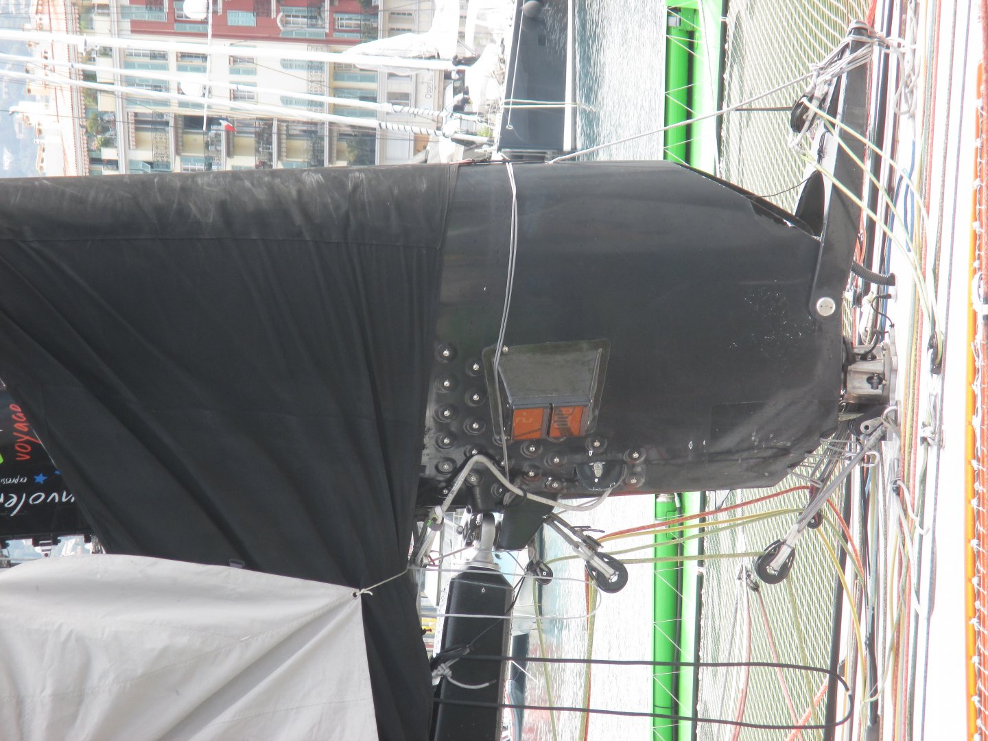

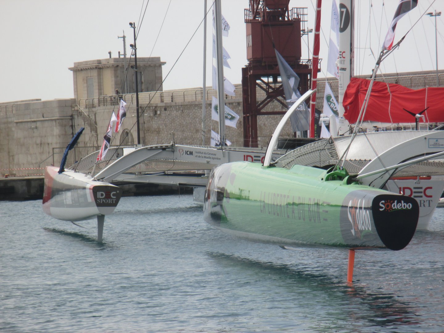

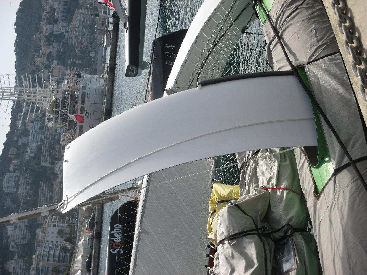

    Some photos that I took this morning from the quay open to the public : foot mast (very impressive), Sodebo foil (with what looks like a bumper on the leading edge, to prevent damage from a floating object ?), ... IMG_6353.JPG IMG_6371.JPG IMG_6341.JPG IMG_6343.JPG IMG_6359.JPG IMG_6367.JPG IMG_6369.JPG IMG_6380.JPG IMG_6347.JPG

    Great shots, Dolfiman!! Do any of the three appear to have a foil on the daggerboard? You are so lucky to be right there-have fun!

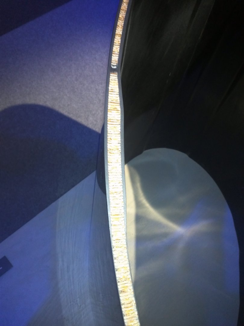

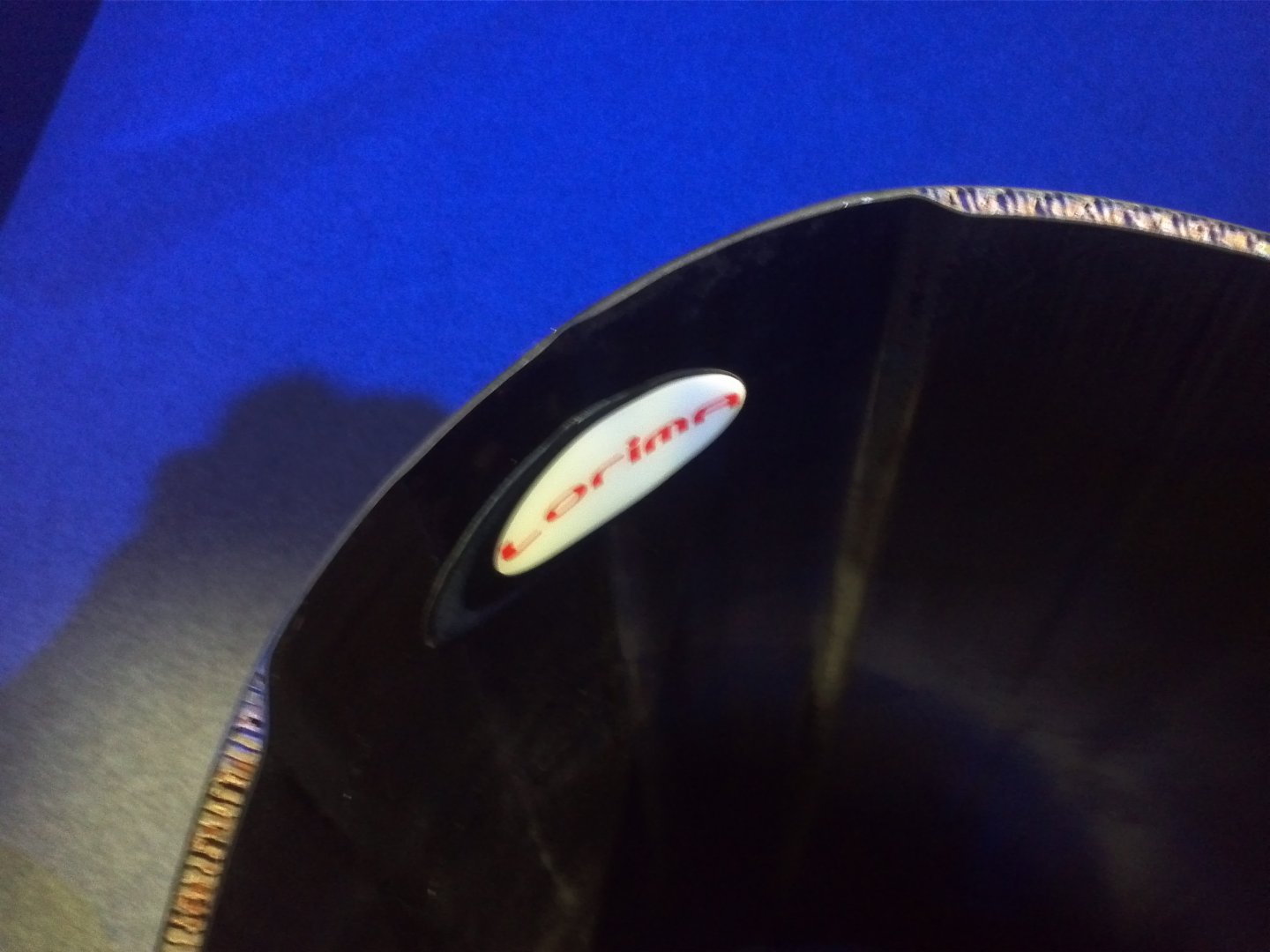

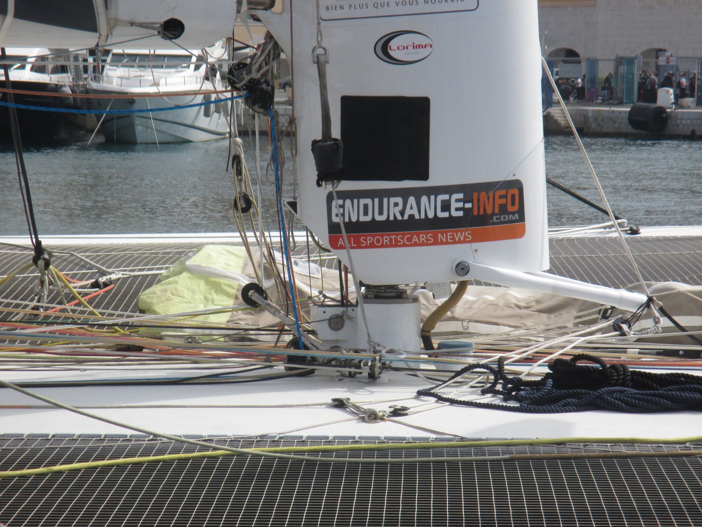

    I visited this morning the Ultims exhibition tent, took some technical photos, here attached, of :
    - Sodebo mast section (Chord 1,20m , Beam 0,60 m) height of the mast 35 m, weight ? : it is said 25 kg for this sample of about 1 m height, builder Lorima : LORIMA http://www.lorima-carbon-mast.com/en/index/
    - BP9 ama half section
    - BP9 data
    The building of a new mast is usually 4 months, it is this delay which is critical for the refit of BP9.
    I promote to the there people the idea of oceanic races with a stop at Sydney for example, as to NY last year, so to help extend the Ultim class to more international participation.
    Corley and Doug Lord like this.

    Dolfiman, great pictures above. I can't get over how thin the carbon part of the wall thickness is-that must be some incredible engineering!
