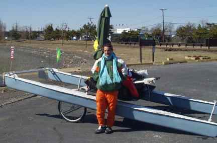

    After I do it solo once or twice, I'd like to do it with a crew and really push the sailing aspect for all it's worth, non-stop sailing. But without folding there's just much of a chance of towing the craft on the highway without getting run over by the logging trucks and casuing traffic problems. I could take the boat apart, but then that adds all kinds of other problems. The single rig would get in the way of my other features, hence the biplane rig. For the EC race I might go with a single rig though, as I'd not be using any of the ufc features. Randy Smyth for the NCC used a canoe paddle on his cat, but was going with the current, otherwise ...... well ....... but that was a different race, different course, different conditions ....
    see him doing it here:
    http://www.youtube.com/watch?v=ynszNTARLcw
