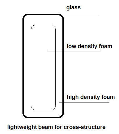

  10. TruckoftheSea
    Joined: Feb 2020
    Posts: 9
    Likes: 0, Points: 1
    Location: USA
    TruckoftheSea Junior Member
    cross section of lightweight beam for cross-structure
  11. gonzo
    Joined: Aug 2002
    Posts: 16,803
    Likes: 1,721, Points: 123, Legacy Rep: 2031
    Location: Milwaukee, WI
    gonzo Senior Member
    I don't understand what you are saying at all. What pressures are you referring to?
  12. TruckoftheSea
    Joined: Feb 2020
    Posts: 9
    Likes: 0, Points: 1
    Location: USA
    When your boat sits on the water it gets the pressure from all directions. When it move forward it has high pressure at bow and low pressure at stern. That longitudinal pressure is the big problem for your boat speeding forward. The longitudinal pressure is the problem so we care about the length to beam ratio. The big ship has large under water surface will get friction problem but the small one that isn't a big issue. So if we want to combat the monohull problem we have to reduce the longitudinal pressure between the bow and the stern. That's just the basic of boat science.
  13. Mr Efficiency
    Joined: Oct 2010
    Posts: 10,386
    Mr Efficiency Senior Member
    Trucker, that is pretty much mumbo-jumbo, with your project here it becomes a case of satisfactorily linking the two boats, powering the thing effectively (not easy to use outboards, even behind the two hulls, and more difficult if hung off the connecting span) and accepting what drag penalty will arise from having two fat boats so close together. Which was why I suggested scale modelling. That the waterways are not exactly awash with such "boats", might suggest it is not worth the trouble.

  15. gonzo
    Joined: Aug 2002
    Posts: 16,803
    gonzo Senior Member
    Pretty much it is all wrong.
