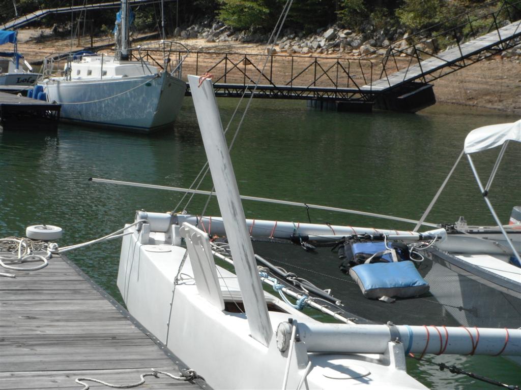

    offset boards
    Skip, I have a 24' tri that I have sort of used as a "test" subject, and I added float boards to see what would happen. I have a 19' beam, so they are pretty well "offset". The short story is that you can hardly tell which board/boards are in use. I only have a center rudder, the boat and rudder are very well balanced, and in most conditions the helm is quite light, even with only a single float board down. Of course if your tri flys the main hull, you would need float rudders.
    Don't over think control issues, a well designed tri can handle all sorts of odd rig and foil combinations and still be easy to sail.
    I do agree with the damage risks, tris have often been sailed with flooded main hulls, but flooding a float can be more critical.
    B

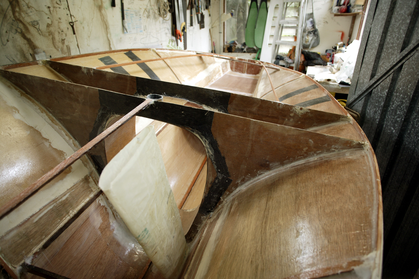

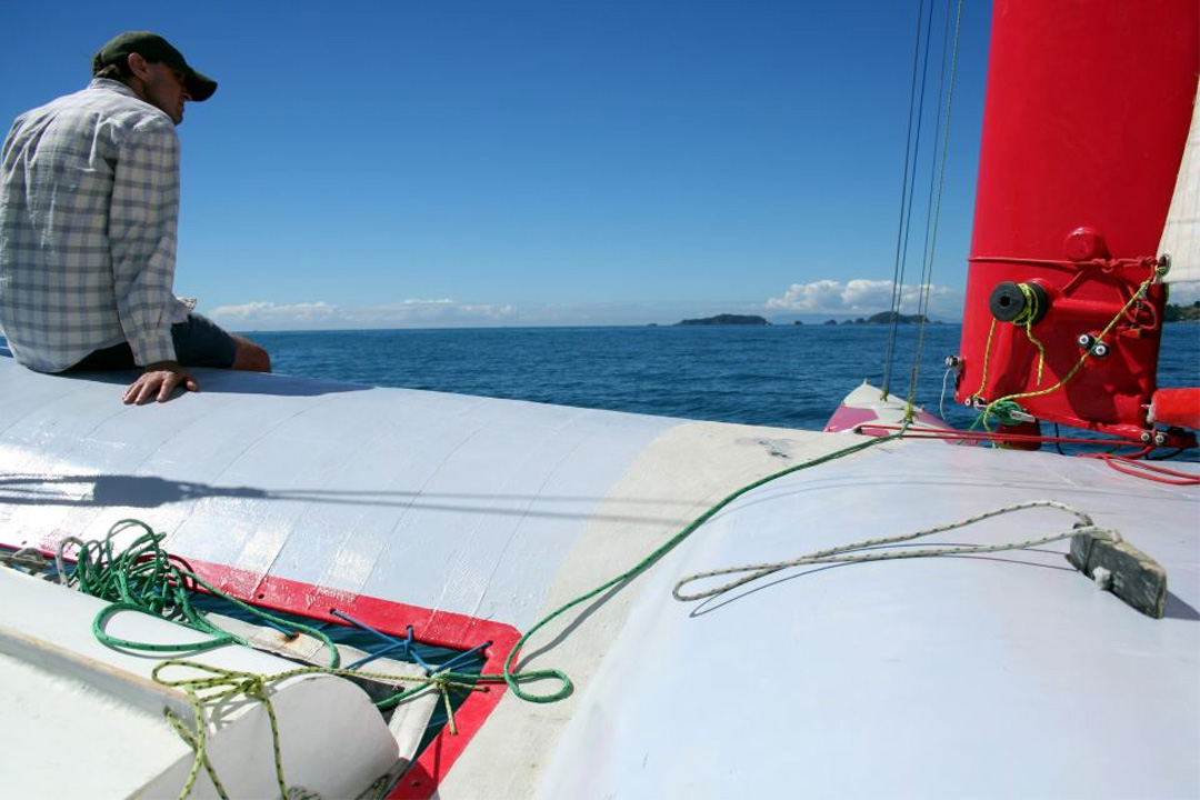

    Here's Groucho's offset main hull dagger - and also Sid 650's case being glassed in. Since Groucho goes to windward like a witch, I'm expecting the 6.5m to do the same.
