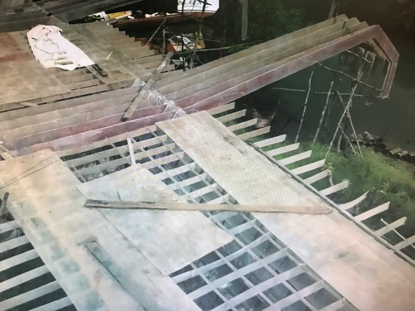

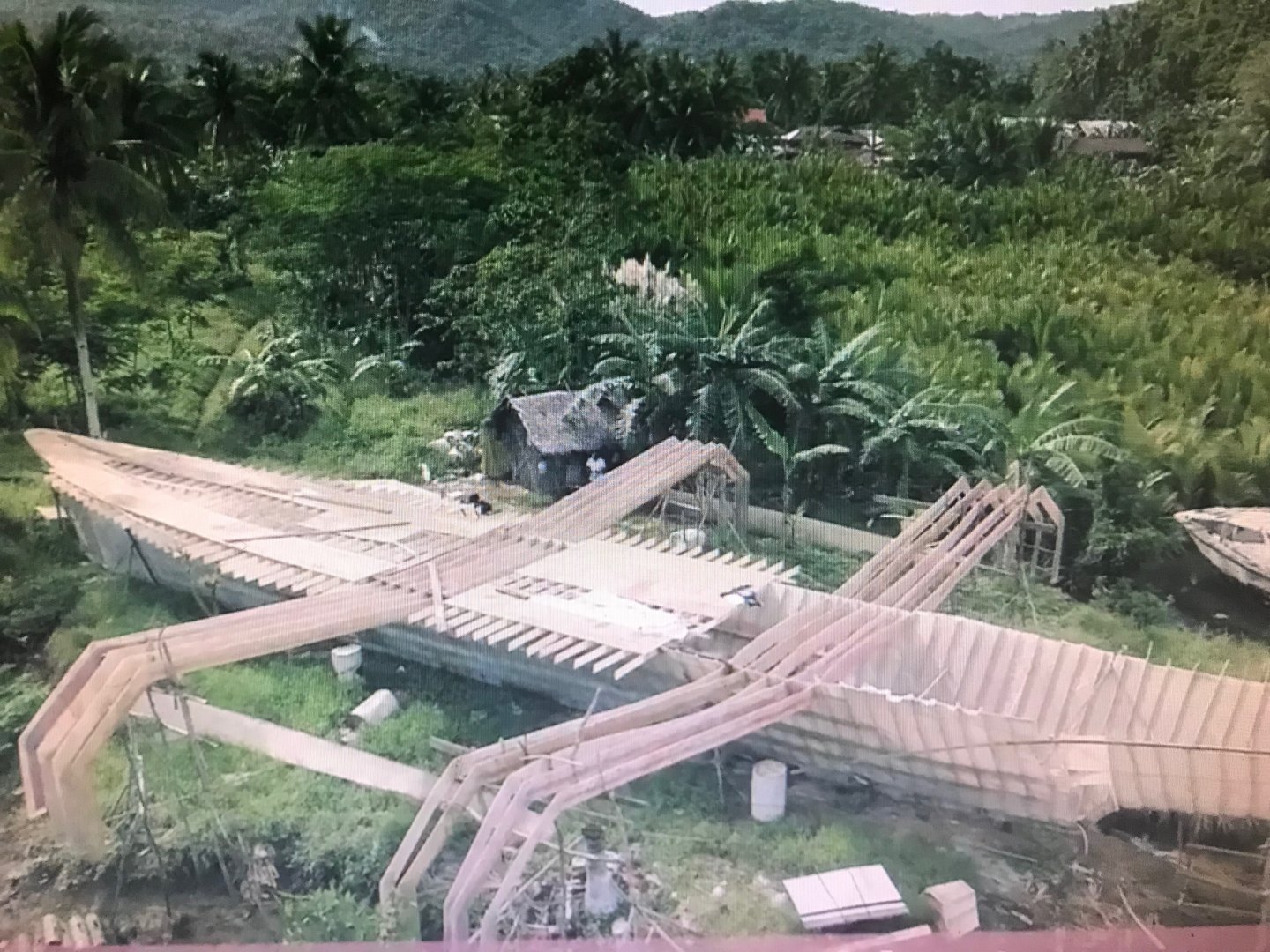

    Greetings everyone, we have recently started our build of a 36' Philippines Banca, our building is taking place on Santiago Island, 2nd largest of the 100 Islands Chain, PH.
    Banca boats are exceptionally stable due to the outrigger design, they have very low drag, which allows them to be fuel efficient. They are commonly powered by 16 hp Briggs and Stratton engine however we have opted to power this boat with a larger twin for longer and smoother running times.
    This Banca will be modified from standard design, it will have a slightly larger and more flat planing area for increased cruising speed and fuel efficiency.
    I will be posting progress photos and would be happy to answer any questions. Please enjoy!
    Build Specs:
    Single Main hull with 2 outriggers
    28' Solid wood Keel
    4' Bow
    4' Stern
    36' Total approx length
    Propulsion:
    30 HP Twin Cylinder - Kohler Command Pro (Gasoline)
    8' Stainless Shaft
    8" Long Tail Prop
    DAY 1-2 (Hand carved Keel)

    Build Day 3-4
    Build Day 3-4
