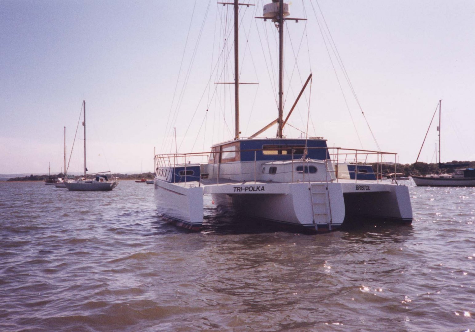

    She was built in Bristol but a Polish guy who did a superb job. She was called Tripolka. She was made of cold moulded mahogany with WEST resin and sheathed throughout. With this and her box-girder main beams she was immensely strong. He extended it by 3 feet to make the toilets a 'reasonable size'. She was way over her designed weight but she looks much heavier in your pictures as the transom should not be underwater. When we bought her she was quite dilapidated so we spent some time doing her up before packing the whole family on board and sailing away from the UK in 1991. We changed her name to Azania. I extended the main mast by 10 feet to increase the sail area and we bought new standing rigging and sails. The mizzen sail was useless. On out first long trip from Plymouth to La Coruna she averaged 7 knots. We normally averaged 5.5 to 7.5 knots so she was not fast, but was huge inside and a great livaboard. With a single prop and a 45hp engine she was a real handful in marinas. We sold her in southern Spain and she became a dolphin day charter boat, renamed again to Splash II. Her are some pictures from the early 90s.

    Great Stuff David, the Voyager was the only Nicol with the box girder beams for the anticipated loading. As to the pictures with the transom under the temptation to load something the size of a ship like a ship can be hard to resist, they have to be light to fly. I'll try to sneak in a picture of a Voyager at speed from the old Harris book. I wondered about the tall mast, interesting to hear the story behind it.

    The owner builder told me that he built the cross beams and wanted to test them. So he put the beams across 2 supports and craned a farm tractor onto the middle. The 24 foot beams deflected just one millimetre! They were a pain to duck under but there was not a single stress crack in the entire boat. Unlike some of the GRP cats I have owned since.

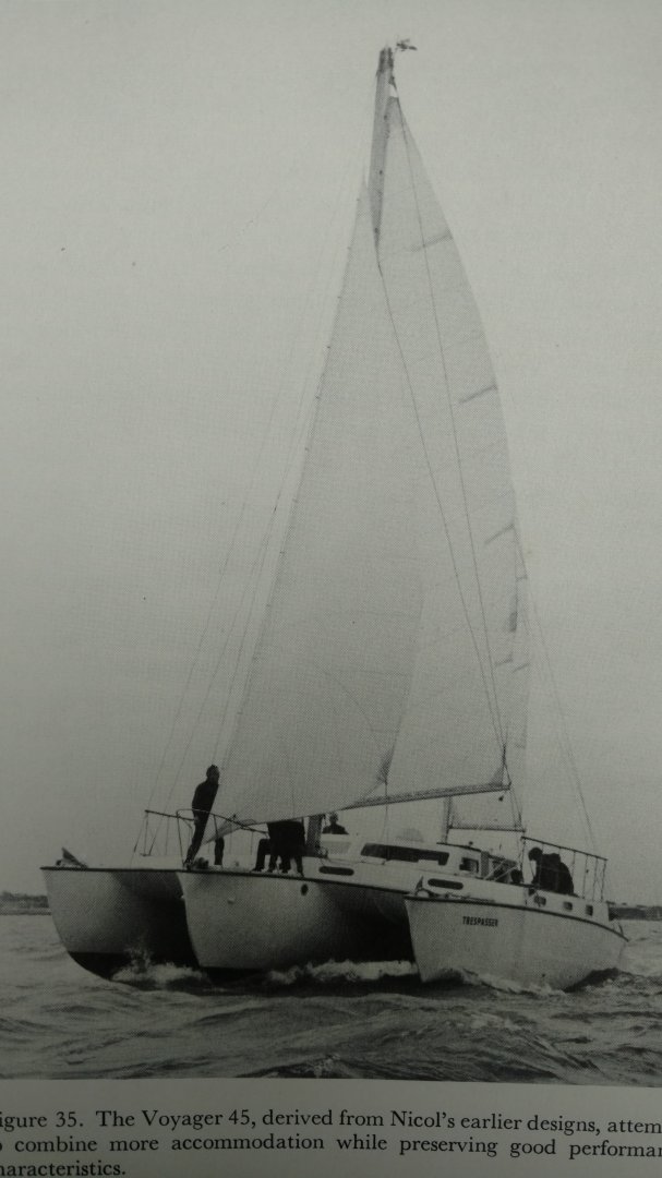

    Here is the old photo of a Voyager at speed, not a great reproduction but you get the idea. While the boat has a large side profile the business end doesn't have a lot of resistance.

    Cav, was the Voyager 45'?
