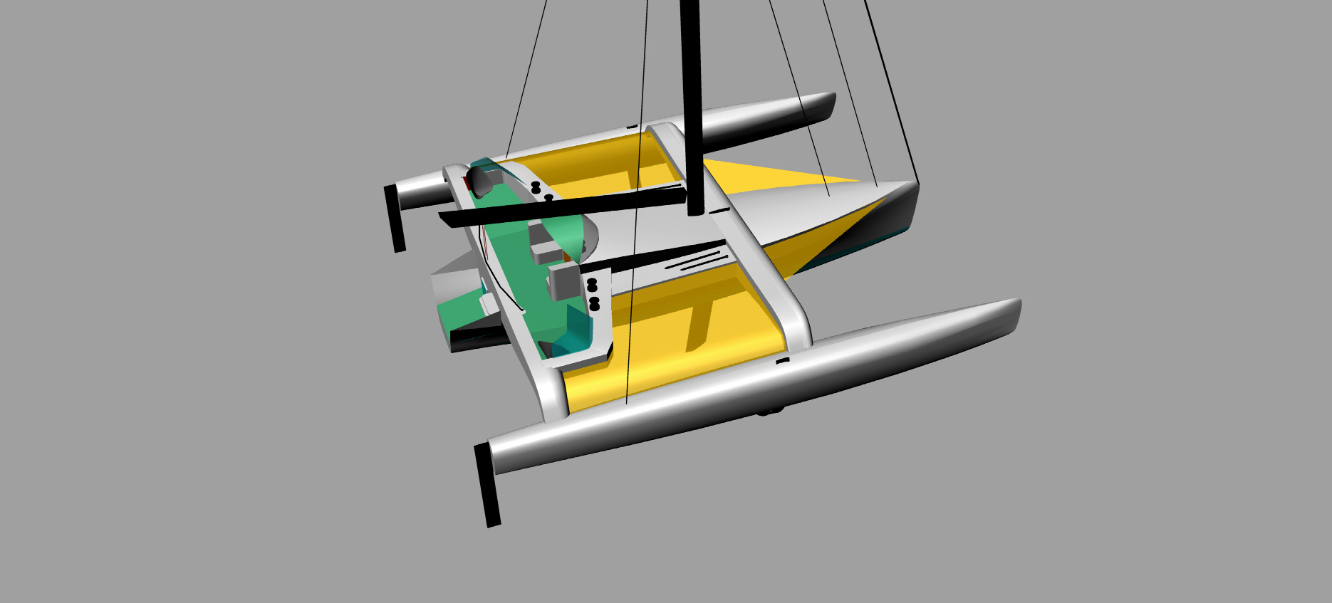

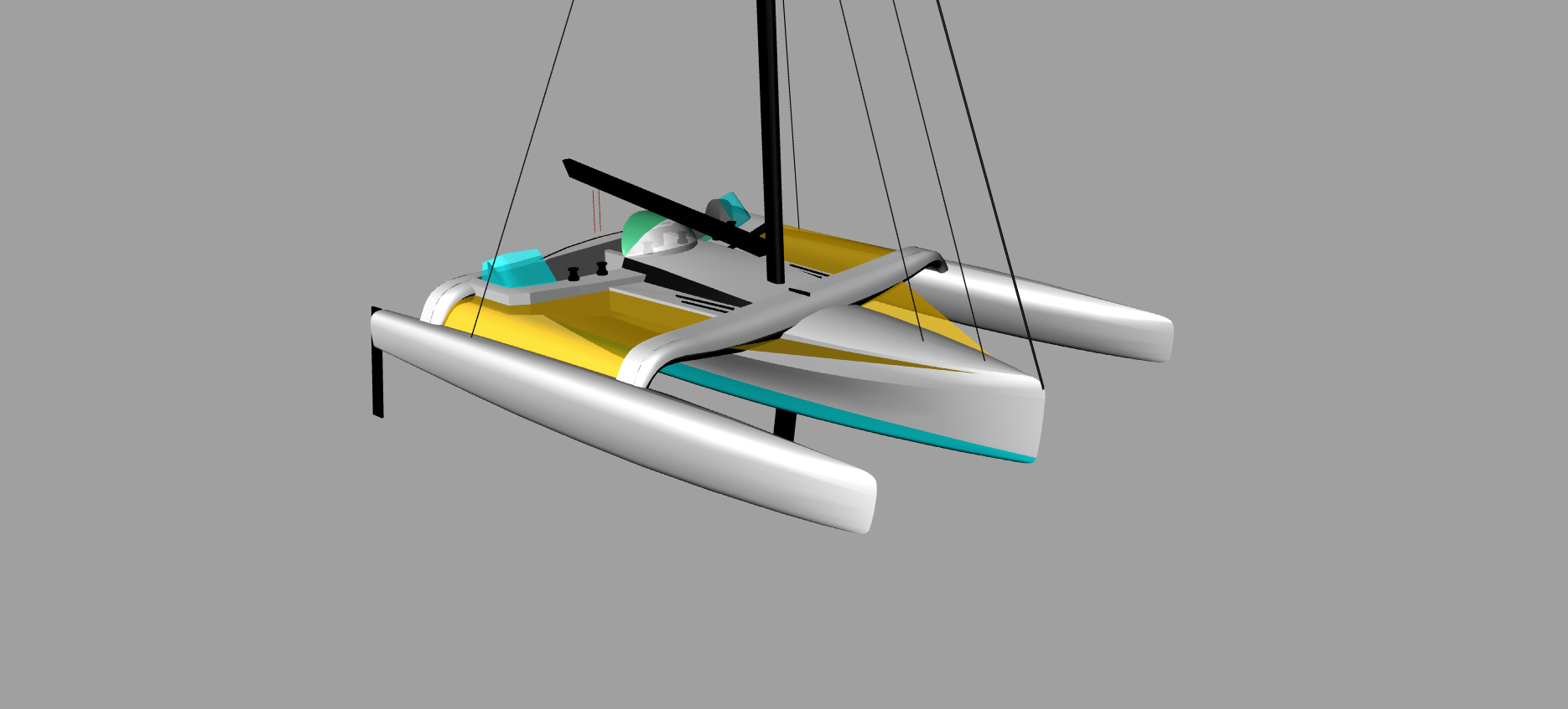

  12. kerosene
    Joined: Jul 2006
    Posts: 1,298
    Likes: 210, Points: 63, Legacy Rep: 358
    Location: finland
    kerosene Senior Member
    I get Rick's record breaking boats and read that thread when Rick was still a member. I think he indeed has done a tremendous job but my goal is bit more universally usable "camp cruiser" where I can have a kid on board, or maybe he is pedaling in a few years while I make sandwiches on the fwd seat...
    And the biggest obstacle for me is not getting things done. Too many commitments outside of leisure. So commercial pedal unit, even if it means 10% efficiency loss, is much more appealing than a super efficient custom dream on a drawing table.
    the boat itself is TBD but current design I have been playing with is a "5 panel" hard chine plywood boat a little less than 20ft.
    We have 3 meter by 1.5 meter plywood sheets so bit under "two sheets" long.
    And outriggers to keep it upright as waterline beam should be narrow and there are no oars or paddles to balance with.
    Lakes and rivers and maybe small ventures on the semi sheltered coast/archipelago around here.

  15. BlueBell
    Joined: May 2017
    Posts: 3,424
    Likes: 1,306, Points: 113
    Location: Victoria BC Canada
    Kerosene,
    Nice sketch.
    You can get away with way smaller pontoons.
    Keep them long but leave room to paddle with a kayak paddle.
    The cross training versatility is optimal.
    The blade should be out of the water by the time it reaches your hip.
    6 or 7 to 1 ratio is preferred.
    Rick W has done all this before.
