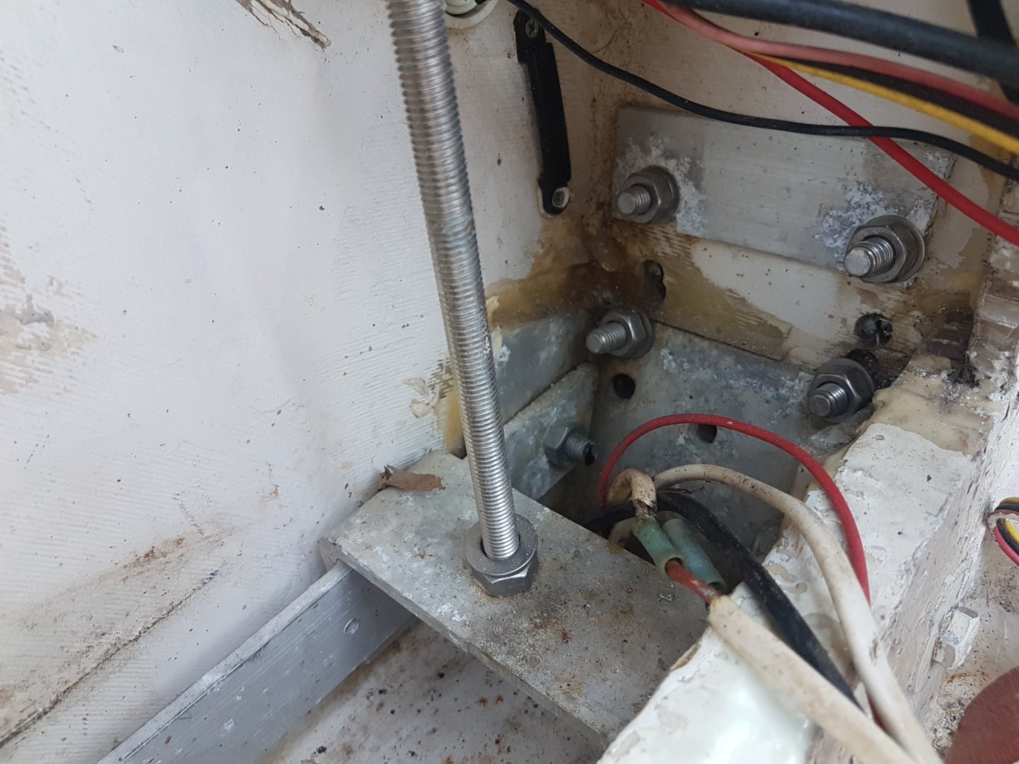

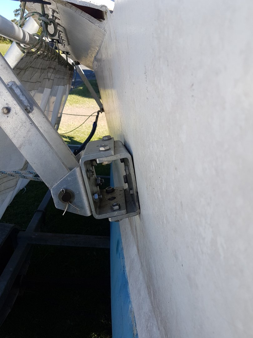

    Hi, i just joined the forum, hoping you guys could help me out.
    I recently bought a custom (home built) 21 foot trimaran based on a Mystere 6.0 catamaran (very similar to a tornado i believe). 9.5m mast, 5.2m beam. The main hull and folding mech is about 7yrs old.
    It's in need of a fair bit of tlc, but one thing which concerns me is the folding mechanism attachment to the main hull. It looks like the main forward attachment points are not in great condition. The lower side is compressing the hull laminate and the top is separating from the hull with some minor cracking.
    It is thru bolted to aluminium backing plates on the inside of the hull.
    There are small struts bolted onto the lower backing plate to transfer load to the opposite side of the hull. The upper backing plate is unsupported..
    Is this a normal way to distribute load in a folding trimaran?
    I was thinking about replacing the internal struts and backing plates with a single rigid beam which both upper and lower bolts are attached to?
    The hull is made from polycore, a polypropylene honeycomb, with epoxy/glass inside and out.

    Yes it is strange, it is like the work was done reasonably well but missed 50% of the point of having the internal brace, very odd, probably just wanted to use it, sick of working on it.. Be careful with your stainless/ aluminium, delrin washers and marine grease/lanolin help.

    Seems that Fandango has understood your arrangement better than I ;) Would you have a photo looking from forward back on to the folding system with the ama out? Then we can determine how the loads are applied.
    For sure, you cannot securely attach something bolted through a honeycomb without making the core solid at that point.
    If this is a Farrier-style linkage, the inner upper aka will be working mostly in tension or compression and the deck can be designed to take this with some form of beam at the connection point. Under the most critical condition, the lower arm will try to pull out from the shell on the leeward (in the water) side, based on the maximum buoyancy* that the ama has, while that same lower arm on the windward side, will press into the shell based on a maximum load of the weight of the ama plus all the crew weight that you may add on that ama. While the sail load will help to support this (via the tight windward shroud), its best to calculate the strength needed by the arms and their connections from the full max. loading I've noted. Outboard of the linkage, the aka will act in bending as a cantilever .. again based on the maximum loads indicated above. The lower link will generally need a solid cross connection through the main hull, from side to side ... again with any core material replaced with something solid. Even for a small boat like this, I would add extra strength with a safety factor of around 2, with more for a larger boat.

    I think the rigid beam mod would be wise. I’d also increase the surface area of the outer plate to the hull to help spread the load over that area which has probably been weakened.
    On the Farrier boats the connection points for the folding system have a lot of shape built into them for strength. They don’t just connect to a flat surface, the hull has been molded to accommodate the mounting so as to not create a stress point.

    Although trailers are often responsible for damage to main hull bottoms when rollers are used instead of bunk boards, I rather doubt this is the case for the amas, unless they are suspended loose and are free to jump around on bumps. The folding arms should be more than amply strong enough to carry dry ama weight in any position. But amas should be lashed to avoid shock loads from jumping around loose while on the road. Heavy duty shockcords are better than chains IMHO if attached to your folding arm brackets when on the trailer as the main hull should have its own separate lashing straps.
    My first concern would be to check to see that the honeycomb was removed in way of any bolted attachment, as otherwise loads (both sailing and trailing) could have damaged that area and permit movement that should not be there.
    As I pointed out in my earlier post, the forward beam takes a high proportion of the load at sea, so this might explain why the forward one is more in need of repair than the aft one. It's good to consider all the load options to figure out the real cause of the problem as then you can personally find the best solution. Good luck with this.

    One of the major differences about this boats folding mechanism that likely isn’t Farrier designed is how and where the system mounts to the hull. The rest of the mechanism looks very similar to a Tramp. But on the tramp hull, the large cabin with its bench seats extends wider than the rest of the hull above the water line to create a wide cockpit beam. So on a Tramp, that lower attachment bracket is actually up under the wing coming off at a right angle and not bolted flush to the side of a hull, so it acts more as a guide during extension and articulation where as on the OP boat, the lower mount may be pulling and pushing on the skin of the hull as it’s forced to support weight until the Akas are bolted.
    Don’t get me wrong, your boat looks like a lot of fun and I think with a little fabrication work you’ll get it sorted. After all, I am kinda biased about Farrier’s folding system.
    When you think about it from a mechanical design point of view, it’s pretty incredible how easy and strong the system is, but what is more amazing is that boats like mine are now 35+ years old and have been folded and unfolded countless times over the decades, and most of them have probably never had the system serviced. How many other mechanical systems can you say have stood that kind of test of time on a boat?
