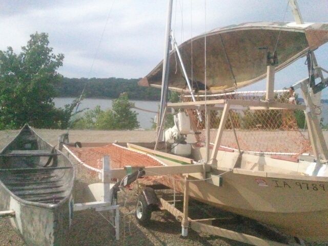

    trimaran power boat conversion
    I live in Iowa and sail on a similar lake. I did what your contemplating. I am a welder by trade and have a very small work space. My main goal was to have a trimaran hull wide enough to sleep on. With a small enclosure. And fit in my garage for construction. I have blogged it on this site.
    Most of the purists here have more cash invested in their boats paint job. Than the cost of my entire boat.
    It helps to have a heated garage to spend the winter.
    My 14.5' fishing boat is attached to a 18' sol cat catamaran. Aft masted and non typical. It will function as a sail boat. But not as a high performance super tri.
    It requires an engineering mind. As their will be things that cause problems. Double the safe working load.
    I started out with 1.5" electrical tube for a 14.5' mast. I Have a $ 50.00 a Hobe cat mast now.

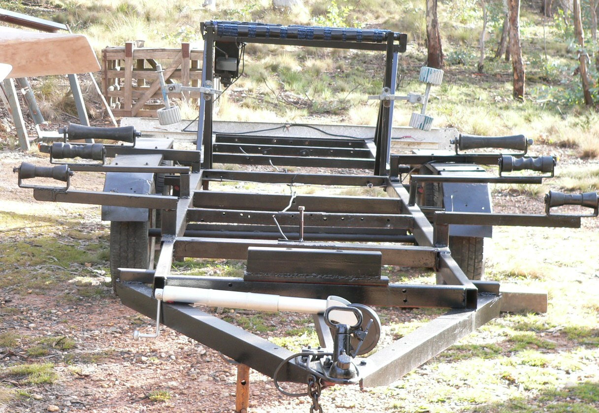

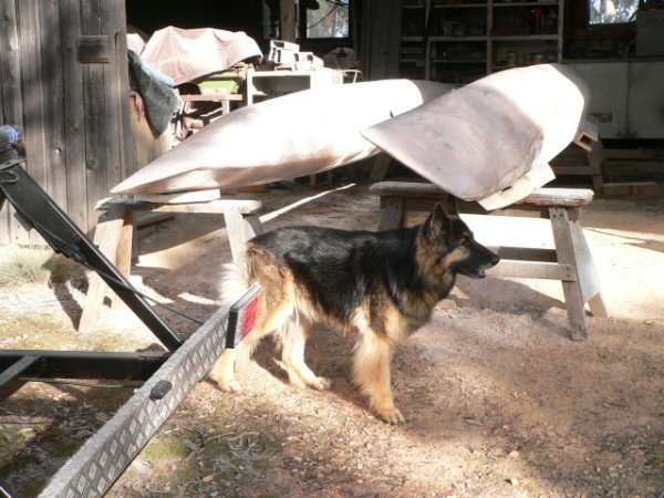

    The only problem I have with a trimaran is the complication of the centre hull being fitted onto a trailer, unless overall beam is very small or the amas are folded. Additionally, you get more accommodation on a cat of the same width, with a more usable cockpit too.
    I guess I had the advantage (if you can call it that) of having lots of bits recovered from my trashed and torched trimaran, including the hulls and rig. The centre hull was completely destroyed.
    Here is a picture of the new trailer custom built to take the hulls on rollers outboard of the trailer wheels. The raised rollers support fore and aft stringers bolted and epoxied to the lateral beams under the deck. The other picture is the hulls after repair - now being faired under the direction of the Quality Control Manager!
    Mark - I envy your heated garage. My shed is pretty open and the temperature has already dropped to -4C overnight and the epoxy is taking days to harden

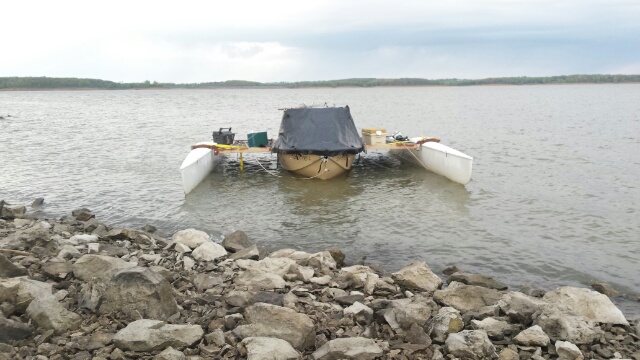

    16' foot wide cat would be great.
    My old canoe cat was 10 foot wide overall. It sailed well but it had too low of clearance for the waves if loaded for camping. Kind of scary with 8" inches of free board in 2 foot waves. The bilge pumps ran alot.
    I like the ease of wood working but rot and delamination from thaw frost action in the cold winter. Keep me from that method.
    My current center hull is also able to drop the out riggers and be a simple fishing boat. Nice in the fall and early spring when it's too cold to go sailing, but the walleye are biting in the river.

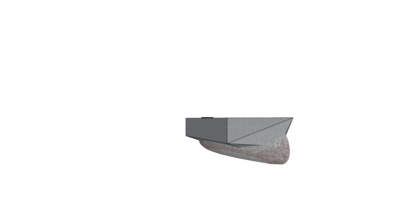

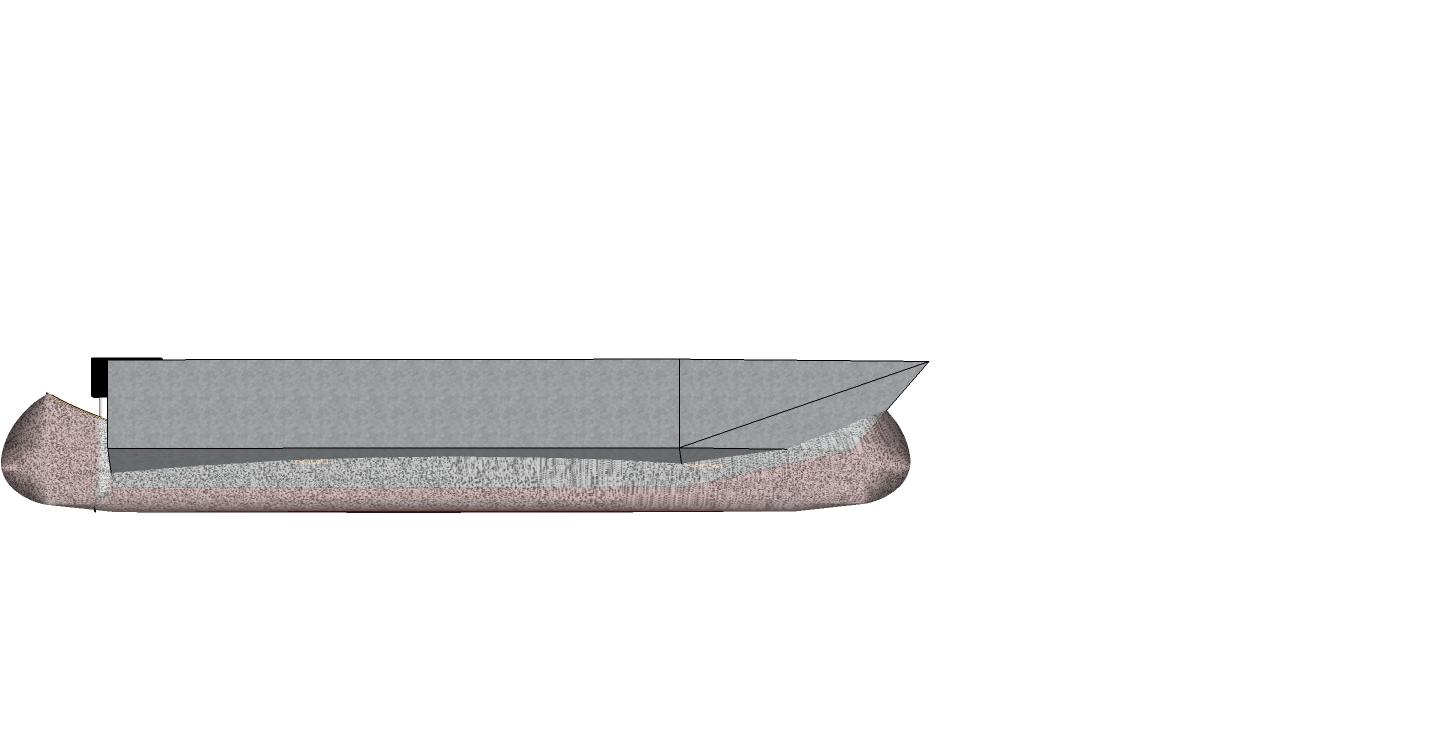

    Looks like a fun toy. I think it's really apples and oranges here compared to using a big heavy fiberglass boat and a small aluminum fishing boat though. The small fishing boat isn't a terrible choice. It's light, it planes, and did I mention it's light? The 3,000lb fishing boat isn't going to be very easily driven through the water.
    Merging an aluminum canoe and your fishing boat would result in a pretty darn close replication of small trimaran designs - and could be pretty cheap as well.
  11. rcnesneg
    Joined: Sep 2013
    Posts: 456
    Likes: 6, Points: 0, Legacy Rep: 58
    Location: Utah
    rcnesneg Senior Member
    Not quite, a canoe has a completely different shape, If you chop off the rear third of the canoe, give it a flat back end, and extend the bow about a third of the length of the boat to be long and narrow, yes you're replicating small trimaran designs.

    Great for a french fur trapper
    I gained 2 mph in hull speed by replacing with 18' sol cat hulls.
