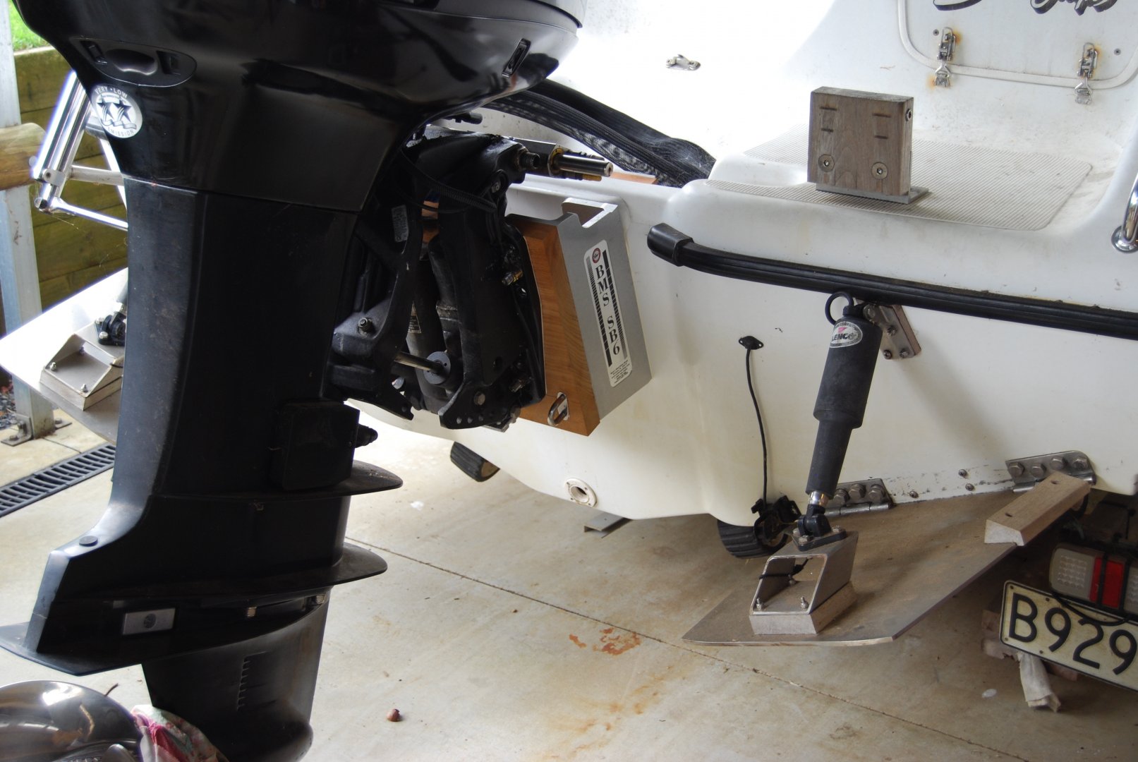

    Hi there just my 50 cents on trim tabs. I have a 21ft fibreglass 21deg deadrise 200hp opti weight 2 ton. Bought new 13 years ago and bought a set of Lenco tabs for her. They worked but the drag curve versus effect was huge so I cut the 30cm x 15cm plates off mounted 30cm x 30cm plates on and mounted the ram further aft so the end of the tab still only went down 7cm. The tab now being twice as long and going down the same distance meant the angle to the relative water flow was halved. The difference was massive, more effect and way less drag. Couple of years latter I cut the whole lot off and made my 3rd set of tabs 38cm w x 46cm L, I have never looked back. The most efficient lift to drag angle is 3 to 4 deg.

    Hi Blazer,
    I think you have rediscovered something that has been known for quite a while. A longer trim tab will have a lower trim angle for less drag and greater efficiency. If this "trim tab" is incorporated into the aft hull bottom, it can be very long and have a very low trim angle relative to the aft buttock lines. Just what the optimum length and angle is depends on the rest of the design and its intended use.

    I see so many boats that I believe are under tabed ie tabs are way too small. I think companies who sell tabs dont tell the truth. My friends look at my trim tabs and laugh, say oh my lord look at the size of them. To me they look perfect because of how they work. A tiny tab will work fine at high speed but it was low speed effect that I was after. My boat now planes at 11 kts, I can set a small amount of power where the bow points at the sky and it sits well in the hole then put both tabs full down, the bow comes down and shes up on the plane, lift the tabs and she sits back in the hole. Most of the time I sit on 25 kts when traveling, the effect versus drag is near perfect.
