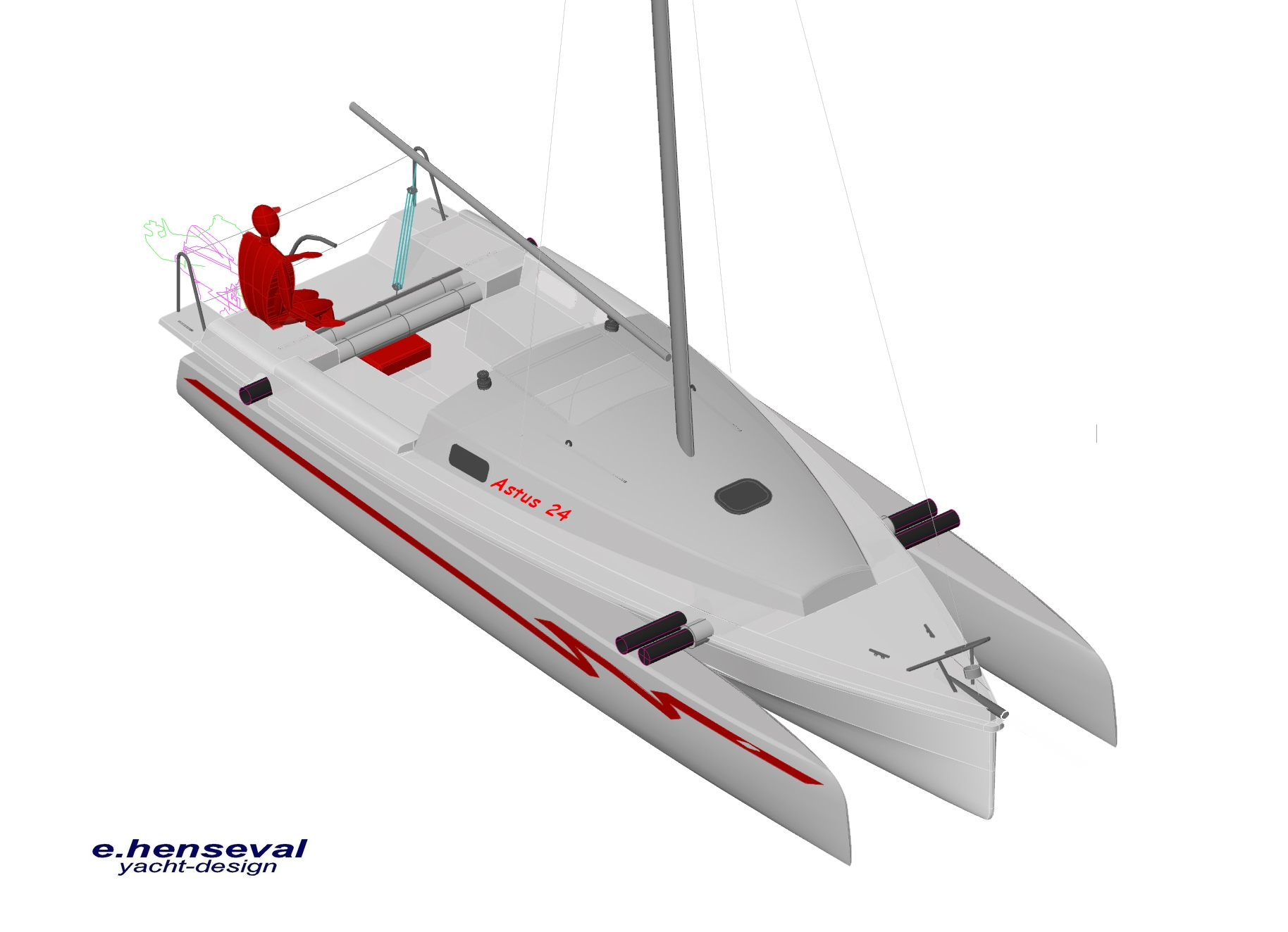

    It is rumored that Astus uses Teflon rings in the tubes to ease the sliding. Reports about the very first Astus boats (without Teflon rings?) mention the use of lots of salad oil. I could not find any reports about sliding problems on the french forums. What is your opinion? How easy would it be to clean the insides when sliding gets difficult or the tubes get stuck?

    To me i see each beam reduction approach having their own limitations in overall beam.
    I wonder if it would be possible to use strips of teflon tape length wise.

    I'm using a a sliding mechanism for a new trimaran I'm building. The tubes are both aluminum and have .026 inches of clearance. I found one spot in one of the tubes that does not telescope well, but I have removed it - fortunately it was near the end and I didn't need it.
    The size that fits is 4" schedule 40 pipe outside of 4" OD tube. The 4" nominal sch. 40 pipe is 4.026 ID and 4.5" OD. And both are common enough I can buy them off the shelf at my local supplier for about $100USD per 20' section. My system is unstayed and will use outer tube sections that are removed for transportation, but when inserted, to all the way to the boat's center line, and are 8' long. This is an 18' trimaran with 16' beam. If I find it too flexy, I'll go ahead and add some water stays. The internal structure is easy to work with in that respect as I kept access to the areas I would need to add some reinforcement for the water stay tangs. It's possible that I may just build them in now just in case.
    the limitation of the Astus mechanism is of course the width max. it is a very nice system for small trimarans and I could have done it with mine. With my system it becomes modular - I can make it as wide as I want. I can have multiple float sets (I already have 3 sets of floats I'll be experimenting with) - so I can put lifting foils in one set, have a high volume set, or whatever I want to change out there at the float. There's a lot of advantages for a tinkerer lime myself to having the floats be modular and easily removable.
    The other most important aspect is that for winter storage, I can pull the floats off easily, stack on top, and put the boat sideways in front of my cars and it all fits in my garage. This a concern specific to me and my situation, but it works for me.
    With respect to sliding, I've found that as long as the tubes remain clean, they telescope very nicely with just a little bit of lubrication. I use vaseline - mostly because I keep a tub of it on my welder for use welding and it was handy.
    I think for final assembly I'll use a different lubricant. Not sure what yet, but something that won't collect dust is going to be a big necessity. Maybe just graphite powder?
