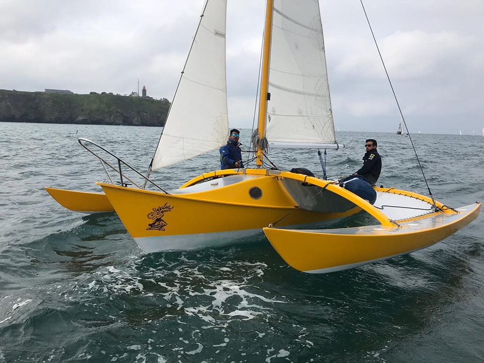

  4. SolGato
    Joined: May 2019
    Posts: 89
    Likes: 47, Points: 18
    Location: Kauai
    SolGato Junior Member
    Here one photo I found doing a general search that was posted on a thread about Tremolinos. It’s a more modern take on the design but does use Amas with straight beams that pass through the hull.
    I couldn’t find any info about using shorter hulls like H14, or the newer plastic Hobie hulls. I’m thinking nobody has adapted the plastic hulls because they are expensive and most boats of plastic construction are still in use.
    Of course, one could also consider using a pair of Hobie Getaway hulls which use the same straight beam thru hull setup but measure 16’7” in length which is about the same as the original H16 hulls, but have far more freeboard and volume.
    For reference, a new Hobie Getaway has a capacity of 1000lbs and the Wave 650lbs, so their hulls are extremely buoyant while being lightweight. Certainly a lot different than the classic H16 and H14 hulls.
    My first solar electric conversion used a H14 and people thought the boat was sinking, but that’s how H14 sit in the water and probably partly why the classic Hobies use the post to tramp frame system to create freeboard when at rest.
    Anyway if anyone cares to address the issue of using shorter but more buoyant hulls with the long center hull that has a background in boat design, I’m all ears. I figure there has to be a relationship between the two. Certainly Hobie 16 hulls don’t do a lot of work at their bows to keep the boat afloat since they have little volume and such an aggressive rocker. Most of the photos I’ve seen of the boats under sail show a good amount of the bow of the hulls out of the water with the rocker doing most of the work. They look almost more as training wheels with the Tremolino. The newer Hobie hulls don’t have much rocker to them at all which would probably cause more wetted surface in the water and likely a slower but more stable boat? The other issue is the plastic hulls taper to the stern with a built in keel that runs 3/4 the length of the hull. Not sure how that would affect performance either.

  5. trip the light fandango
    Joined: Apr 2018
    Posts: 448
    Likes: 88, Points: 28
    Humdinger looks like it's showing the way, except it isn't a fibreglass production job, but still.
    I can't help you with the the figures as to whether the conversion can work, all I can do is offer a few ideas which may or may not be practical.
    It looks like you could step down to the Hobie wave through hull beam section by having one or two short mast sections on top of each other. However the volume of the wave hulls do need to be similar or more than a hobie 16 I think, although if you make the beams wider than stock there may be a play off that makes the boat a little less versatile in range of conditions but still a lot of fun/fast. Anyway the experts should be able to give a fairly definitive answer because most of the specs are available, you may have to assemble them to make it easier for them to make the equations. Solid bracing struts/water stays that reach the stub mast/ original wave beams that go through the outer hulls could be a strategy. Just thinking out loud too. cheers
