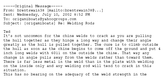

    Chine tacks crack. That is why , after the hull is pulled together, you go over them and redo them. They are temporary welds. I've seen people waste a huge amount of time trying to keep a job looking pretty while under construction. It's only the finished product which counts. None of my finished boats has ever had a chine weld crack, despite the 30 years of torture s test they have endured

    A lawyer told me that the impeccable track record of my boats in all conditions over so many decades would wipe out any lawsuit.
    One client in 1983 ,went to a shipyard with my drawings and asked for a quote for a shell for a 31. They quoted him $80,000. I built the same shell in three weeks for $3500
    Weld seams are mostly longitudina, and thus shrinkage is longitudinal ,which frames alone do nothing to control. A boat with frames and no longs can be an ugly hungry horse, something I've seen drastic examples of , and somethin longs eliminate.
    The reason you see so many frames , in smaller steel sailing craft, is strictly because of wooden boat copying tradition.

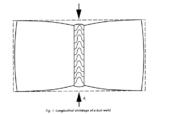

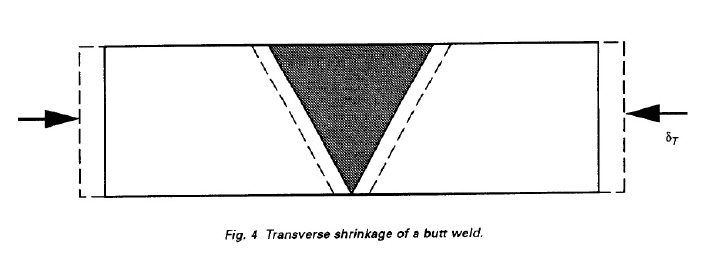

    So, after failing to answer any questions on structural analysis, welding quality and fabrication, not to mention dodgy economic reasoning to justify employing yourself, you’re now resorted to make claims on shrinkage and apply the usual very large thick brush statement.
    Firstly we need to understand what causes distortion.
    Distortion is a complex behaviour and is difficult to predict. Identical welded structures will exhibit different distortion characteristics, despite being welded in the same condition, the same welder and same procedure. Welding involves localised heating of joint edges to fuse material. This initiates non-uniform stress in the component because of expansion and contraction of the heated material. Initially, compressive stresses are created in the surrounding cold parent metal when the weld pool is formed due to the thermal expansion of the hot metal (HAZ) adjacent to the weld pool. Tensile stresses occur on cooling, as the contraction of the weld metal and the immediate heat affected zone is resisted by the bulk of the cold parent metal. It is during this tensile phase that ductile and brittle fracture crack propagation takes place. If the stresses generated from thermal expansion/contraction exceed the yield strength of the parent metal, localised plastic deformation of the metal occurs. Plastic deformation causes a permanent reduction in the component dimensions and distorts the structure.
    Ok, now we understand the basics, lets look at weld shrinkage in detail. Since you are now wishing to deviate, again.
    Here are two typical examples of weld shrinkage.
    Longitudinal shrinkage
    And
    Transverse shrinkage.
    Lets examine long.t shrinkage.
    During welding, there is a ‘yield zone’ immediately behind the weld bead which is “compressed” by the surrounding much stiffer cold parent metal plate. The compression is balanced by the tensile stresses either side of the yield zone in the rest of the plate. When the gun moves along, the same area begins to cool down, the stress pattern reverses ie tension in the yield zone and compression in the rest of the plate. If the plate cannot resist the tension, the plate will shrink longitudinally, thus straining the plate/weld and surrounding structure.
    This is very similar to long.t shrinkage. That is, the heat of the gun/welding causes the base plate to heat up and expand. At this higher temp, the weld has no strength (it is near molten) and therefore contracts under this thermal expansion expansion. There comes a certain temperature (upon cooling) where the weld metal resists the additional thermal expansion of the plate. When that occurs the thermal deformation of the plate and the contract of the weldment during cooling, causes the shrinkage.
    However, the killer two both these forms is restraint!
    Restraint opposes shrinkage during welding and reduces distortion. However, as restraint is applied the final shape is controlled, BUT a build up of internal stresses begins in the structural member. As the amount of restraint increases, the amount stress and strain in the structure or weld has to accommodate to prevent cracking, must also increase, owing to the thermal gradients which introduces strain. This causes serious structural problems.
    Brent has, again, made an assumption of how real professionally built boats (with frames), and it is incorrect.
    I wont labour on the long sequencing of welding up an entire boat, however, the plate is rolled up and offered up to the framed structure. The plate is rolled therefore the edges are free have the correct gaps and have no restraint. The only internal stresses, are those caused by rolling. If done professionally and with proper plate expansions, these stresses are very minor, if flat plate then none at all.
    So, the first structural member to be fully welded, is the plating. All the plate is welded up, in the correct sequence of course. Thus any shrinkage or distortion is in the plate and plate alone. The plate is NOT fully welded to any of the frames nor longitudinals. Therefore there is NO restraint. The edges of the plate are free to move and therefore do not impose any internal stresses owing to shrinkage/distortion. The plate takes up its own natural unstress shape. With correct weld sequencing, ie butts then seams, fwd v's aft and port v's stbd, the amount of shrinkage and distortion is minimal.
    As soon as you weld the main structure, any structure, to the hull/deck plating before the plate is fully welded, you introduce a restraint and thus, asking for serious problems, namely cracking and distortion.
