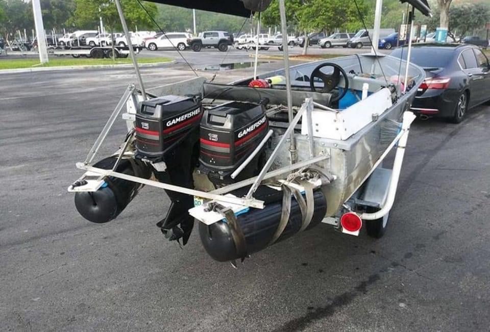

  8. kapnD
    Joined: Jan 2003
    Posts: 1,540
    Likes: 558, Points: 113, Legacy Rep: 40
    Location: hawaii, usa
    kapnD Senior Member
    bajansailor likes this.

    Re KapnD's photo - brilliant! Improvisation at it's finest. :)
