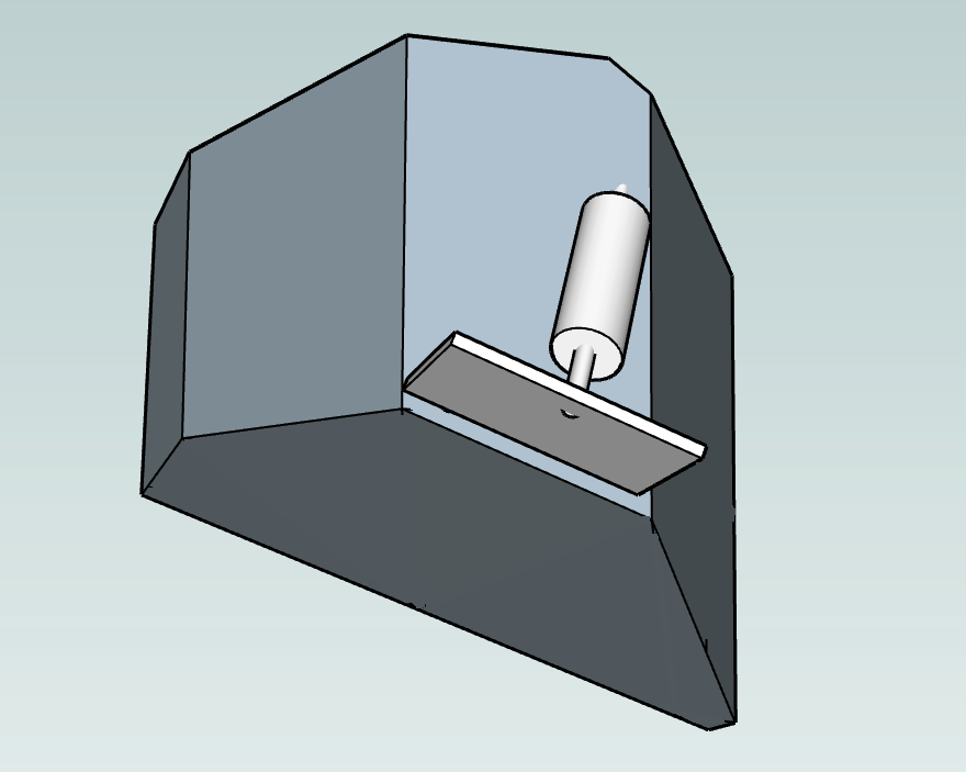

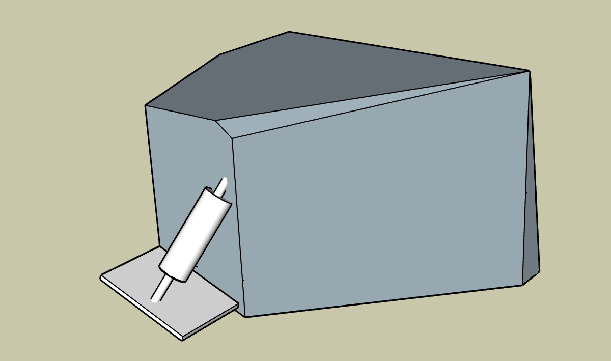

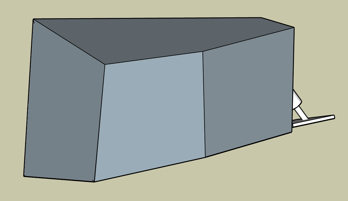

    The boat is out of the water for the season and I took some measurements of where the Pods would be. Here are a few images of what the pod would look like (port side shown).
    The pods will be mostly submerged (at rest) with about 4" exposed above the static waterline. I calculated approximately 2400 Cubic inches of submerged volume per pod (1.4 cu ft each) or 2.8 cu. ft total for both pods. The additional buoyancy from the pods would be about 170 lbs. total.
    My next steps would be to model a pod out of some foam boards to see about fit and clearances.
    EDIT: corrected my buoyancy figures.

    The additional planing surface will be about 250 sq. in per pod, or 500 sq. in. total.

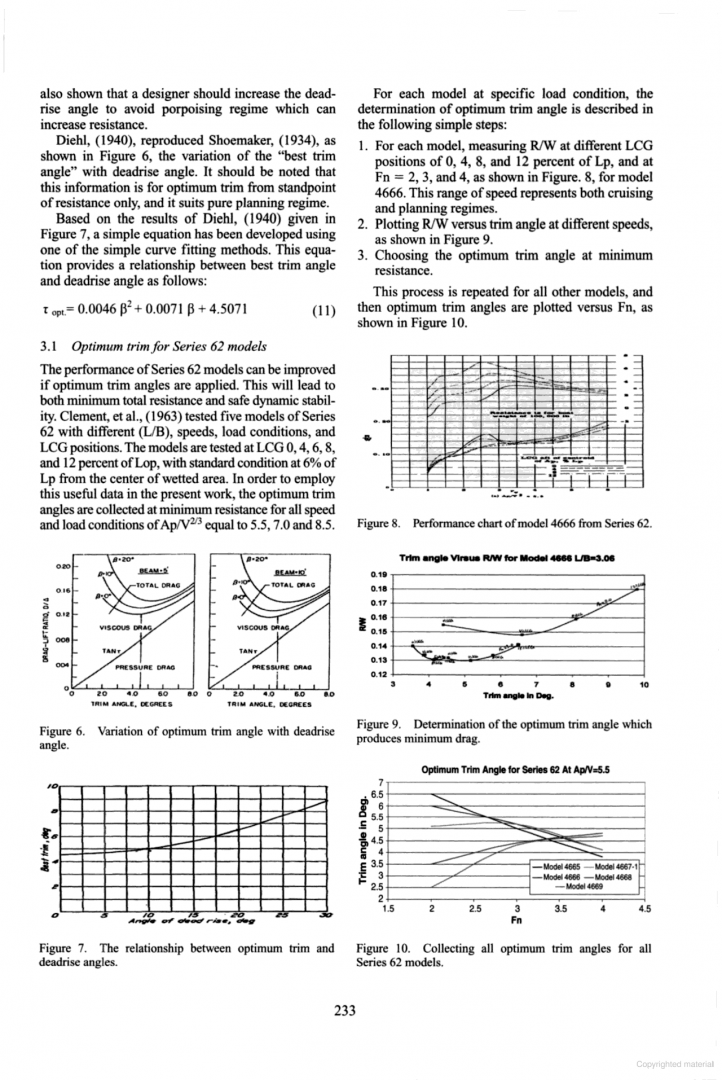

    I have included a graph from a paper Figure 7, that provides the optimum trim angle for a particular deadrise. (optimum defined as the minimum resistance for various deadrise hulls)
    If you are trying to get an "almost level" boat attitude when planing, this may not be the best fuel efficient attitude, especially if you are engaging the trim tabs at steep angles to lift the stern and adding in quite a bit of tab drag. At around 22 degrees of deadrise, you should not be surprised if the trim angle is around 6 to 7 degrees.
    tpenfield likes this.

    Interesting stuff @Barry . I figured that anything over 10˚ of trim tab deployment was going to be more drag than lift. Looks like the charts support that quesswork. My boat has a 22˚ V hull, so it looks like 7˚ of trim tab is my optimum.
    I do need to shape the pods with a bit of chamfer. . . . on the outside to clear the swim ladders on either side of the boat, and on the inside for outdrive/propeller clearance. My 'modified' design that I am working on will use the 18" x 12" trim tabs as they exist. (Still working on some sketches)

    The angle that the graph refers to is the boat attitude not the amount of trim tab deployment
    In order for the trim tab to provide maximum lift/minimum drag is to keep the stagnation line (highest pressure line) as wide (long chine to chine) as possible.
    Of course the other alternative is to provide some of the very long tabs which increase the length of the moment arm about the center of lift but they do stick out a very long way
