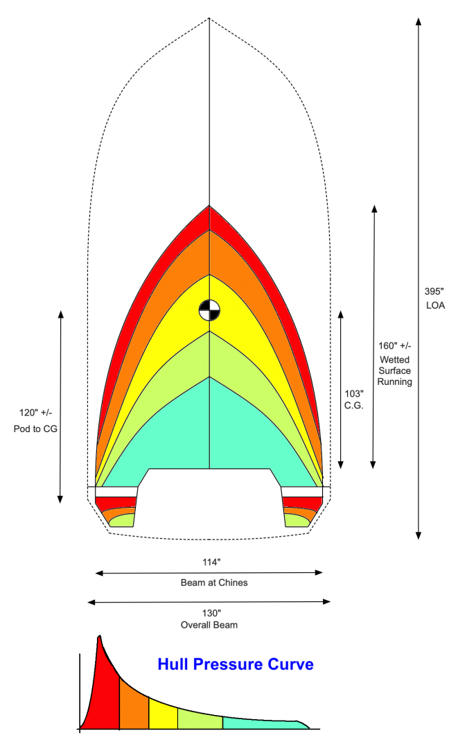

    The floatation pods will provide some lift (buoyant) depending on the amount that they are immersed when stationary. Obviously.
    This is where your calculations of available lift due to the extended pods falls down. A look at the pressure distribution on a hull bottom of a planing hull, shows that the pressure peaks at the stagnation point, (within the front 1/3 of a
    hull) and tapers back to almost atmospheric at the transom edge. (Certainly there is a bit of buoyant force here)
    So adding a pure extension will not provide much additional planing lift. ( although the addition of the pods will allow moving the trim tabs back, which will increase the moment arm from the center of lift)
    I have seen trim tabs mounted in a couple of ways. One where the bottom of the tab is coplanar to the bottom of the boat. By coplanar I mean the tabs are parallel to the hull bottom AND the leading edge of the tab is tight against the transom. When you look at the hulls pressure distribution, the tabs offers a slight increase in wetted surface but operate in an area of very low pressure.
    The second means of mounting a tab is to have the leading edge of the tab upwards of about an inch above the height of the lowest edge of the transom so that it is ventilated when planing.
    As you bring the angle down on the tab, a new stagnation point will be created. This stagnation line (the line of highest pressure) will be a "new" planing surface and provide the highest amount of lift.
    Width of the tab, or span, ie side to side.
    Keeping in mind that the tab with the second mounting configuration provides a new surface, it is optimum to increase the width as it provides the new stagnation point. Integrating the pressure curve from the front of the tab to the back of the boat provides say 200 pounds if lift ( numbers are not accurate but merely used for comparison) If you only instead add a few inches of chord (front to back) you are changing the shape of the pressure curve but do not attain the same amount of lift per square inch of wetted surface. ( for illustration, say 150 pounds) Of course if you increase the front to back measurement, the center of lift of the tab does move rearward
    Unfortunately with a high degree of deadrise, some of the lifting force is directed 21 1/2 degrees off vertical.
    If it were my boat and I could live with the static position water line, I would increase the width/span to what will fit. Attach the tabs to a position which would allow ventilation of the transom ahead of the tab, ie move the mounting hinge further up the transom.
    Looking at the back of the starboard tab, on the upper longitudinal edge, I would have a curve added in, say a couple of inches to improve the lift as the water is shedding out due to its 21 1/2 degree orientation to vertical.
    The attached graph shows the standard pressure distribution on a mono hull, as well as a stepped hull.
    The black line illustrates a very low pressure at the trailing edge of the hull.
    The red line, shows a ventilated stepped hull. With some imagination, this would illustrate my comments above. You will see the additional stagnation point and another "area under the curve" lift area.
    With the area ahead of the trim tab mounting hinge ventilated, you would get the benefit of the black line lift as well as the addition of a secondary stagnation point
    to the right of 0.0.

    I think steps at both the pod and the tabs would probably be good.
    I also wonder what the 'pressure' x 'wetted hull area' would look like? I'd assume that the pressure across the wetted area of the hull (i.e. pressure x area) and the resulting vertical component of the forces has to equal the weight of the boat and be centered at the C.G. of the boat.

    As far as the pressure curves, I'm thinking my better approach would be to have the steps in the pod and tab as shown below.
    I should get the benefit of some additional pressure at each 'step' vs. a continuous surface of hull-pod-tab.

    Another point of interest is that using the Pressure Graph the @Barry posted vs. the wetted surface area is that the area of most pressure is fairly small as compared to the area of least pressure is the largest. Red area being the highest pressure and the aqua area being the lowest pressure.
    I suppose we could calculate the pressure x area to get the center of force from planing. The illustration also assumes the pods are stepped and raked downward slightly . . .

    It is a little more complicated than that as the diagram that I posted was a pressure distribution along the keel. The is also a transverse pressure distribution with the high point close to the keel of the boat and decreasing toward atmospheric
    towards the chines.

    I did find some images of pressure distribution on traditional V hulls and stepped V hulls.
    Some of them shows the pressure a bit more pronounced along the keel as you mentioned.

    I would say that you do need to be a bit concerned because the CFD plots tend to show that the pressure at the stern isn't exactly huge.Which may mean that to generate a significant amount of lift,the pods would need to be quite large and consequently influence static trim quite a lot.

    Yes, I think in order to be reasonably effective, the pods need to be stepped and have a slight downward rake to generate more pressure/lift. Also, I think during the transition to planing, when the boat is at about 8˚ of bow lift, the pods will have their desired effect. Time will tell . . .
