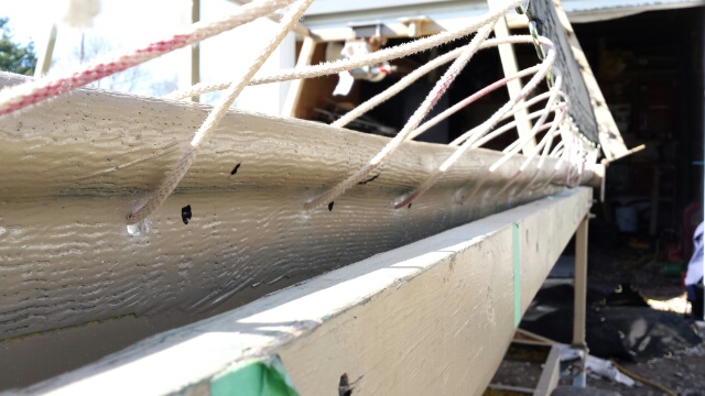

    Trampoline to Aka mounting . chaff problem.
    My sides are rigid enouph. I have a problem with prematurely chaffing my 5/16 cord on the fiberglass holes. Would a eyelet Chinese knot thing work?

    I can definitely see how chafe would be an issue there. The cord kinda needs to wrap around something smoother and bit larger in diameter. That adjacent tube might be the answer. Spectra or amsteel may help also.
