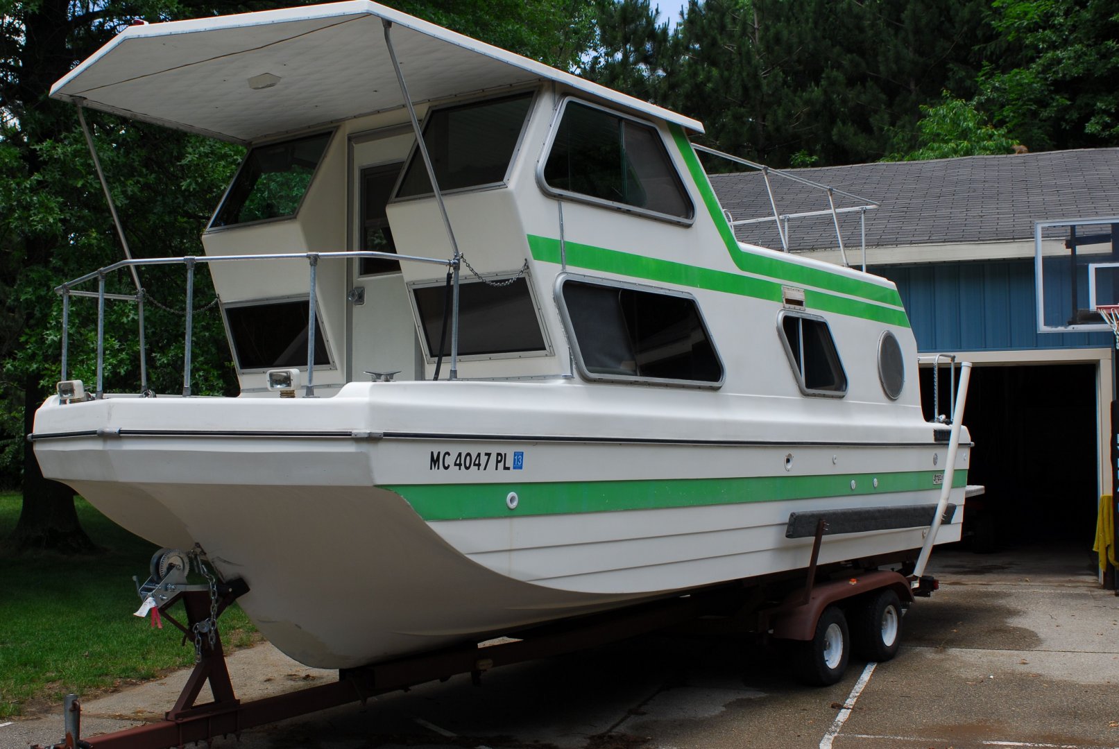

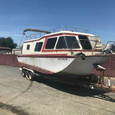

    Let me try this again. I have built 4 boats successfully and have experience. We rented a tiny houseboat a few months back it was an 18ft Hobo. Here is another example of it.
    We loved it but it was a bit small for us. We want to take this concept and stretch it maybe 4ft and 1ft wider. So around 22ft by 8.5ft.
    There are some older boats that are similar. Like the Sea Camper, Land and Sea, and Stuery boats pictured below.
    We will spend multiple days on this boat at a time. It would be trailered back to our house after each use. Longer trips are possible, and these designs have made many long range journals safely for decades, so let's get past that.
    I'm just looking for similar plans. Yes there are some old ones, but I want to use more modern materials so the old popular mechanics stuff might not work out.

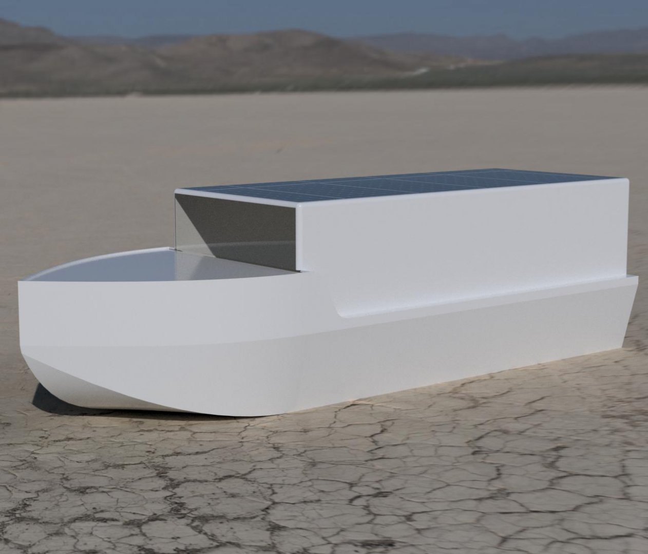

    From what I've seen a 22' boat at 10 knots needs to plane and needs something like 40 HP for 13 knots (Quest, Spira Winchester). Or 10 HP for 6 knots displacement speed (Gypsy). The GT23 says 25HP for 6 to 10 mph (5.1-8.7 knots).
    The first picture you just posted seems to be optimized for displacement speed with a smooth waterline. The last 3 seem to be optimized for planing looking at the waterline and submerged transom. My guess is they need more power and produce more wake at displacement speed. Sorry if this is wrong or obvious to any experienced boater or if this doesn't really make a big difference.
    So I think first you should nail down the hull form with how much HP and if you want optimized displacement and wake or for planing.
    From what I interpret you're looking for:
    • simple flat bottom power dory / semi dory style hull
    • planing / semi-planing at 10 knots
    • sharp V entry for choppy coastal waters
    • hull quickly turns into flat and level floor in the middle
    • designed for foam core building, developable surfaces
    • some flare to minimize wave slapping at anchor (does it?)
    When I was looking for "what is this stupid simple boat hull actually called" I didn't find this exactly, even though it seems to me (novice) as a simple to build and logical hull for a boat. At least to me it seems like it should have no huge downsides compared to the advantage of a simple to build boat and not needing a raised sole off the hull.
    There are the spira pacific dory and carolina dory and his mullet skiff which are close to this but designed for cheap lumber. All three are designed to plane with 40hp but the carolina dory seems to me a little bit more suitable for slower displacement speeds.
    You could redesign these and build these with vacuum infusion on a 22' x 4.25' vacuum table.
    Infuse the curving bow and V entry single side and the rest double side, "stitch and glue" them together. Then laminate the inside.
    Design it with "intelligent infusion" in mind so with rebates that can be glued together easily. And rebates for the interior furniture as well. Build the cabin out of cheap XPS and fiberglass. Not too sturdy but can be repaired.
    I'd consider building something like myself as a 24' trailerable house boat / tiny house but I haven't seen plans for exactly this either.
    I have finally managed to construct a V entry with a developable surface in Fusion 360! Yes small victory but it's a bit complicated to do this with parameterized sketches.
    Attached is render of the ugliest houseboat. It's 24' / 7.4m x 2.5m and completely flat after 2.4m from the bow. There are many ugly house boat designs but this one is mine haha.

    I don't think the rendering is that bad. I'd probably lower the forward deck for utility and put it in water instead of a dry lake bed.
    This would be a hand laminated Carbon Core and epoxy build, no infusion needed, but possible. I don't really want to go the stitch and glue route again, just foam strip for a more dynamic shape.
    I'm not concerned about the size of the motor, but likely wouldn't exceed 115hp for economy purposes. I have a 60hp on my boat now and it has plenty of power for what I'm looking to do. The little Hobo we rented had a 40hp on it, but really a 25hp would have been fine as it didn't do much better then 6mph.
    I realize now that a full displacement hull is not ideal in this sized boat, so I am good with semi planing or even a low hp planing hull if it comes to it.
    The Gypsy and Quest are the closest to what I'm looking for so far. I'll have to look more at Spira's plans again as the frame spacing might be close enough to accommodate foam strip.
    I'm not well versed in CAD programs. I do better with actual scale modeling, so I might go that route for a bit.
