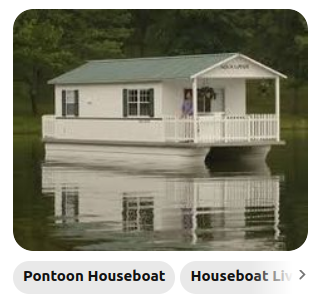

    Hi Ange, and welcome. Cyclones and croc's in FNQ were my first thoughts, then insects ! You may get away with a 40 footer on a broad pontoon setup, but a second story of steel would be pushing it, and I'd suggest wood fabrication or something else for the upper story. Shipping containers don't rust quickly because of the good paint used inside and out, but scratched, and weld burnt painted steel will start to rust, possibly out of sight. Some containers have been used to transport toxic stuff, so be sure your pick is not contaminated inside. Modular HDPE pontoons might be the most maintenance free, and you may have a supplier relatively close to you, or at least in QLD. You could see what they have been used for in many marinas, before finalising your designs. Is there a big tidal range in your creek, are the banks firm enough to anchor securely in a storm surge and cyclone ? Welding: check the duty cycle of your welder; 100% duty cycle means you can blast away all day, 50% means you will need to give it a rest regularly, any less, and its a hobby welder not suitable for big jobs. Good luck, and keep researching.
    I include my favourite micro house boat pic, I can't remember where it came from; North America somewhere I think. microhsbt5.png

    Love that photo too, super super cute !
