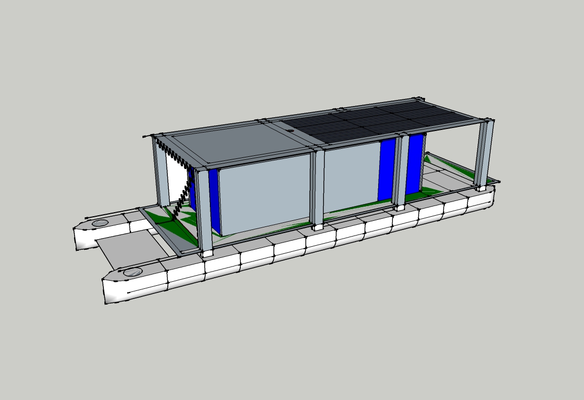

    can you load a sketchup file? if you can i can also try to add a sketchup file
  6. Captain Sunset
    Joined: Jun 2012
    Posts: 41
    Location: Belgium
    Captain Sunset Junior Member
    it took me a while to find the buttons to publish these sketches....
    but the third pontoon in the middle is my worry at the moment...
    haha .... the invisible one! should it be bigger? or the same size? smaller definitely not as i need the extra flotation capacity!

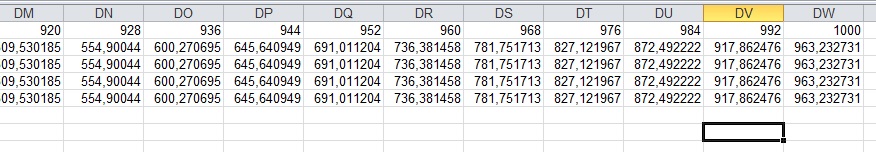

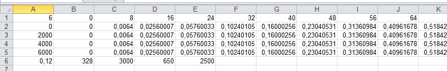

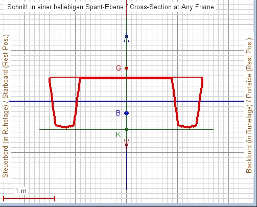

    to estimate the differences in heeling behaviour (roll) between different types of a additional pontoon in the center, it should be calculated. A few years ago I did a website, which does such kind of calculations and also displays the results graphically. There is a "2D-Boots-Rechner" which provides the calculation of GZ curves (heeling arm versus heeling angle).
    If you are interested try "www.bootsphysik.de". Button top right "English", then click link "2D-Boots-Rechner" in the top line; then button "choose/alter frames". There are two Kats, but no Tri.
    If you click the Kat it is loaded and appears at the calculation sheet. Click "righting lever curve", wait until response and click it again and so on, may be 4 or 5 times. You can load and unload masses which means to change displacement. Use buttons " i " for information.
    Ask questions, if you like. If you find the calculations useful I would "create" a trimaran (or 2 or 3 of the for comparison) if I find time for it.

    No, sorry. The 2D calculator has only an implicit length to accelerate the calculations, no trim at all (is fixed to zero). There are heel calculations possible only. If you change to the "3D-Boots-Rechner" there is trim also. But there is only one given monohull to play with.
    Regarding changes in the 2D version it is only possible to stretch or reduce the height of the chosen frame (via "choose/alter frames", buttons "Height * Factor" and other).
    If you are fit with Excel speadsheets (or similar software) you could "create" your boat/hull yourselve in an ".csv" file which I would upload. Then you can play with it online.
    Necessary is an array of numbers which represents the shape of the surface of the hull (one hull = half of the boat). It looks (2D) like the attached pics. This are simply the cartesian co-ordinates of hull surface points (all given in mm): row 1 contains the breadth (y value), column A the lenght (x value). The cell "F4", value 0,10..., means the point situated y = 32 mm from center plane and x = 4000 mm from stern has a height if 0.10 mm above the base plane. More details if you are willing to engage with the csv sheets.
    Captain Sunset likes this.
  14. Heimfried
    Joined: Apr 2015
    Posts: 382
    Likes: 61, Points: 28, Legacy Rep: 37
    Location: Berlin, Germany
    Heimfried Senior Member
    Forgot to add the pics.
    (Remark: the numbers shown are values belonging to another hull - not the Kat shown.)

  15. Captain Sunset
    Joined: Jun 2012
    Posts: 41
    Location: Belgium
    sorry, i forgot how to use excel, it is too long ago. If i had the time, i would come to learn it from you in a crash course :)
    thank you anyhow for your effort. I am still looking at making the hulls longer with two center pieces each... it would make the hulls be about 60 cm deep in the water.... Prop diameter is 30 cm, so it would be possible to fit the props behind the hulls and not have them be deeper than the hull, which is a good thing to avoid damage to the props...
    I am still figuring out how i would pull it off to get the hull from the boat without the boat being damaged, take the end piece of and insert the two new middle pieces, reinforce everything without adding too much additional hight (i try to keep a bridge clearance of 3,45m so France stays an option to travel).... it is a puzzle. but simply adding two hull pieces to each side would probably be the cheapest and perhaps best. It will be a tight fit with the weight but tight is good...
    If I would add three hull sections to each side, the boat would become over 15m length, which would cause difficulties later on if i want to travel in Germany.
    I am just thinking out loud here. I hope that is ok.
    a sketch with two hulls added... and some possible future fantasy additions like vertical wind generators or something equally cool to test. (example in this link: Vertical axis wind turbines : pics https://www.reddit.com/r/pics/comments/258a76/vertical_axis_wind_turbines/ there are other shapes of course, but judging by the thread there, they may be worth exploring for me in the future?)
