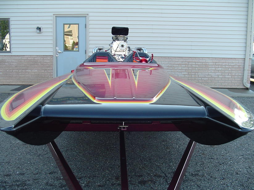

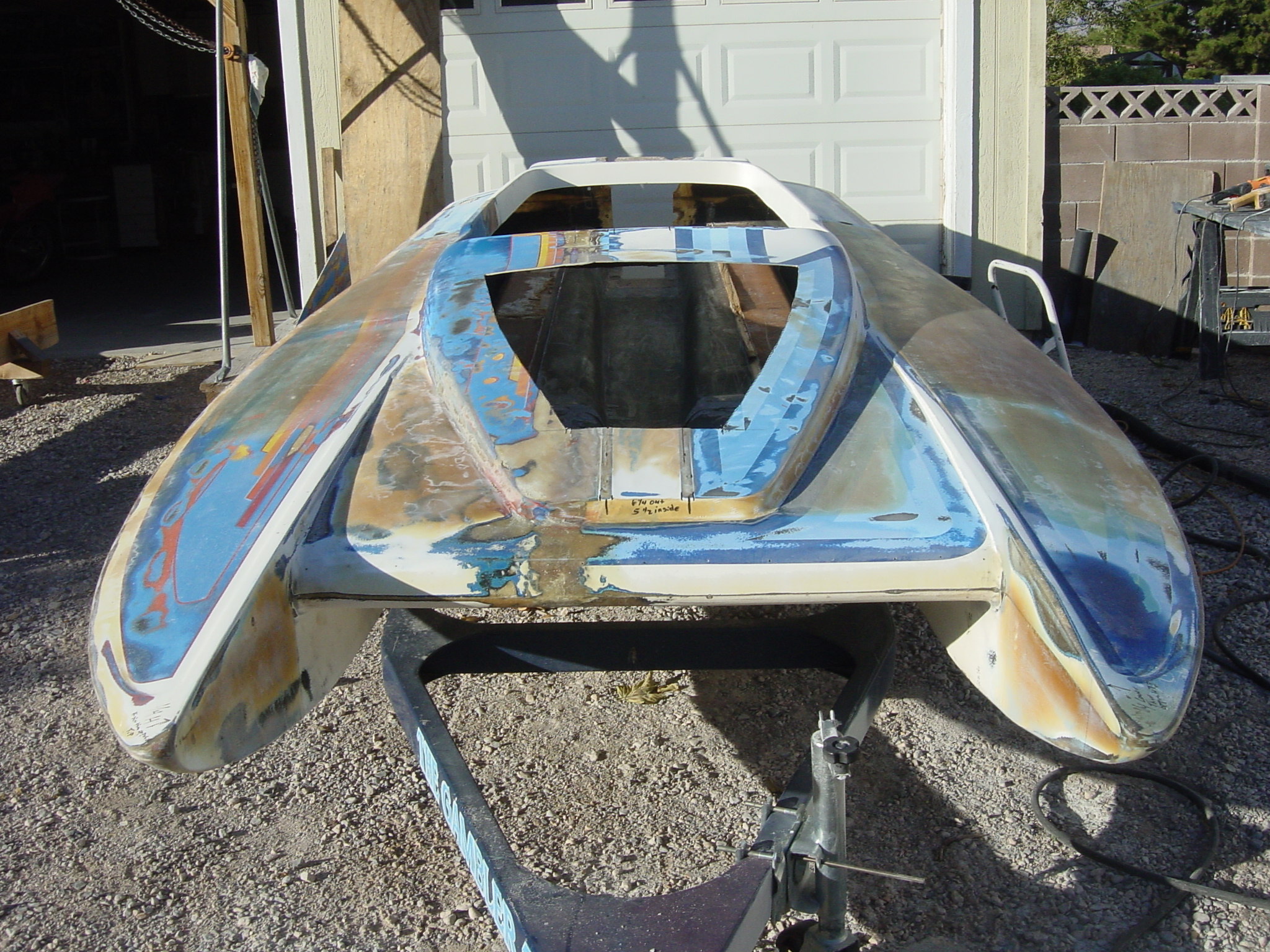

    I would like to hear opinions on the best method to go about relaminating this deck.
    Here is a picture of the deck that needs to be laid up and a picture of what it needs to look like.
    Notice the two rigglets that run up the center. I would also like to add a thnin 1/4 " piece of ply core to the under deck for stiffness, because the glass is only 1/8" thick.

    Here is a picture of a mock up of what I was going to use as a backing for the layup.
    Also while on the subject, does any one have any tips for shaping the leftside to match the right? Thanks for any help....Hal
