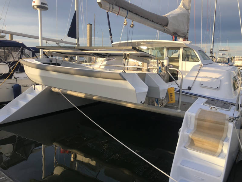

    Hi,
    I have built a Ripple Tender 13’ catamaran dinghy. I really like the boat and have a lot of people asking about the boat when I’m out cruising. I’m thinking about making a plug then a mold of a similar design and offering them for sale.
    I’d like to make the construction process as efficient as possible. Cutting out all of the foam pieces and tacking them in place is quite time consuming.
    Is it possible to thermoform the core in one or a couple of pieces on the mold?

  12. gonzo
    Joined: Aug 2002
    Posts: 15,187
    Location: Milwaukee, WI
    gonzo Senior Member
    A flat or shallow vee bottom would make a lighter boat and have shallower draft. If you are looking for the minimum weight a catamaran is not the best design.
  13. mrybas
    Joined: Jun 2017
    Posts: 33
    Likes: 0, Points: 6
    Location: East Coast or Cruising
    mrybas Junior Member
    I think it’s important to find the balance between light weight and a functional tender.
    A flat or shallow v would make it pound into the chop, no?
  14. gonzo
    Joined: Aug 2002
    Posts: 15,187
    gonzo Senior Member
    A boat that size, even a catamaran will pound into a chop. The bridge clearance on that catamaran is almost nil with three people on board
