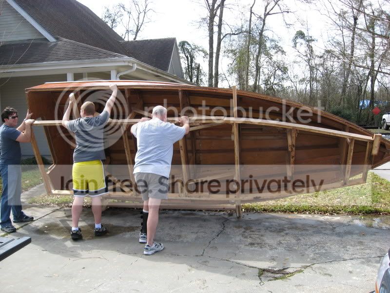

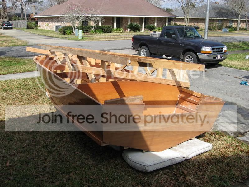

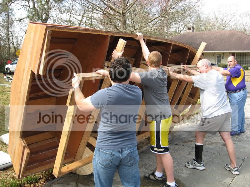

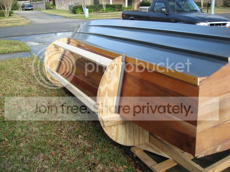

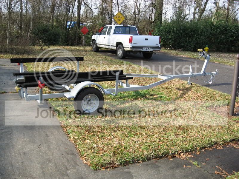

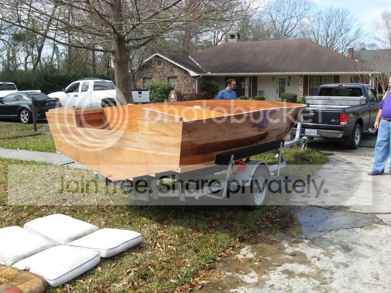

    I finally gave up the search for a used trailer that would fit my boat and purchased a new trailer yesterday. I spent a few hours last night adjusting the bunks and lured a few friends over with free beer.
    Today is the day to turn the boat over!
    Here's the trailer; $1500

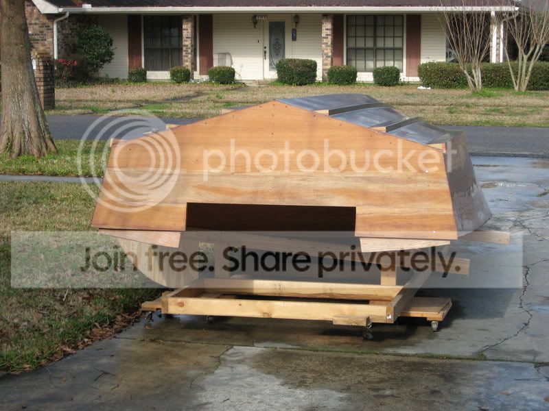

    I built a cheap and simple jig to help with the roll.
    I moved the boat, still on the building jig, close the soft grass.
    Then we lifted and rolled it on to cushions that were placed on the grass for extra protection.
    We then backed the trailer up to the bow and 6 of us simply lifted the hull and walked it forward onto the trailer
    She looks like a totally different boat when she's right side up!
    I love the lines shown in these two pictures.

    Looks really nice so far.
    Just one thing on your trailer though. If I was you I'd take it back to the guy who made it and have him put a flat bar strip from the front of the whish bone to half way between the axle and the rear of the trailer. The flat bar should stand on it's side on top of the frame on the outside. 5mm x 40mm
    Your boat is still relative light, but when the rest plus a motor gets throwed in the trailer's frame is going to work hard, especially during launches where the weight could bend the frame down towards the rear, and and metal fetique will crack the trailer frame off around the centre of the axle mount.
    The rest looks ok. I'm a rub-axle fan too. If the boat can be lowered on the trailer then do it. It lowers the centre of gravity (better roadholding) and makes a big big difference when launching. Worth the effort ;)

    Ok, here's the next thing. You may have to shift the axle a bit when the boat's done. You want about 30kg on the tow bar, so plan weight distribution on the boat.

    i do not mean to change the subject but i was wondering what kind of a coating that is on the bottom of the boat
    thanks, kayakn

    Kaykan,
    The bottom of the hull, black part, is painted with a mixture of epoxy and graphite. Everything else that you see is just clear epoxy(WEST). The topsides and deck will have several coats of clear epoxy and several coats of varnish for UV protection.
    As for the trailer, it's rated for 2000 pounds. I figure the finished hull will weigh between 600 and 700 pounds. Add 350 pounds for the motor, 120 pounds for 20 gallons of fuel, 50 pounds for a battery and another 200 pounds for anchor, life jackets, ice chest, etc. She should come in under 1500 pounds wet. Everything on the trailer is adjustable, even the axle. When she's finished, I'll get everything adjusted just right with about 100 pounds of tongue weight.

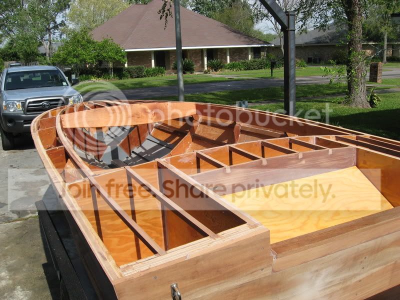

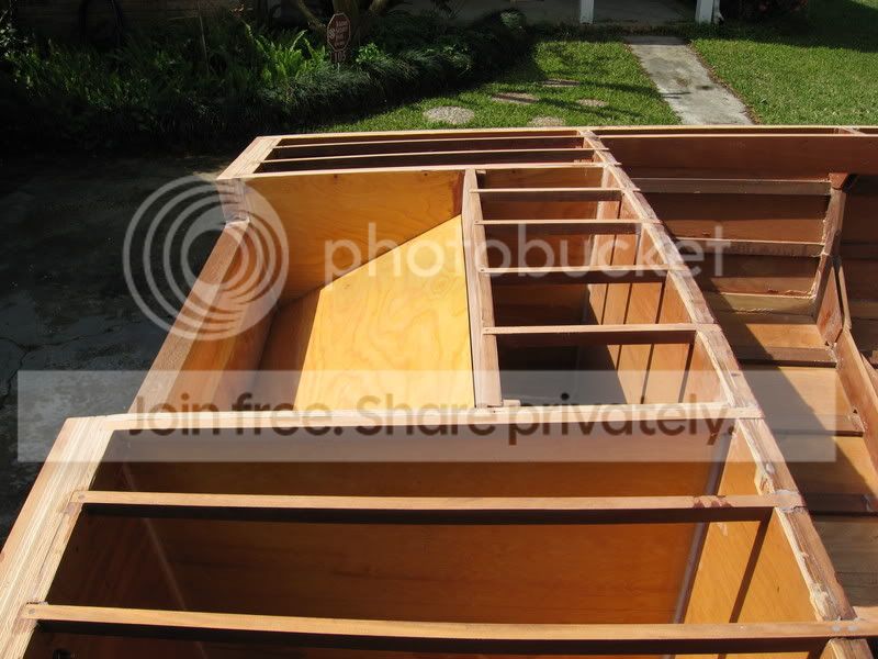

    Deck Framing complete
